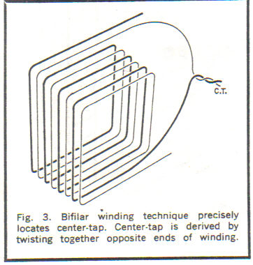

Clever way to exatly position center-tap!
found the following picture and article:
HOW TO WIND YOUR OWN AUDIO TRANSFORMERS
Luckily I have 2 reels of all magnetwire sizes I need and can wind 2 wires simultaneously
Regards
Bent
Regards
Bent

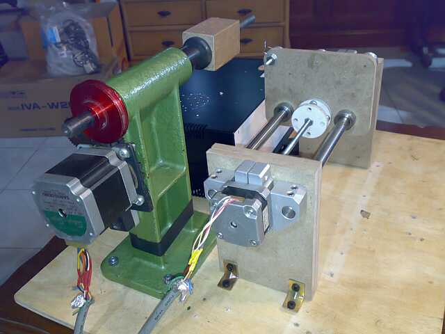

Hi Wachara!
You have some fancy equipment there! Stepper-motors and a control-card in a PC?
Regards
Bent
Regards
Bent

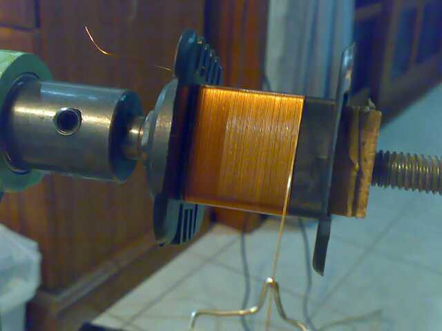

Wachara, stepper motors are a nice way to avoid the need for a turns counter 🙂
Since you use 2 motors, do you have a way to control the wire tension as it's being wound?
Hi Kavermei,
I find it a lot easier to control the tension using my fingers. 🙂
Actually I have tried a few methods, but so far I have no success with a good tensioning device yet.
Wachara C.
Wachara C.

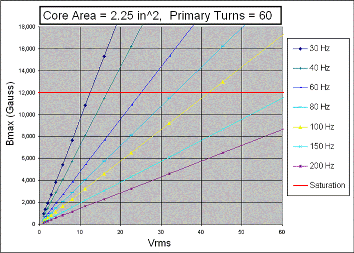

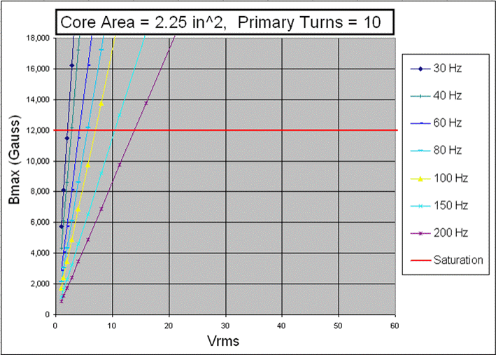

Now here's little something that allot of people don't realize is that for every doubling of frequency the power rating is doubled and vice versa. So my 200watt transformer at 60hz now becomes a 400watt transformer at 120hz and so on.
My experience is that for every doubling of frequency the power a transformer can handle before core saturation increases by a factor of 4. Looking at the formula for Peak AC flux density this makes sense because the AC flux density is proportional to applied voltage, not power; and power is proportional to voltage squared.
Bmax = E x 10^8 / (4.44 x f x N x A)
Bmax = Peak AC flux density in core (Gauss)
f = frequency
N = number of primary turns
A = core area cm^2
Note that Bmax is inversely proportional to the number of primary turns.
Typical Bmax for modern transformer iron is about 12,000 gauss at the onset of saturation
Using a core area of 2.25 in^2 (14.5 cm^2) we can calculate core saturation levels for a range of frequencies.
I chose this core size because it is a fairly typical size used for full range transformers, and is probably pretty close to the core size of your toroidal power transformer.
Looking at the plot summaries for 60 turn and 10 turn primaries, you can quickly get an idea why you can't just reduce the primary turns to get a high step up ratio. As you reduce primary turns, the onset of core saturation comes at higher frequencies and lower voltage levels.
yes ,i understand this. which is why i was shocked to get the results i got with only 10 turns .i tried to send you an email through the forum did you receive it .it described my test procedure in detail? jer
