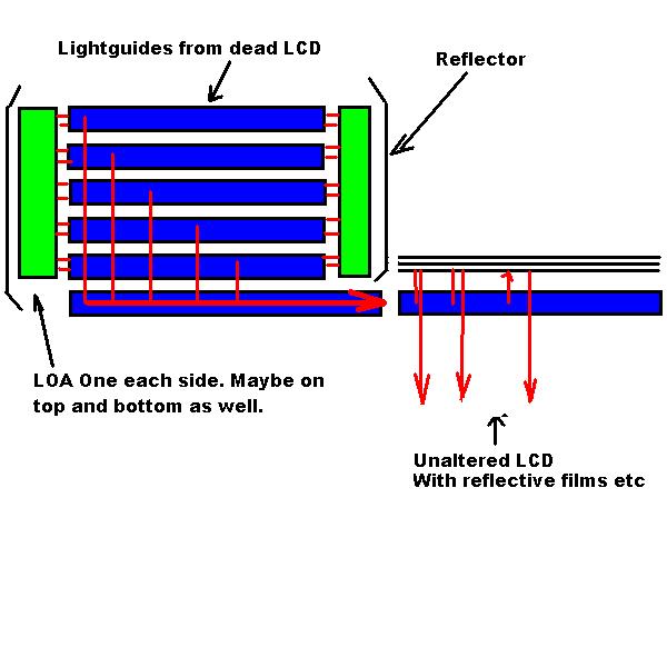

Remp, that is an amazing setup using the LOA's and the old light guides. 🙂
lol. I'm not sure if it would work or not, but just looking at it makes me think it should win a Rube Golberg design. 🙂

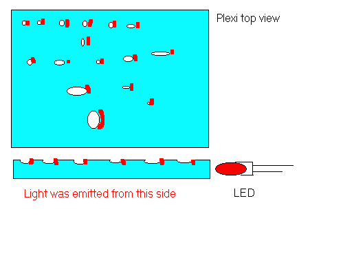

LED Plexi glass experiment
Sorry I have no Pictures
I got some 1/8 plexiglass and bought a cheap LED and board
I drilled holes in no kind of pattern just scattered, then I placed an led to the edge of the plexi glassand wala i had TIF but it was not signifigantly bright as my led and was hard to tell with red anyhow so i experiment more i placed white sheet of paper behind the glass (drilled side) and my results were closer to my led. Also the side which was closer of each drilled radius was the brightess part of the radius. so i think i need to either put LED on each side of plexi or polish the crap of them or get some kind of reflective tape or film for the sides. Or do you think spray painting all surfaces except where light goes in and light goes out.
Next may try it on window glass.
I hope communicated this well.
