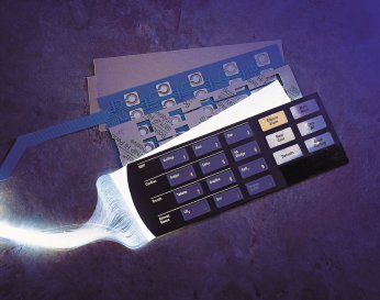

Fiber Opitc Panels (FOP's)
Hey Guys here is some of my research. Please consider the fact that I havent even opened a LCD panel yet OK.
I really think that these newer ideas of backlighting are awesome and doable.
Ok about fiber optics if you dont know already ther are really two types:
Endglow and side glow.
ENDGLOW: glows at end of fiber
SIDEGLOW: entire fiber glows
This Link is for the LCD panels and towards the bottom of the page is a how to make Fiber optic panels.
http://websearch.cs.com/redir.adp?a...nnel=cs_portal&source=CSroll&invocationType=-
As far as these FOP's Im not sure how bright a light we can do but I figure bright in bright out.
http://www.fiberopticproducts.com/danise/cart.pl?db=stuff.dat&category=fixtures

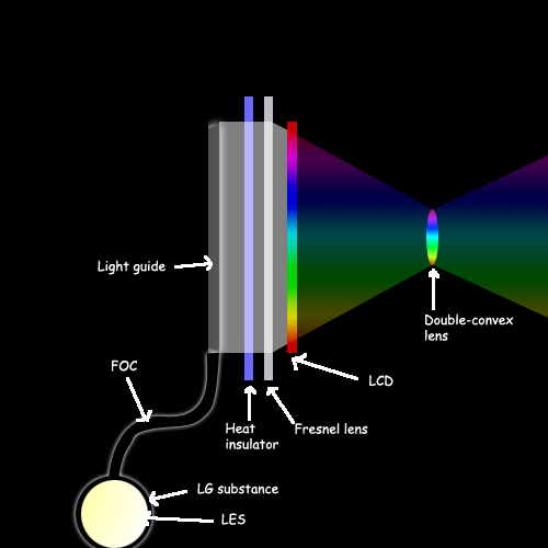

Foc's are nothing more than light guides. The panel idea is really great as the light source can be positioned anywhere due to its flexibility- kind of like wires for light. Also, I would love to get some of those side-emitting foc's, and just line them up on the top and bottom of my lcd lg,kind of imitate the CCFL's, as discussed. Still though, this would not be nearly as efficient as having the fibers fused with the lg itself, then we're talkin. It still comes down to capturing all of the light from the light source, not just how to get it through the panel. I think that's the preliminary step.
Btw, I got this lens- 01 LDX 223
Symmetric-Convex Singlet Lens - Uncoated, 100mm dia, 200mm f
I got it from ebay for 6USD, retails for 92USD apparenly at www.mellesgriot.com
the main idea in the diagram is that the foc's should be merged with the lg surronding the les and lcd-through lg. this method should also elminate the need of a heat block.

This option seems somewhat supurfluous compared to just retrofitting a standard LCD backlight... correct me if I'm wrong.
--Clint
--Clint
I think that the problem with this option is that it will be too costly... It does have potential though, depending on the cost of the fiber.
Also it is very similar to the lightguide that is already in place. Perhaps it could be used if you could use the side emitting FOC to collect the light and then transfer it to end emitting FOC and shoot that into the already existent light guide... dunno, just pulling ideas out of the air. 🙂

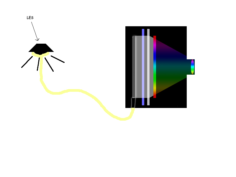

FOC is feasible
I think that using fiber optic cable is an amazing idea, and is well worth a try since it's inexpesive. You can get something like 30m for 40USD on ebay, and that's not even a deal! Just cut it up into equal sects of as long as you need with regard to the location of your les(light emitting src.) and implant them around the lcd lg- kinda like small led's surrounding the lg. It would be even better simply to do as I suggested in the prior post, whereby they are simply used in transferring the light from the lg surrounding the bulb, and into the lg supplying the light for the lcd. Since they are essentially ultra flexible lg's, we can place the light source anywhere.
Kinda off the wall, but imagine making a diy pj with an external les!! the idea is like that of an elctrical outlet, but we need a light source in this case-
oops
the heatlock would not be needed- forgot to remve it from the diagram(blue)
also, i emailed a firm deling in FO and asked for some samples- dunno what will happen, but it's better to get for free where possible in order to experiment.
Also, on those side-emitting foc's, you can make that out of any foc- just strip the cladding (responsible or tir) where u need to leak light

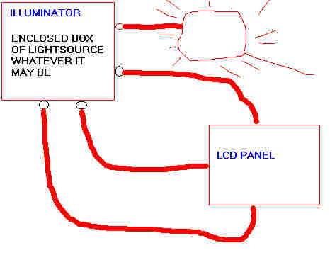

The one and only reason I have suggested a 400 watt Metal Halide as the light source is because powering up a backlight is unknown territory. No one really knows if it will suceed or not. It should do. The manufacturers put in one or two CCFL and that works very well for a person looking at their laptop so all we are doing is increasing the light so we can project. The Metal Halide is a proven light source for projection. So if you have one already you can adapt it, and if you dont have one and buy one it will not be a loss because it will work straight through if the backlight idea is no good. Personally I think it definitely has good possibilities for success and would be a good step forward.
Three reasons.
(1) Lighting via the backlight rather than straight through means you can buy a LCD monitor and dont have to modify it which is a major plus.
(2) Using the more advanced polarization recycling gear which is commonly used in backlight system which can under good circumstances mean either a brighter picture, or drop down to a lower wattage bulb.
(3) Opens the door to a variety of new lighting possibilities such as a bunch of LED's, Multiple CCFL or other type of Fluorescent, or a cool low wattage light source we have not thought about.
Before going straight into item three there is advantages to prove that this backlight system will work with conventional Metal Halide, collimating lens and cylindrical lens. Both lenses being not too expensive and guys will nose these out at bedrock prices.
Only needs one person to do it.
Could be Zardoz. I know he is busy at the moment but he has the gear and I know he is very enthusiastic.
