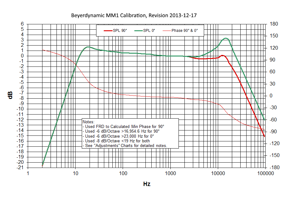

A 1/4" microphone capsule will pretty much have a minimum-phase response in the whole frequency range of interest, so you can actually get it from the magnitude response alone.
This is not easy to do down low using automated methods, as you would need a magnitude response that goes much lower than 10Hz to actually be able to calculate phase response down to that frequency.

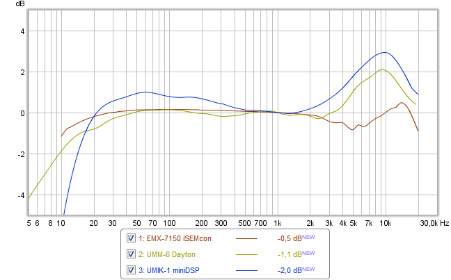

I used it to retrieve phase information on my cross-spectrum (Herb) calibrated Dayton mic which was missing phase information.
You simply load the magnitude correction file, hide phase info (if any), inverse it, and then work your way through (minimum-phase) EQs to get it flat, as well as (minimum-phase) filters to model the high pass behavior (which is the critical part).
jmbee also did it and published a detailed description of the process (cannot find the link at the moment, not sure it was on this forum).
It work, and it also let you "rub out" some strange deviations in the correction response that look more like measurement/calibration process artifacts that real capsule behavior.

The SPL response is different for different mic orientations. The phase response is the same no matter the mic orientation. I believe I read in an old B&K mic information document that the mic phase is the minimum phase of the mic's pressure response. The mic pressure response is typically close to the mic 90° SPL response rather than the 0° response.
Assuming I remember this correctly, it is best to use the 90° SPL response for the phase calculation.

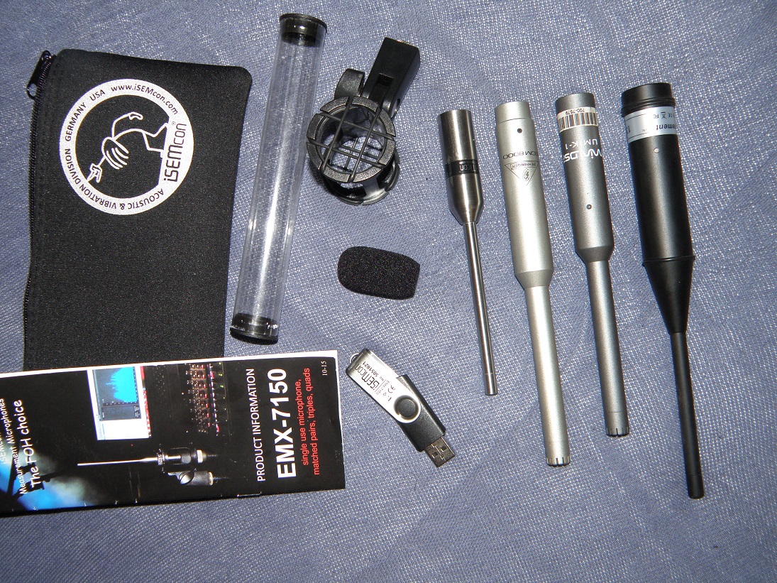

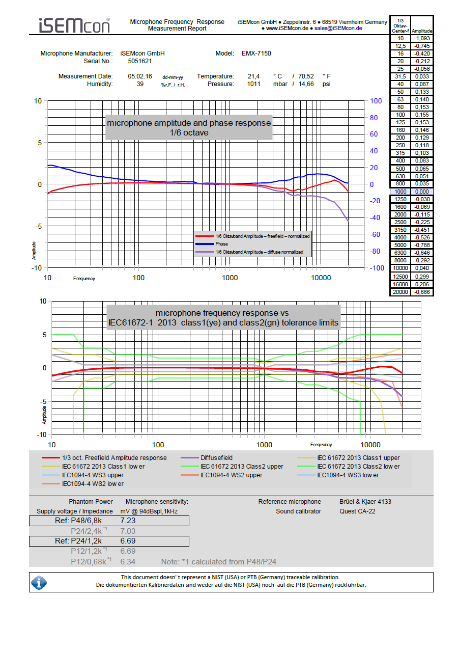

In case it wasn't mentioned, or I overlooked it, ISECmon does offer a measurement mic that specifies its phase response and distortion limit: http://www.isemcon.com/datasheets/EMX7150-US-r04.pdf
Thanks had one of those about a year ago because verse USB types wanted the better timing reference possibilityes but it hasn't any build in phase response settings into correction file, thereby wonder if phase is into wesayso's ECM8000 correction file from same company.
That said its nice product and useful accessories as seen to the left in picture below and also raw response is better than UMM-6 and UMIK-1.
Yes, mine is a calibrated ECM8000 from iSEMcon with phase correction table included.
At that time I got a CD, not a fancy USB stick like yours 🙂.
Got it somewhere in 2013 when I was still building my speakers, I also have a ECM8000
mic without calibration, never used which I bought in 2011. I wanted something I could
trust and looked into my options (and wallet). This one fit the bill.

Thanks feedback wesayso think i drop them a message into subject, and yes they had different kits and to have the shockmount adapter included CD was exchanged with that fancy USB stick. There is note included for calibration process verse the B&K 4133 reference and that note have phase curve plotted but the freefield and diffuse calibration files have none phase data included.
I asked Wolfgang for the diffuse field data for a calibrated mic I bought from him several years ago, as it did not come with that data at time of purchase. He was very helpful in getting it to me. Maybe you could ask for the phase data for your mic...
I was thinking of taking some speaker distortion measurements and the EMX7150 was the only mic I could find that has a distortion spec.
The only other mic I hear about is the Earthworks M series: Measurement Microphones I have asked support for both distortion and phase specs, but no reply yet. Their page on phase: Phase

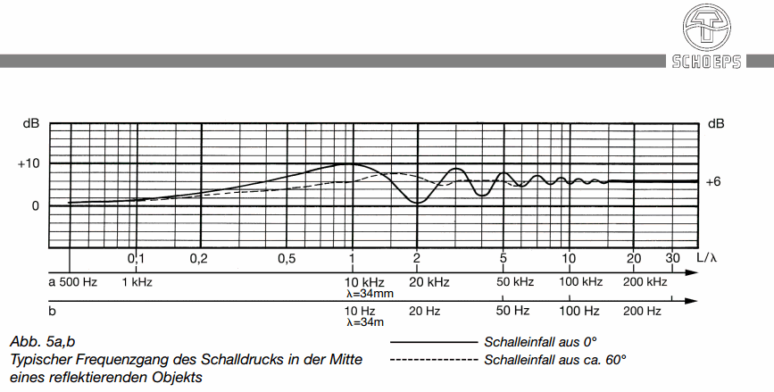

See attached plot from a Schoeps document, Joerg Wuttke's "Microphone Essays" (the most reputable source you might find on microphones), showing reponse rise of a point receicer at the center of a disc, exactly how typical electret capsule construction look like. EDIT: it's not a disc, it's a square, but response pattern aren't too different.
