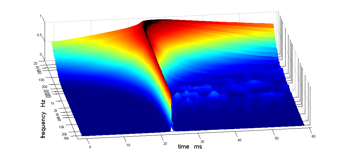

When speaking this software can't resist show work from other night using Raimonds auto EQ to form two pass bands that are within 1/8 wave lenght for SPH-250KE and 10F/8424 because is bit impressed myself and REW confirm the nice data showing me cleanest waterfall ever had, maybe at first it looks even better but this is mono speaker at 90 cm distance with mic middle way between drivers and wesayso's is superior to this in its both channels and at listening position.
