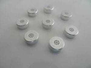

Here's a pic of some Primo capsules. If you realize the diaphragm is behind the array of holes and the entire assembly is permanently sealed by rolling the edge over a small round PC board on the back the problem becomes apparent. The array of holes is crucial in tuning the response of the cavity between the front and the diaphragm inside. I ground off the back of a similar one, there is a backplate with the gate of a FET butt welded to it the drain and source come out the back into the PC board, a plastic spacer ring, and then a metal ring supporting the diaphragm. I measured the thickness of the spacer and the diameter of the exposed diaphragm and it computed exactly 10pF from the capacitance equation. Inside there is a round plastic former that holds everything in place which is pressed into the outside housing to tightly control all the critical spacings. IMO opening or removing the front to place an actuator would totally change the high frequency response.
EDIT - I assumed in my case the diaphragm was simply a metalized plastic and the backplate had a teflon coating that carried the built-in polarization charge.
EDIT - IIRC there are numerous mod articles around that enlarge/modify the front of ECM's to change their frequency characteristics.
That explains a lot. The Primo capsules are very good. I was thinking of the Panasonic capsules WM-7? (discontinued) which I believe have an exposed diaphragm. Gras also said for measurements above 40 KHz you need to remove the grid. That's always risky but may explain why I was have such trouble getting good measurements above 40 KHz on a Panasonic ribbon tweeter. I need to try again.

The Linkwitz mod frees the housing so you can make a source follower out of it, unfortunately I think the diaphragm and case are electrically connected by the metal ring that acts as a spacer for the front cavity. You can OTOH now use the diaphragm as an input coupling cap if you can think of anything this is useful for.
The Panasonic WM series has one small port in the front, I assume that changing the diffraction around or near this port would affect the phase enough to make a good cal impossible.
The holes are acoustic resistances so some claim removing the front and equalizing the mic flat again can remove a few dB of noise.
EDIT - You could try a needle as a point source of charge right at the port input, probably would need a lot of volts AC on it.
