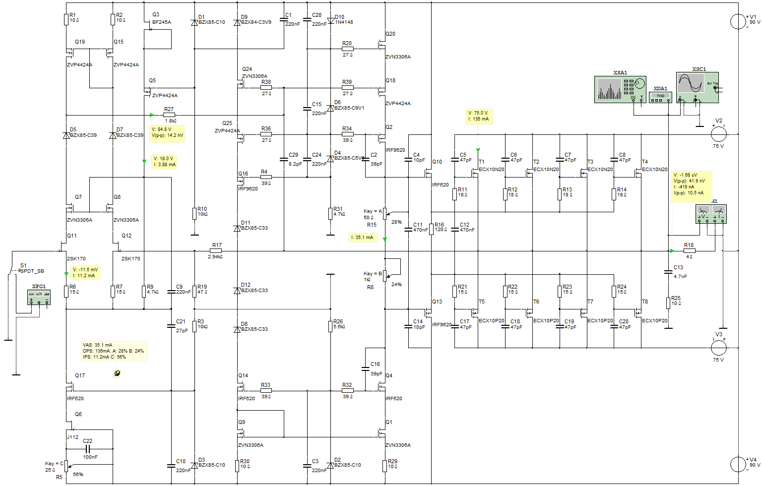

Well, here's the schematic 🙂 The wire connecting dots are there, although not very clear. It's too bad I can't set them to be bigger in multisim.
It may look complex, but in reality it's very simple, I may draw a simplified operational diagram.
It's a big sized picture so take your time to glance over 🙂
the sim'ns not so easy without the device models - care to post?
but a few quick questions:
what are C21,22 doing
why not Zener ref for input cascode bootstrap
how much current in the driver Q - the 120 Ohm R16 makes me think its a little low
I'll extract and post the models in a little while, although the ECX models I got from this very forum. I'll include them for completeness though.
C21 is the local feedback for Q17, it's mainly to mute any parasitic oscillation of Q17.
C22 is a bypass as you would place an electrolitic cap along a zener to get a cleaner voltage. Q6 with variable R5 forms the adjustable LTP current. C22 together with cascode Q17 protects Q6 from being modulated by the amp input. It's a highly steady currentsource this way.
I could replace R9 with a zener yes, but the rest of that current channel that is about 4mA wouldn't be changed; the idea here was to use a currentsource as input for the input cascode, allowing it to be referenced against the input JFET sources while maintaining good PSRR. As for the choice resistor vs zener it probably wouldn't matter in this particular location I suppose.
The OPS drivers Q10, Q13 run about 11.7mA bias, the needed voltage drop across the resistor really doesn't need to be high as the ECX' start conducting as early as 0.1V, so yeah I can imagine it gives the impression that a much larger current would be present 🙂
I forgot to mention that a few caps need an electrolytic parallelled, I omitted them in the sim to avoid the long time constants, but C22 needs a 10uF, C9 about 10uF as well, C1, C28, C15, C24 and all the other zener voltage regulators also. C11 and C12 need around 220u and 470u respectively.
Spice models of all FETs used attached to this post
