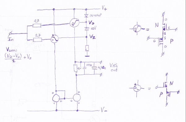

VAS operation
The first image is a picture of how the VAS works. It's actually pretty straight forward. The VAS rail has a top and bottom section. The bottom section is mirrored. This creates two current paths that can be controlled. you'll see that the input controls both current valves. The valves are opposite in action. Since they're differential, the other inputs are tied to a fixed reference. This actually is a nice perc as the valves need to be biassed to set the idle VAS current. The bias voltage between the two 'grounded' valve inputs determines the quiescent current. This can be adjusted by a trimmer if greater accuracy is wanted. The current valves drawn in the schematic are made of a complementairy pair with the sources tied to each other. They can be easily recognized in the original schematic 🙂
The huge benefit of this way of controlling the VAS current is that the cut-off behaviour of the valves is much better than VAS gain devices referenced against the supply rail (sources tied to supply rails). This is because the reference is now set at a much lower voltage. This means, that at higher frequencies when more swing appears on the IPS output, that the VAS input will still not clip and can accomodate the higher input swing. This greatly helps with transient response and squarewave performance as the IPS output swing excursion can get quite big. Under normal operation eventhough the valves consist of an N and P fet, they're still class A biassed.
A more elaborate version would mirror the top part of the VAS much like the bottom part and have the mirrored part run to GND. Then, the valve is to be placed in this leg. Because that leg is not responsible for the output swing, the valve can be referenced at any voltage, and thus referenced at the voltage halfway the maximum swing excursion range of the IPS output which lies between Vsat of the top mirror and Vsat of the cascode with maximum positive swing input. This version had slightly better THD numbers, most likely because both the top and bottom end of the VAS were fully symmetric.
Anyways, that's just my way of thinking.. 🙂 I'm curious about downscaling the amp and see what numbers I would end up with at much lower watts lol

VAS operation
