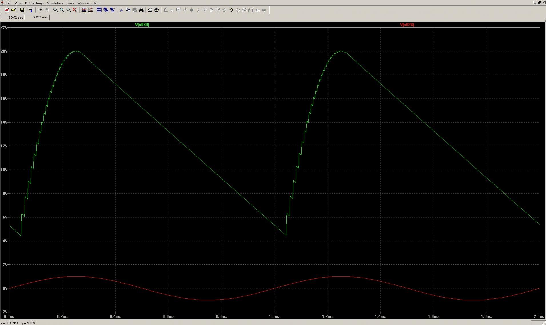

I could not get my LTspice simulation of this circuit working. It does not converge. I've checked everything twice, even tried different models, but nothing works. Perhaps it is all those subcircuit models. The nodes must number in the hundreds.
Could you set your transient simulation to start from zero, rather than first calculating the DC operating point? If so, then it should work better, you can start taking THD samples about 5ms into the simulation, I use a time window of 10ms - 10ms + time of 4 periods.
I've seen problems with convergence with high gain circuits - MOSFETs can give "infinite" DC gain
and ideal current sources can drive nodes to kV when things go wrong
sometimes explicit power supply ramping helps - define the PS Vsources as PWL with ms ramp time from 0
limit any ideal source with series R, clamp diodes - a quick limited, "passive" ccs can be made with high Vsource and high value series R

That's not what its supposed to look like. It's a shame i'm not versed in LTspice at all so I am not of much help trying to get it to work for you.
An update will be pending soon 🙂 I made a few more changes to the schematic. The VAS is now using a fixed reference cascode - I needed the bandwidth more than the reduction in phase shift at its Fc which was the benefit of the topology I initially described. The double cascode in the IPS is gone too - now it's just one cascode; zeners will take care of the additional voltage drop. All ideal current sources are gone and have been filled in by discretes; the IPS CCS is adjustable to optimize JFET bias currents. Output power is now rated 500W RMS into 4Ohms.
