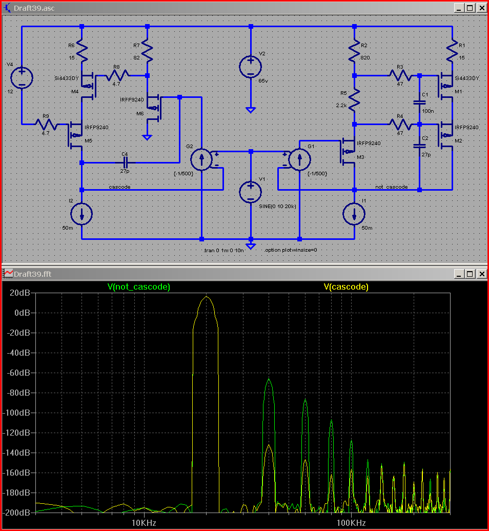

I've looked at the paper as well - it's indeed the exact mechanism I'm using in the IPS. The VAS is differently though.
the VAS is effectively not a Cascode
if you're already using higher V input stage supply why not make it enough higher for the Vds > 2x Vt condition that greatly reduces the Mosfet's parasitic C nonlinearity
Then what do you think it is? Could it be called quasi-cascode? After all, the topology certainly shares attributes with that of a classical cascode, notably that it keeps Vds of the upper FET stable under normal operating conditions. It may be noteworthy that the lower FET is actually bias'ed such way that the upper FET is not saturated, in the schematic it has about 4V across drain/source. When the input increases (lower voltage) the 'cascode' can't deliver any more current than the upper FET would allow. All the drive is doing is 'help' the lower FET to accomodate the increase in current by the upper FET whose Vds is now even more stable since the source of the lower FET isn't modulating as much as if it would be driven from a fixed reference. But I agree, it's not a classical cascode, yet it exhibits behaviour of one.
As for the Vds > 2xVth, the supply already accomodates for that condition - at least, for the IRF; not the upper transistor.

an illustration of the potential performance difference of actually using buffered cascode VAS topology vs the OP' circuit
the models are chosen from Ltspice included parts - may not be the greatest but I used the same in the 2 circuits compared below
changing topology, passives, bias, the circuit on the left is actually operating as a buffered cascoded VAS as explained in Cordell's, Self's books
the right "not_cascode" circuit is the OP's VAS (green fft)
the cascode gives ~ 60 dB lower distortion (yellow fft trace)
the comparison isn't fully debugged, RF stability not compared - the only point I'm trying to show is that "proper" cascode operation is easily distinguished

just showing the VAS in isolation - nonlinear output stage driver load Z will be a limit, if the VAS CCS were capable of performing at this level
what is really wanted is more audio frequency loop gain - which the buffered cascode can also deliver - then 2-pole compensation can cut all amplifier stage's distortion thru increased audio frequency global feedback
also note that my comparison is 20 kHz distrotion - Bob's favorite "simple metric"
a number of amp designs today can manage few 10's to single digit ppm distortion numbers at 1 kHz

Nice work jcx. I have to admit that I have changed the topology just a little more; the 100nF cap now bypasses the 2K7 resistor directly, not 'after' the individual gate stoppers which I had increased to 100Ohm.
In the circuit the topology performs better than either a single transistor or the fixed ref cascode. I'll try some comparissons as well, although it's not my main intent which is to complete this design.
P.S. THD20 is my favourite as well, if it works there, it will work at THD1 certainly. For THD1 I achieved numbers in the 10...100 ppb range with this schematic.
Could it be that this VAS structure sort of cancels the harmonics generated in the VAS CCS at the bottom? That would be one explanation.

Jcx, its exactly what the OP circuit does, not only does it lower the miller effect (less so than conventional cascode) but it it increases loop gain considerably and its the main reason it performs so well. Simulations with this circuit is awkward as the subthreshold region in mosfet models are hideous and I personally wouldnt even try simulation interpretation. Using a similar setup Im able to improve vas performance to near the same league of using a buffered hawksford cascoded bjt vas without all the stabilty hiccups. Parts selection is very important.
