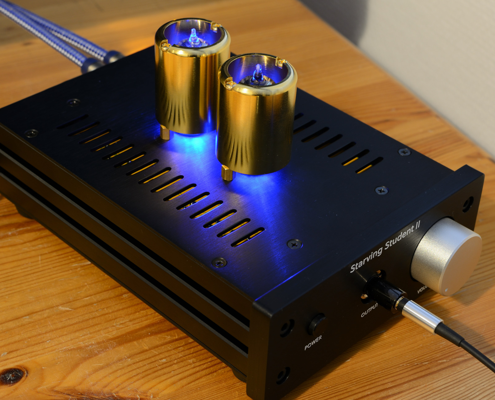

The shields are made by Yamamoto. They use the shields for their phono preamp. Shields are gold plated bronze (4mm solid bronze). It is non-magnetic and it shields both electrical and magnetic according to Jac van de Walle from JacMusic where I got the shields from.
After this project the Student is a bit more Starving! ….it is a good name for an amp using golden shields!
It looks better live than on picture.

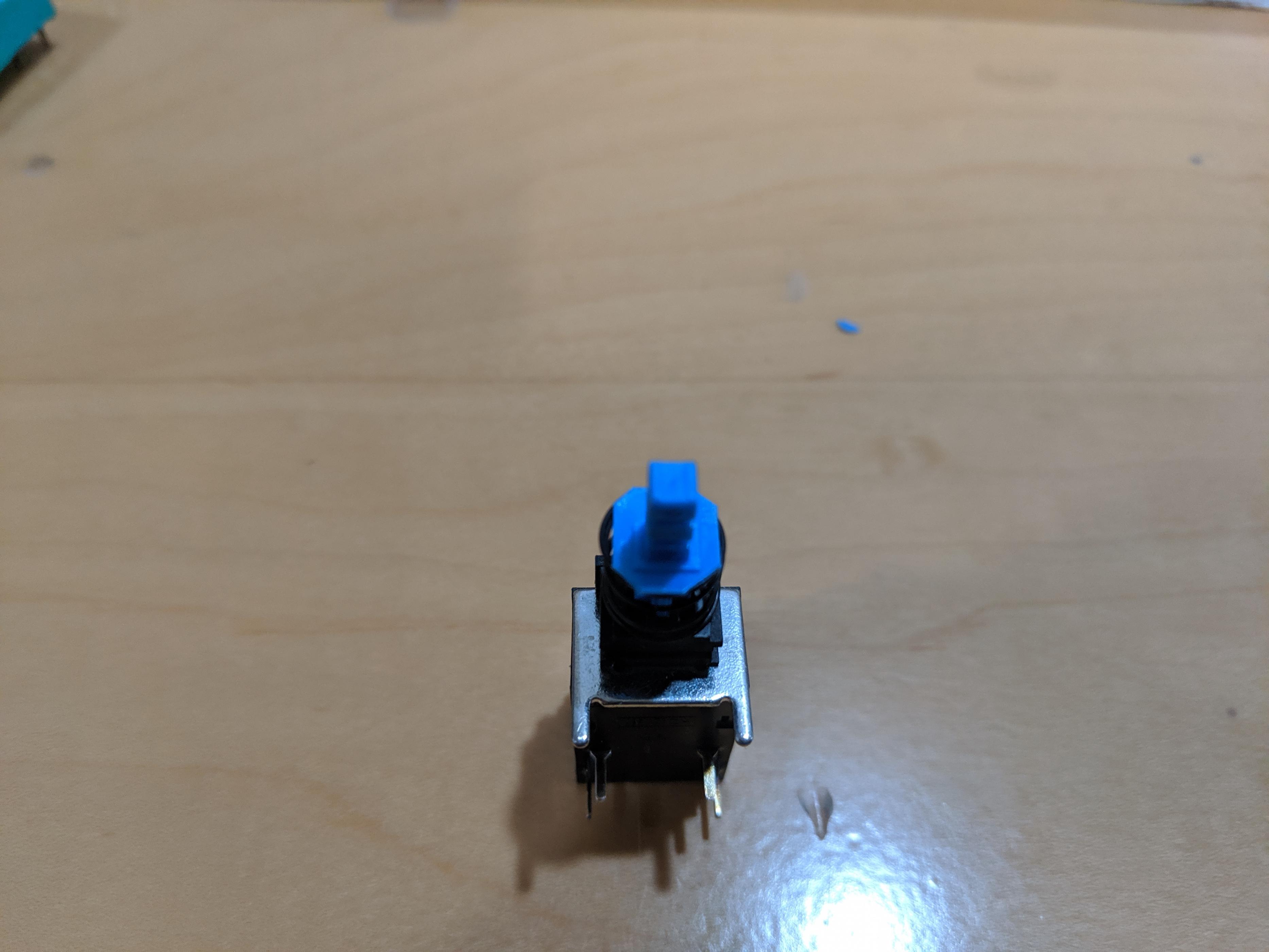

The only issue I have is with the enclosure: the front plate does not seem to work with the power switch included in the kit. Based on the pictures in the online assembly instructions by Pete Millet and 6L6, this switch is slightly different from the one used in the past; it functions fine, fits the PCB fine, but it has a plastic piece at the base of the plastic pushbutton that doesn't clear the front plate of the enclosure. When the plate is on tight, it doesn't allow the switch to fully extend. I will either need to ream out the front plate (which I definitely DON'T want to do), or I'll have to track down a different on/off switch. Right now, I'm forced to use the enclosure without the front plate.

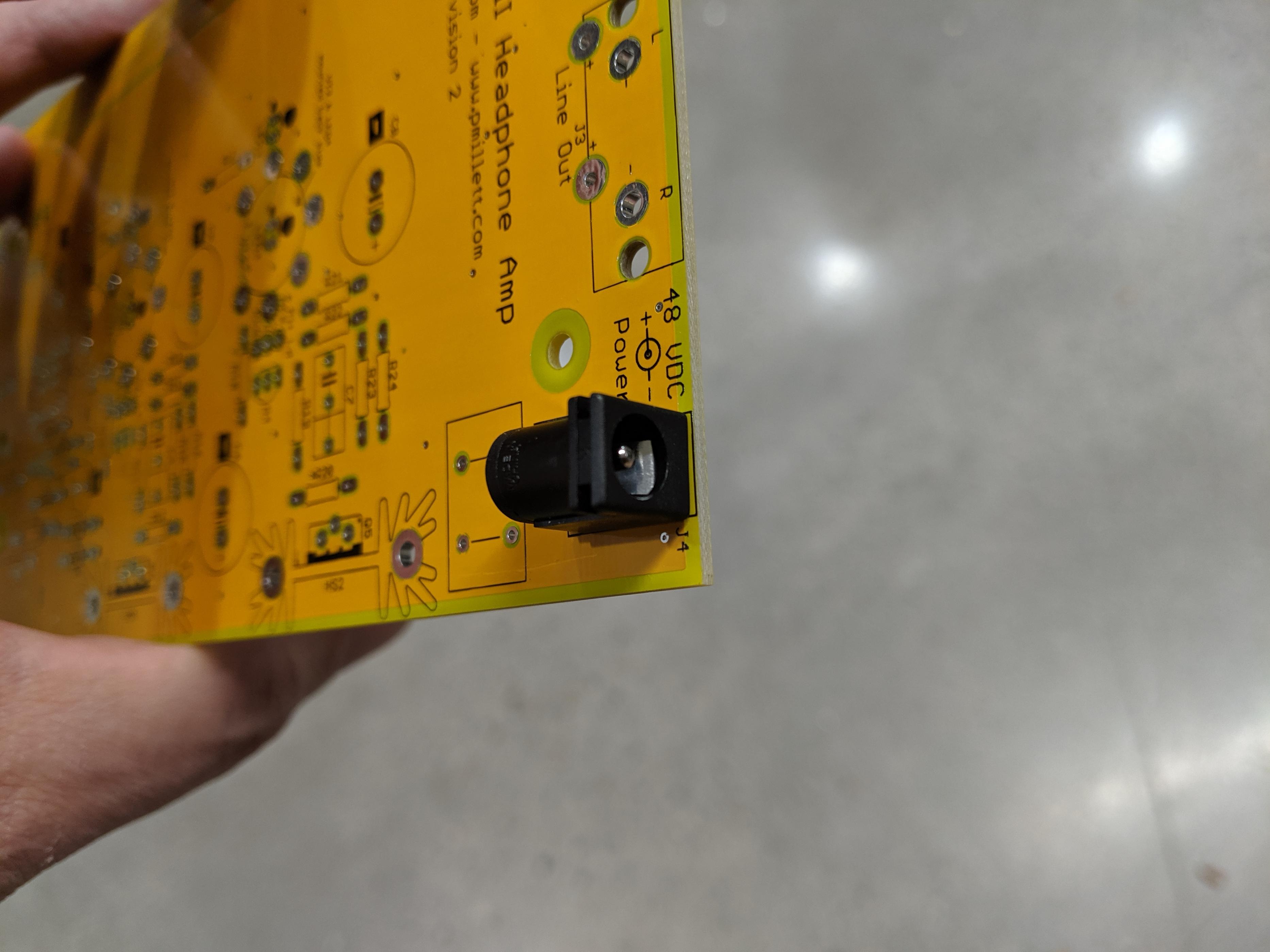

As far as I can tell, my problem is not a case of misalignment but a lack of compatibility with the power switch and the enclosure. Has anyone else had this problem? Does anyone have a solution? Do the folks at DIY Audio know that this power switch may be an issue, and do they have a solution? Or am I simply incompetent?

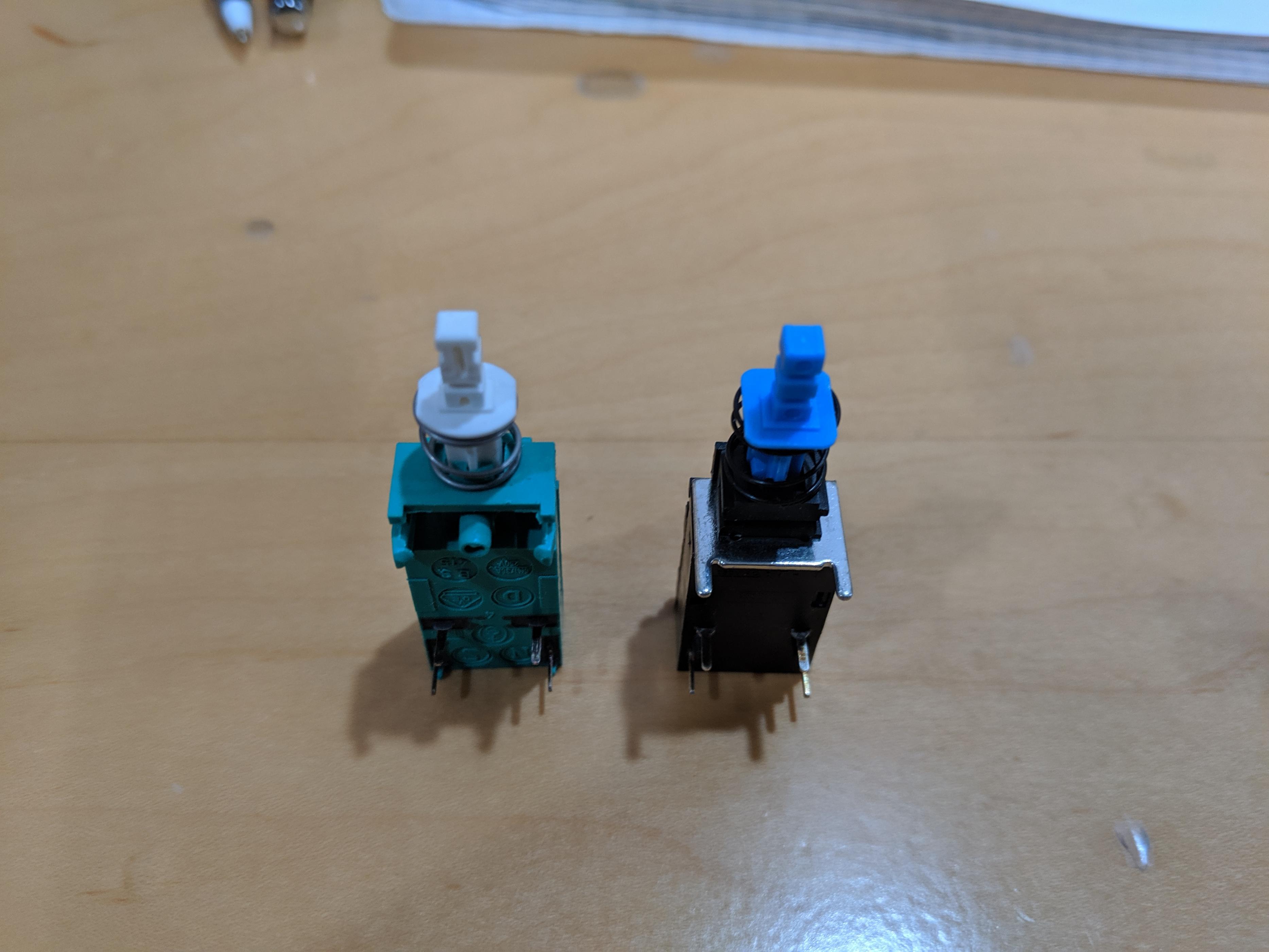

On the power switch... yes, there are two styles of switch. All but the first batch shipped with the black one (first photo). The issue is that the black one has a larger plate in front of the spring - it's square and not rounded. So it can hang up on the hole in the front panel, especially if the switch isn't soldered perfectly straight into the PCB. Make sure the switch is pushed all the way down into the PCB. You can help matters by clipping the corners off of the blue plastic plate with a pair of wire cutters, as shown in the second photo. You need to be careful to not cut too much, or the spring will escape...
It also helps to put a chamfer (countersink) on the inside of the panel (Actually, I though we did that...) A debur tool works great, but you can use a countersink, sandpaper, or even a knife to break the sharp edge on the inside of the hole.
On the power jack - I haven't seen a problem there. Are you sure it's soldered straight into the PCB? Sometimes the part might be a bit loose in the PCB holes, and it can move around while or before soldering.

Thanks for the quick response! So, I trimmed the edges of the blue plastic plate that holds the spring, and it still didn't clear the panel. I trimmed a little more, and the problem remained, but there is now barely enough plastic left to hold the spring in place. It's compromised, but it hasn't completely self-destructed, and I suppose I could super glue the spring in place if it doesn't hold.
After all that trimming, I still had the problem with the blue plastic piece not clearing the back of the front plate, so I made a chamfer. It took some filing and working with a dremel before I figured out the best solution, which was to use a very large drill bit I had and drill a bigger hole partway into the back of the plate. This, finally, allowed the blue plastic bit to stop bumping against the back of the plate, and now the switch works, as long as the spring stays where it should. If others have the same problem, my recommendation is that you simply use a large drill bit to put in a countersink which will clear the switch.
By the way, I also have a problem on the back plate. I can get everything to line up, but the back plate is so thick it keeps the power supply plug from going all the way into the jack. At this point, having spent far more frustrating hours trying to make the enclosure work than it took to build the amp itself, I am simply going to use it without the back plate.

We don't want anyone to have to have any trouble with this, so we'll be shipping replacement power switches free of charge to everyone who got one of these new ones with the square tab.
The helpdesk will be in touch within 24 hours to confirm your preferred shipping address.

Correct Switch.
Jason: received the replacement switch yesterday, well packaged and earlier than expected. Thank you.
