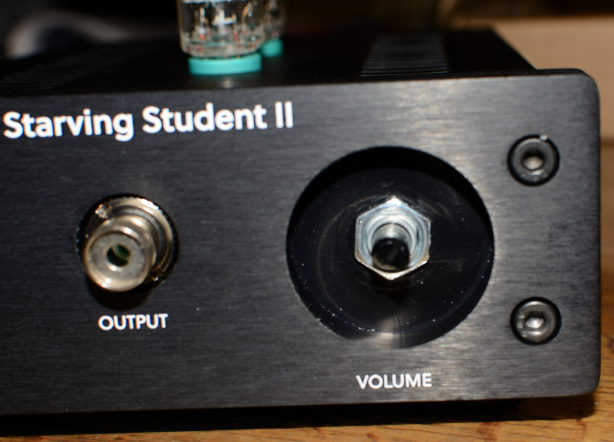

I finished my Staving Student and it is playing music! I use CCS setting to begin with. Before inserting tubes I measured at pin 3 on tube sockets and there was exactly 19.0 VDC.
I have an issue with hum. With Vol. turned down and no input hum gets worse if my hands comes close to the tubes. If I touch chassis it gets worse but if I touch Gnd on either input or output RCAs hum is almost gone. So it must be a grounding issue. Is chassis floating or where is the signal Gnd to chassis supposed to be?
Is it the nut on the vol. pot that makes the gnd to chassis?
I noticed that the cutouts in the front panel is black but 6L6s was pure aluminium so he may get a better galvanic connection.
If I turn up the vol to about middle the hum change from a buzz hum to a more clean not so loud hum and at max vol. it is back to a buzz hum sound.
At vol. set to about 9 o'clock it plays quite loud. My DAC probably has large output. Probably 2Vpp or more.
If I make a connection using a wire (just by hand) from a chassis screw to the gnd of one of the RCA output......it is silent. So now I just have to find out where the "official" Gnd to chassis should be?
I tested using a DMM the connection from the pot nut to chassis and there is no connection. Pot nut has connection to Gnd so I am quite sure if I scrap off the black "paint" or find a shim which can cut through the black layer the hum is gone……..

I was able to get electrical contact between pot nut and chassis and this reduced the hum a bit and hum is not dependent of vol setting anymore. But I have still a bit of hum. If I lay hands on chassis and wrap my hands around the tubes without touching them hum is gone so I guess the tubes pick up some hum?

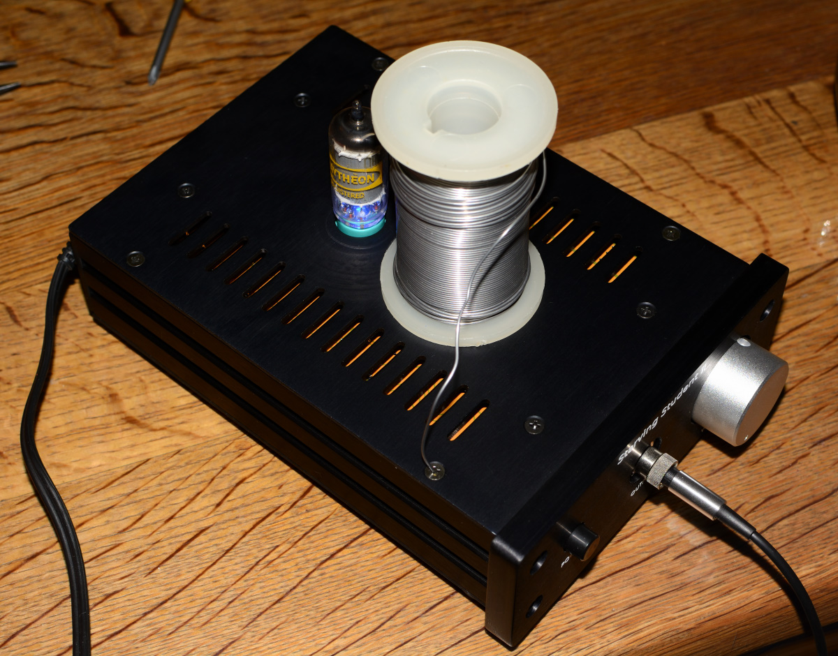

I tried to screen one of the tubes and that made it almost silent in both channels. But only if I connect the end of the solder to be chassis. If I screened both tubes like you sometimes see in old tube amps it may make it 100% silent. Seems there is something very high impedance capacitive coupling from the surroundings (eg from my hands)?

The plate circuit of the tube is a very high impedance node, especially when using the CCS. So it is susceptible to picking up environmental noise. You are a big antenna, so bringing your hand near the tube couples line voltage noise into the plates.
I think you figured out that the pot frame is connected to ground. The issue with black anodize is that it is non conductive, so to get good contact you may have to remove some of the anodizing around the volume control shaft.

Thank you for the answer. Yes, I removed some of the black "layer" and got electrical contact to the pot. I will experiment a bit more with grounding and also change from CCS to resistor to check this out. A shield around the tubes could also help.

I switched from CCS to resistor and in this mode hum is only in one channel (in CCS mode I also think hum was much worse in one channel). It follows the tube. If I switch tubes hum also switch channel. So some tubes seems to be more sensitive for picking up hum than others? I think I may prefer this mode for playback. But I may also "hunt" for a shielding solution of the tubes.

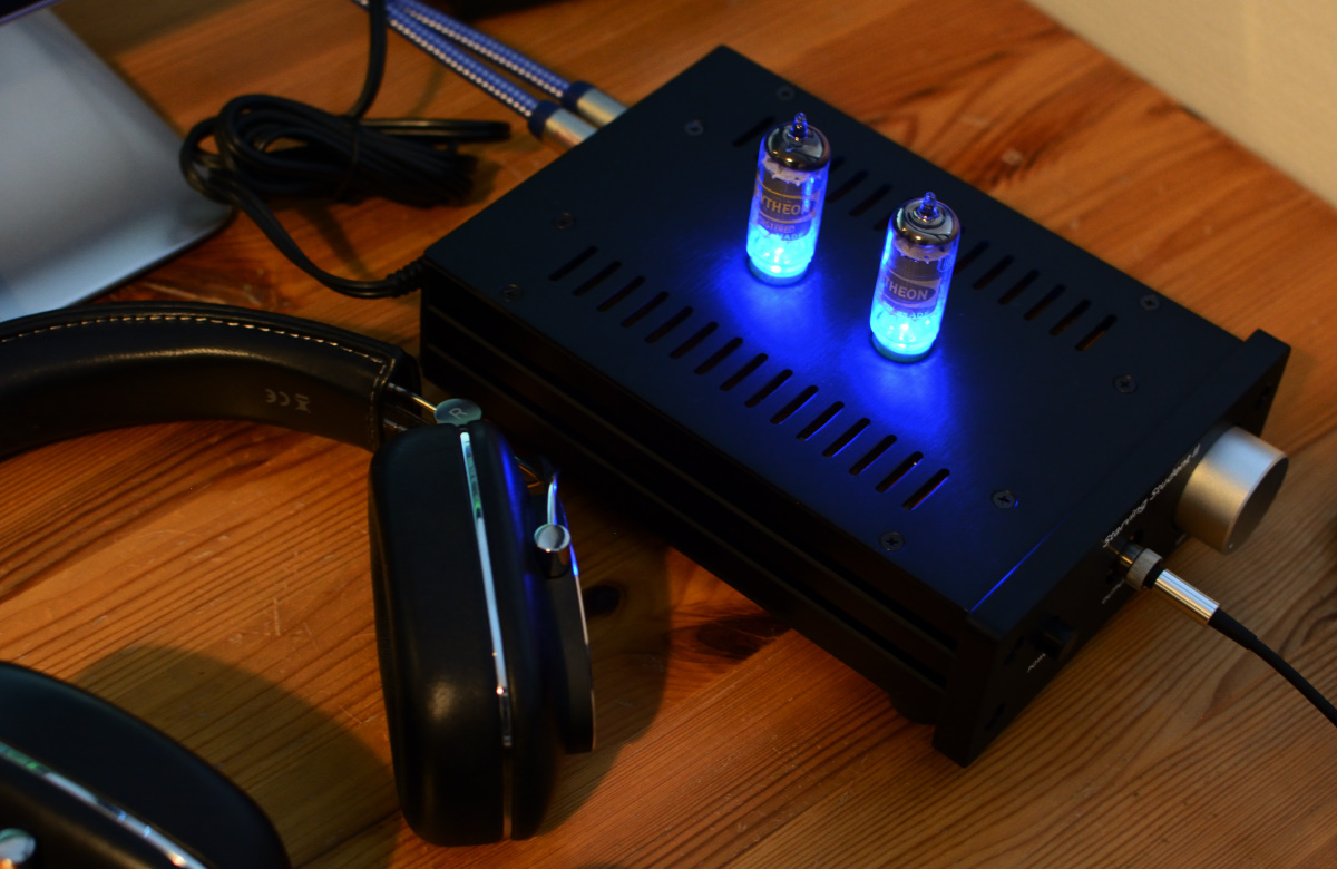

The sound is very good from this amplifier used as headphone amp. The subjective impression is that bass seems deeper than when I use the Phone output on my DAC. I found shields from my "local" store in Germany. Think it will look good when installed. Will post pictures and results when installed. It only requires two M3 holes for each shield. For now I use my "solder roll" on the humming tube. 60/40 solder.....have not tried using solder with silver 🙂
