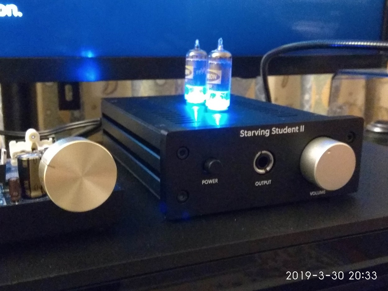

Looks like I have to go back to the bench - a few oddities after a day of use: 1) Noticed that the turn on delay doesn't (hear a pop when first powered on - then about 10 min into listening, everything goes quiet for 10-15 sec). 2) Had one channel go completely silent (suspect an issue around one of the tubes).
I suspect some solder joint issues. Hard to actually see issues on inspection, so will trace out the circuit to find out where they are.
Spent some time tracing out the circuit - no problems found. Reflowed a few suspect solder joints & all the tube socket connections.
Appears to be working perfectly now.

I managed to build one today. Some of the pads on the pcb are
quite small so it would have been easier if I had thinner solder on hand.
Also it took a bit of effort for me to put the tubes in.
I'm currently trying it as a preamp after listing to its headphone
output for a couple hours. I encountered one minor issue. I
toughed the volume know and I felt a bit of static and both channels
went silent. Perhaps the relay was somehow triggered. Anyway,
after turning off and on, it is behaving ok again.

I had some issues building mine - I was using a very (very) old soldering iron with a suspect tip - I think some of the solder joints on the small pads (especially the ones connected to ground) were not good. I picked up a new soldering station (moved to the modern world) & carefully reflowed all of the solder joints - everything is fine now.

I just got my SSII kit built and testing it now. There is a problem with the input. Plugging in either the right or left RCA connector from source gives me output to both left and right headphone out. Plugging in the other (either left or right) RCA input lead I get the hollow remains of the input source. Wondering if anyone is reporting a similar issue. Source is phase correct and works correctly with my other systems. Headphones also working correctly with other sources.

Problems like this are often an open ground connection on the volume control. Try reflowing those pins.

What am I doing wrong?
I'm at step 20 - smoke test.
VT1 pin3 to headphone ground measures 43.3 volts.
VT3 pin3 to headphone ground measures 19.05 volts.
My soldering looks very clean and solid (no bridges or cold joints) so I'm guessing I have a defective or wrong part somewhere.

The most likely error is that the grounded end of R11 isn't really soldered to ground. It's easy to get a solder joint that looks good, but actually has not flowed onto the grounded pad. It's connected to a large copper area that sinks heat away, so it is difficult to solder.
If this happens, the gate of Q3 is biased to 48V, so the source (and VT1 pin 3) goes to 48V - Vgs(th) or about 43V.
With power off, use an ohmeter to confirm that R11 is 200k, and R15 is 221k. And measure from the grounded end of R11 (on the resistor lead) to ground to see if it is connected.
Also check for solder bridges on Q3.
