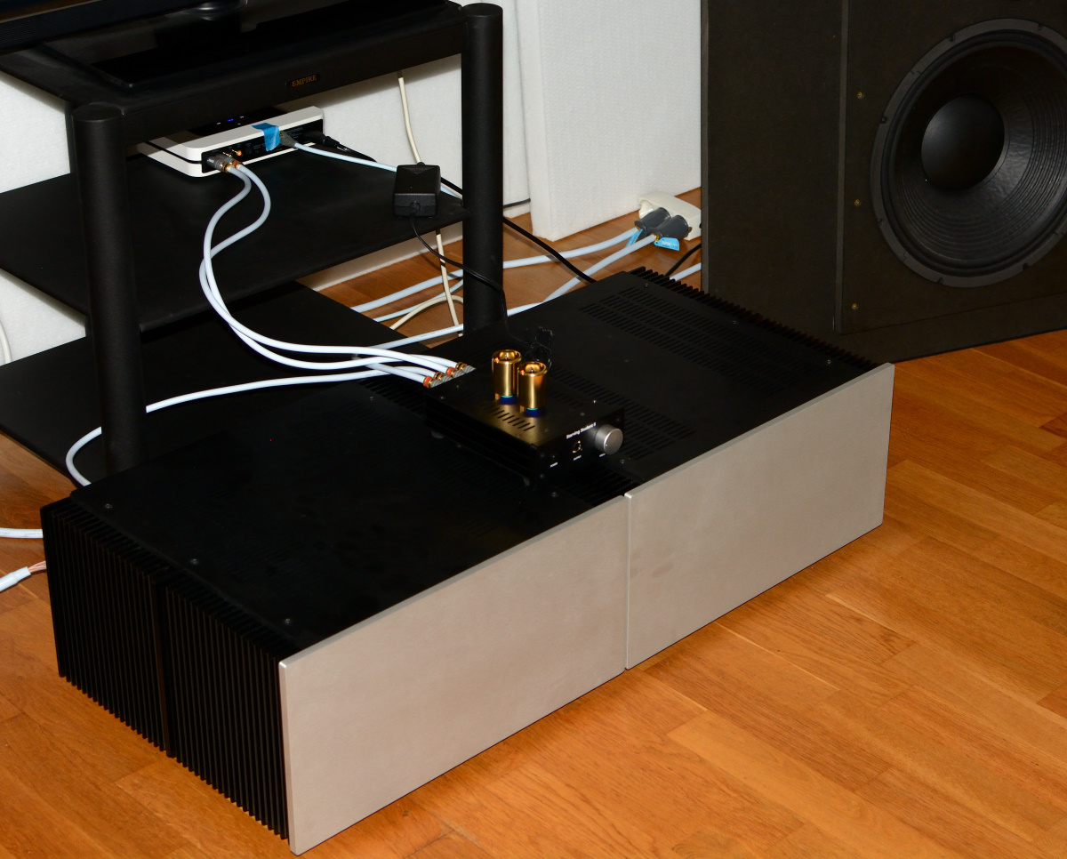

I experienced a "funny" issue. I have built two Starving Students so I have two 48 VDC PSU's. I was using one of the SS's as preamp for M2X amplifiers. Then after a while I could hear a weak "sizzling" sound (when no music was playing). I found out that the sound came from the two tubes. I let it cool down and started up again. During warm-up there was no sound but again after a while the sound was there. Then I switched PSU and problem gone. Next step would be to measure the 48 VDC ripple noise with oscilloscope but I think I will just go for another PSU. As I have no Earth (safety ground) in the outlets I can use a PSU without.

By the way…..it plays very nice as preamp. Very listen friendly. I feel I have better/deeper bas as when I just used a passive preamp. Also have a feeling that the dynamics and 3D imaging is better.
