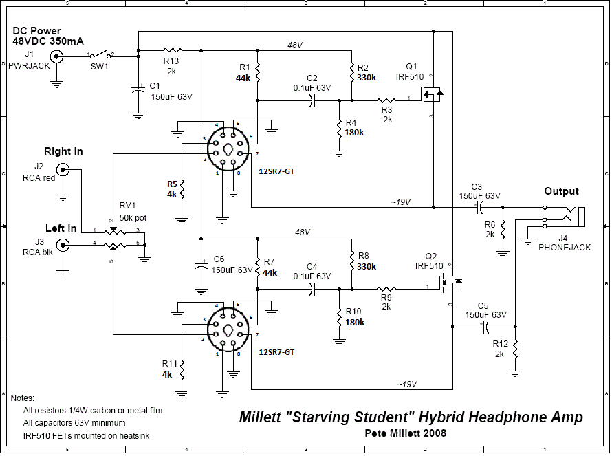

I recently built the first Starving Student Amp, but replaced the 19J6 tubes with 12SR7. Changed the resistor values and the pin layout for it as well, according to a thread I found. However, when I plug it in, the right side doesn't work, the left side experiences a constant loud noise and it crackles when I move it. The tubes and heatsinks get hot and music plays fine.
I've redone most of the joints already, but that didn't help. I don't have a tube socket however, and I'm sceptical of the solder joints there. Is there a better way of soldering tubes that doesn't require a socket? I kinda don't want to order one from china, shipping would take ages.
I'm also currently not using a metal enclosure and I've wired everything pretty much point to point. I've also connected the power ground as well as the audio ground together to the ground pin on the power jack. Could that be a problem?

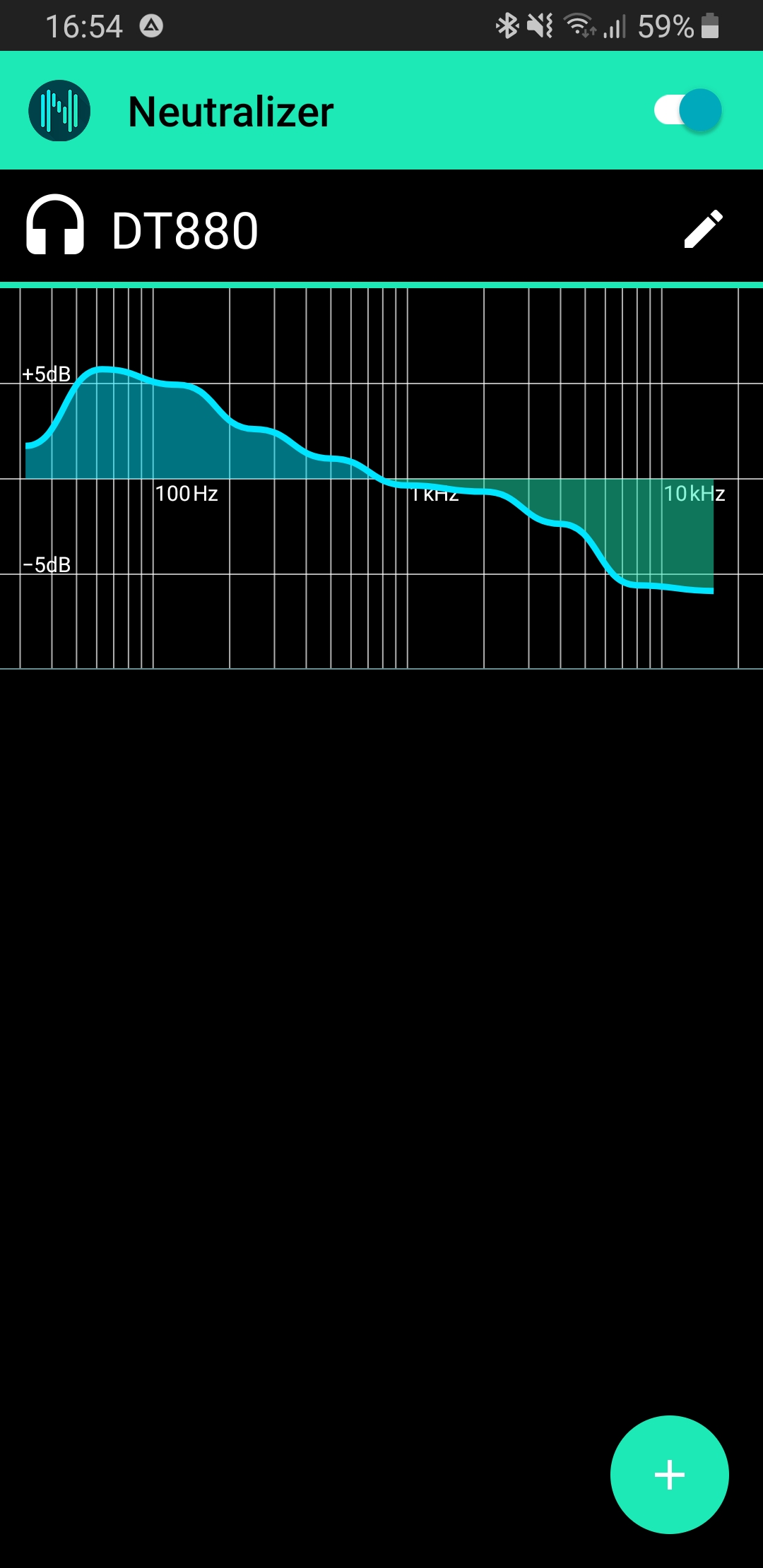

Anyone got an idea how to fix the low base? Using the Neutralizer android app, it looks like frequencies below 900 Hz are getting steadily quieter. I've attached a pic of the equalisation curve. I also couldn't hear the 32 Hz sound at all, no matter how much I turned up the volume. I really hope that that's not how it's supposed to sound, that would be very disappointing.

Tryomg to solder directy to tube pins isn't a great idea. The metal is usually not very solder friendly. Not sure where you are but you should be abe to find sockets nearby.
Connecting the grounds the way you have its is probably OK.
It is hard to guess why the freq response is odd, since you have made so many mods. Do you have a schematic as built?
DT880s come in different impedances. Even if 32 ohms the FR should not look like that. I would question the validity of the app.

I couldn't find any local vendors, but I wouldn't know where to start looking anyway. On ebay, most of them are either from the US (20$ shipping) or from china (takes ages to ship, but cheaper). I thought about tightly wrapping some thin wire around the pins. Would that work?
I attached the schematic I used. The only modifications are the usage of 12SR7 tubes instead of the 12SR7GT, but they have the same pin layout afaik, and adding a 3.5mm input as well as the RCA jacks. The RCA jacks are connected as long as nothing is plugged into the 3.5mm, and both work fine.
The app I only use to make the sound a bit flatter compared to normal. It plays a sound at several frequencies (32, 63, 125, 250, 500, 1k, 2k, 4k, 8k and 16k Hz) and I adjust the volume so that They are all the same volume. It helps with the treble and low bass of the DT880s, which are the 600 Ohm edition.

OK. This is based on the orignal starving student, which is a bit different than the SSII offered here.
Anyway... the output caps might want to be larger for such low impedance headphones, 330uF or 470uF would be good. And I really have no idea how well a 12SR7 tube will work here.
