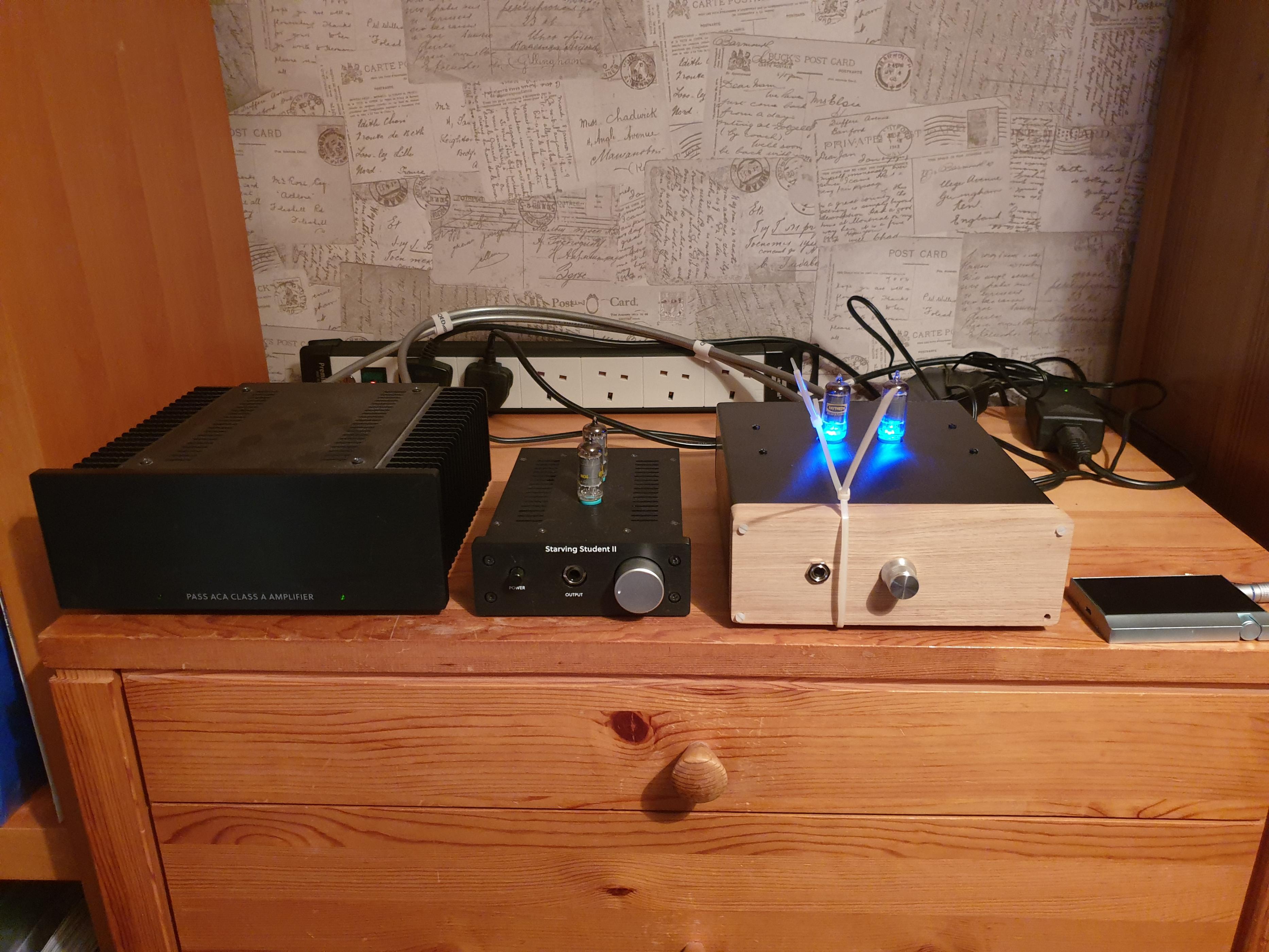

The SSII Mark 2 is mostly finished with just a couple of cosmetic issues to address. I'm giving it a couple of days to burn in before comparing it to the Diystore version.
The zip-tie is there to hold the front panel while I wait for some longer screws to arrive. The knob is the one that came with the stepped attenuator and will eventually be replaced with something nicer. (Does anyone know of a supplier of good quality knobs with 6mm D splines?). The front panel will have a finish applied at some point, but I've yet to decide what finish I want.
First impression is of significantly more detail on acoustic instruments. There has been some initial hardness to the sound but that has settled after the first few hours of use. I haven't plugged it into my main system yet, only my desk set-up, so I won't say any more for now.

I've had the opportunity to try out the two versions of the SSII in several systems now. As part of the process, I also took them around to a friend's house and tried them with different speakers, speaker cables and sources while there. My final listening session was in my main system. The source is a Naim CD5 and the speakers are Linn Keilidhs. In all cases I used an ACA for amplification.
I will start by saying that I have enjoyed the stock version a great deal and recommend it as a very worthwhile project. I would not have had the impulse to create the modified version otherwise. This assessment is purely a comparison between the two and not a comparison with other pre-amps. Please note that I am reviewing this as preamp and not as a headphone amp. I will spend some time soon to have an extended listening session via headphones.
I made a point of letting both SSII's warm up for at least 30-40 minutes before sitting down to listen through my main speakers last weekend. I have used the Raytheon tubes/valves in both versions to minimise variations from that part of the circuit.
I made a comment in my last post about a degree of hardness in the sound. I isolated this to the Astell & Kern AK70 that I usually use as a portable music source. It has a line output setting which produced the same 'hardness' in my friend's system. Once noted, I reduced the output a little. This improved the sound significantly.
The stock version has a very agreeable character that has made it a good addition to my office set-up. This uses a pair of Q Acoustics 2020i speakers in near field setup. As they are only two feet away from my head, any harshness is not easily tolerated. Since high volumes aren’t required, the ACA doesn’t get stressed either. There is plenty of information provided in this set-up but very little soundstage due to the positioning of the speakers. I play a wide range of music from light classical (very little) through to heavy rock. I lean more to prog rock and well-played blues, so the music ranges from simple acoustic to heavily produced.
Within the limitations of the relatively small speakers, the stock version works well. The bass has good depth but not earth-shaking, and the treble is easy on the ear and has a good amount of detail. It is an arrangement that I can listen to for several hours at a time while working at my desk and has been used for several months now. It is especially good when listening to acoustic guitar or female voices, to the extent that I can easily get distracted from the work that I should be doing!
Listening to the stock version at my friend’s house produced similar results. His B&W speakers are close in size to the Q2020i. His other speakers are a Scanspeak DIY kit which are only slightly larger but much more revealing. In this set up I noticed that the stock version began to sound muddled and it was difficult to place instruments. Switching to the modded version quickly demonstrated more detail and emotional insight to the music. I made a point of not discussing my opinion of the sound before my friend had given his. His summation was that was “more pleasing and engaging.” There was significantly more ‘leading edge’ or attack to each note and not in a distracting way. There was an increase in dynamic range, better bass control and a little bit more depth. In that set-up, we couldn’t discern a great deal of difference in the range of the treble though.
The most fun has been had in the final listening session through the Keilidhs. I have used the ACA with these before, mostly with a Naim preamp, but also with an Aksa Lender pre in the last few months. So I have a good measure of the ACA/Keilidh combination. As mentioned before, the source was a Naim CD5 and both versions of the SSII were given plenty of warm up time.
In this set-up the differences in sound were much greater. The stock version worked well enough at lower volumes but instruments would become difficult to isolate and follow if the volume increased or the music became more complex. The bass had little impact and the treble very smeared. This was the case even with relatively simple recordings, one example being a string quartet.
Swapping to the modded version, the muddle was greatly reduced; even during it’s warm up phase. After 30 or so minutes of warm up it was all but gone. The sound remained characterful, like the stock version, but the bass was much more palpable and distinct. Toe-tapping is still a very good way of judging how involving a system is and I noticed that I was ‘tapping’ from the very first track played.
It noticeable came ’on song’ after about 45-50 minutes. The rhythms became easier to follow; voices had separation and well defined locations. Bass instruments had power and projection. The treble still doesn’t have the extension that we expect from transistors design, but there is plenty of detail to follow and enjoy. The most enjoyable track of this listening session was ‘Homeless’ from Paul Simon’s ‘Graceland.’ The sound was nicely balanced from bass through mid-range to the slightly rolled off treble. This is combination that is far from neutral, but one that I could listen to all day long. They was soooo much atmosphere and emotion in this track that it made the whole process of making this modded version worthwhile all on its own.
To restate, the stock version is still a kit that I thoroughly recommend to anyone. It is professionally manufactured and straightforward to assemble. It is very enjoyable to listen to and should take less than a day to finish. Producing my modded version involved obtaining all the parts, hook-up wires, enclosures and the like. Then you have to measure up and cut your own holes (not as easy as it seems!) and make an agreeable looking package. I estimate the cost of my modded version at about £140-£150 but then there have been many more hours used up in its production compared to the kit. Routing solid oak was a learning experience, as I have been used to routing plywood, MDF and softwoods. It is a lot harder, literally and figuratively. Waiting for the cheaper aluminium enclosure from a Chinese eBay vendor is measured in weeks and not days. The finish is not as good as the HiFi2000 cases. You pay only a little more for a great deal more convenience when you get the kit from the diyAudio store.

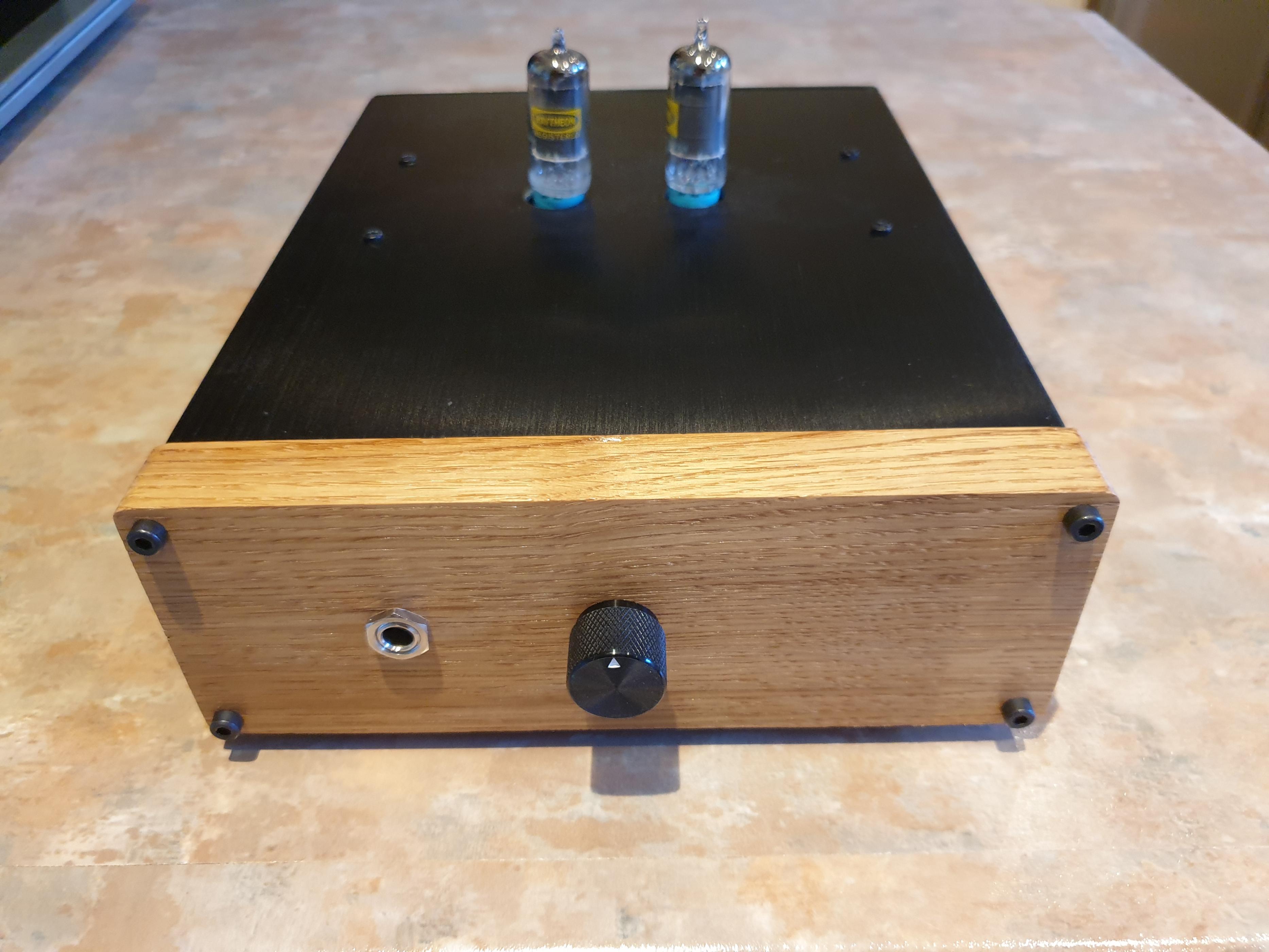

Finally finished the exterior of my case with some Danish Oil on the oak front. The little black knob was the best of what I could find for a 6mm d shaft. I must make sure that I check the shaft size before ordering next time (no innuendo intended, honest).
Looks great! I built mine stock but into a custom case, as well.
