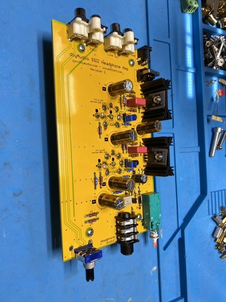

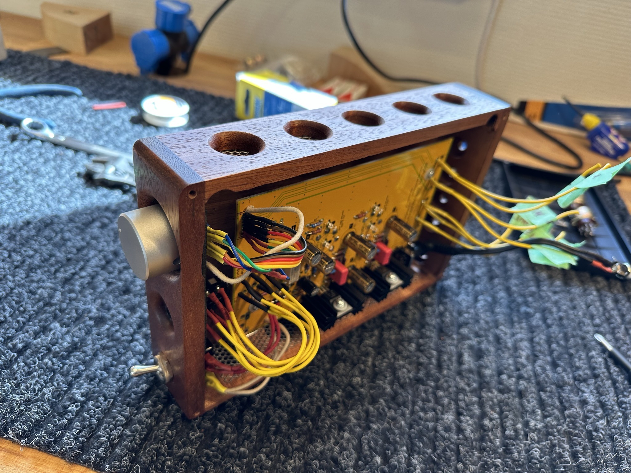

Hi folks,

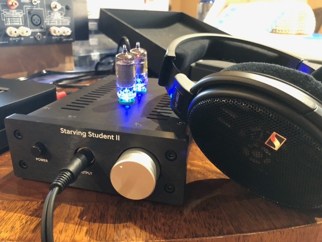

I finally got around to ordering and building the latest Starving Student 2 HPA. First and foremost, a big thanks to Pete Millett for designing what is a very easy and fantastic sounding HPA (or preamp)! Also a big thanks on a really intuitive and easy to follow kit. I've put a couple of kits together for DIYAudio and can very much appreciate the attention to detail and effort in how this was put together. Thanks again 6L6 for another fantastic and easy to follow build guide as well. I am either getting really good at this, or Jim's guides (or both) because this kit worked the first time I turned it on. 🙂
Onto the kit, as you can see from the attached pictures, I built the stock kit without any modifications at first. This is very much a best practice for any newbies reading this. After getting it together I gave it a thorough listen using my AKG-712Pros which I've measured to around 61-62 Ohm. The tube-effect was immediately apparent. Sweet mids/highs with a very good bottom end due to the current drive from the MOSFETs. There seems to be no issue driving the AKGs with this setup. I've also used this as a preamp to drive my stock ACA 1.8s and the result was immediately pleasing even at high volumes. I've been told this is a nice preamp to drive an F4 too, which is planned for my end of December break!
I've tried the amp setup in both R and CSS modes and have come to the conclusion I prefer the CSS mode. At very low volume levels I did not detect much difference, but at higher volume levels the bass seems to roll off a bit, but I have not measured this. This is a really cool feature BTW, since previously all tube amps/preamps I've played with and listened to had only the R option. I will measure the differences later this month after I get my QuantAsylum setup working and will report back.
A few things I noticed with the stock setup. As you can see, I am running this through a custom 24vdc linear PSU based on the Sigma 22 that drives a SMSL USB DAC I've used for a dozen other projects as a stable reference point. I use Tidal master-quality as a source on the same set of tracks I use for testing (listed in the Whammy thread).

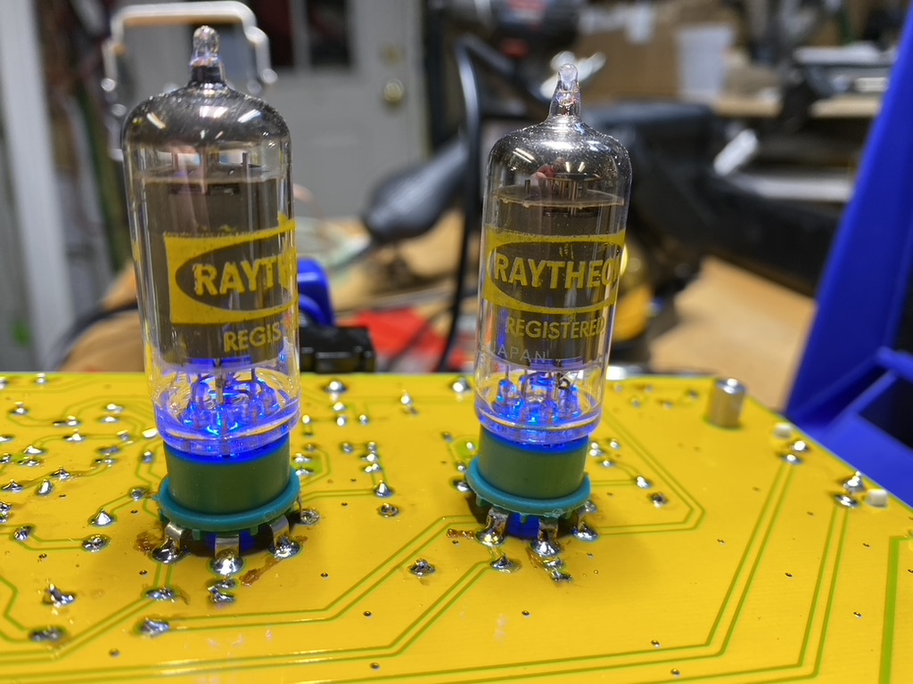

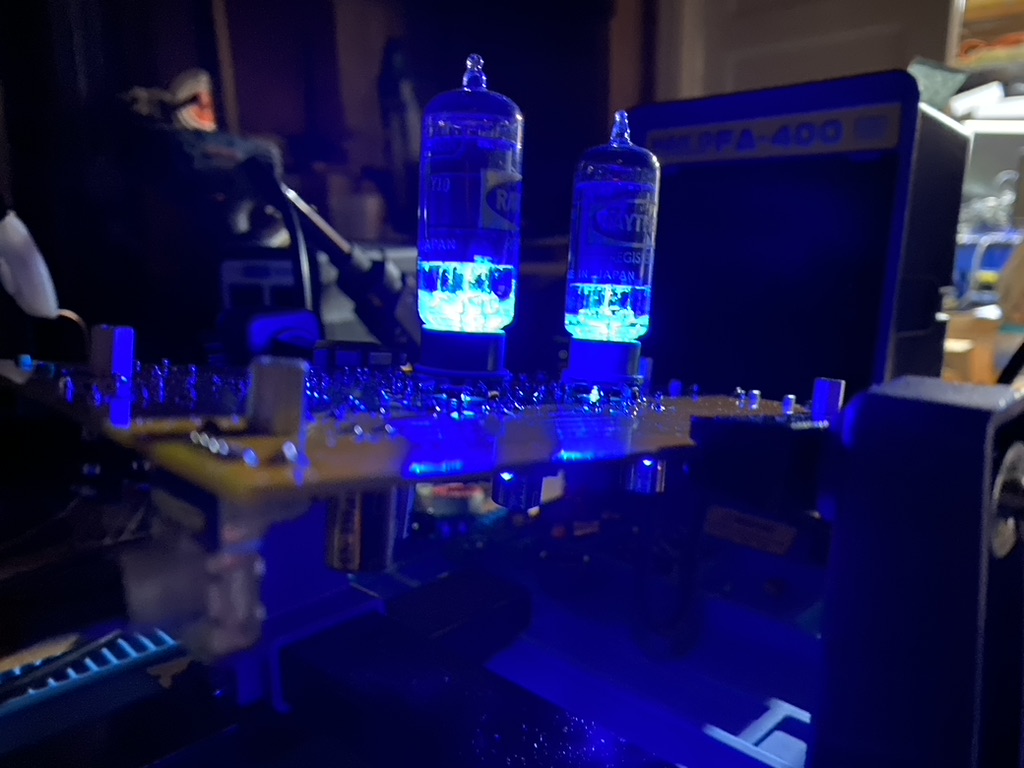

I noticed the Raytheon tubes that come with the kit were a bit microphonic. I could run my finger along the case and could clearly hear it in the headphones, as well as other induced sounds. I also noticed a high frequency "hiss". To address the microphonic issue, 6L6 recommended I try the rubber/silicone o-rings as well as the metal cans. The orings I ordered turned out to be a little too big, but I had the metal cans with springs inside too so I used those. These helped a bit but I still need to try rubber isolators on the board mounting points.
To address the high frequency hiss, I employed Mark's SMPS P089ZB filter. I've gone through extensive measurement previously on this with Mark's help as I wanted to measure how this worked before I put the kit together. It really does what it says on the tin assuming the SMPS's switching frequency is around the center Mark built this for. I put together a new one and put it into a box as shown in the pictures (the little black box). This completely eliminated the high frequency issues with the SMPS that comes with the kit, so I highly recommend its use if your DC power source is an SMPS like the stock kit comes with.
I also ordered a set of Zenith 18FX6s (the stock ones are Raytheon 18FX6As). The only differences I found were in the microphonic department, which are far less than the Raytheon tubes that came with the kit. Note that some tubes seem to be microphonic (including brand new stock like JJs) while others of the same make/model/type are not. Its seems to be a manufacturing variation, so its a trial/measure/error thing and why some tube sellers charge a little more to test for this. There seems to be no rhyme or reason in my experience as this even applies to brand new NuTubes. In any event, the stock Raytheons are fine sounding absent the microphonics.

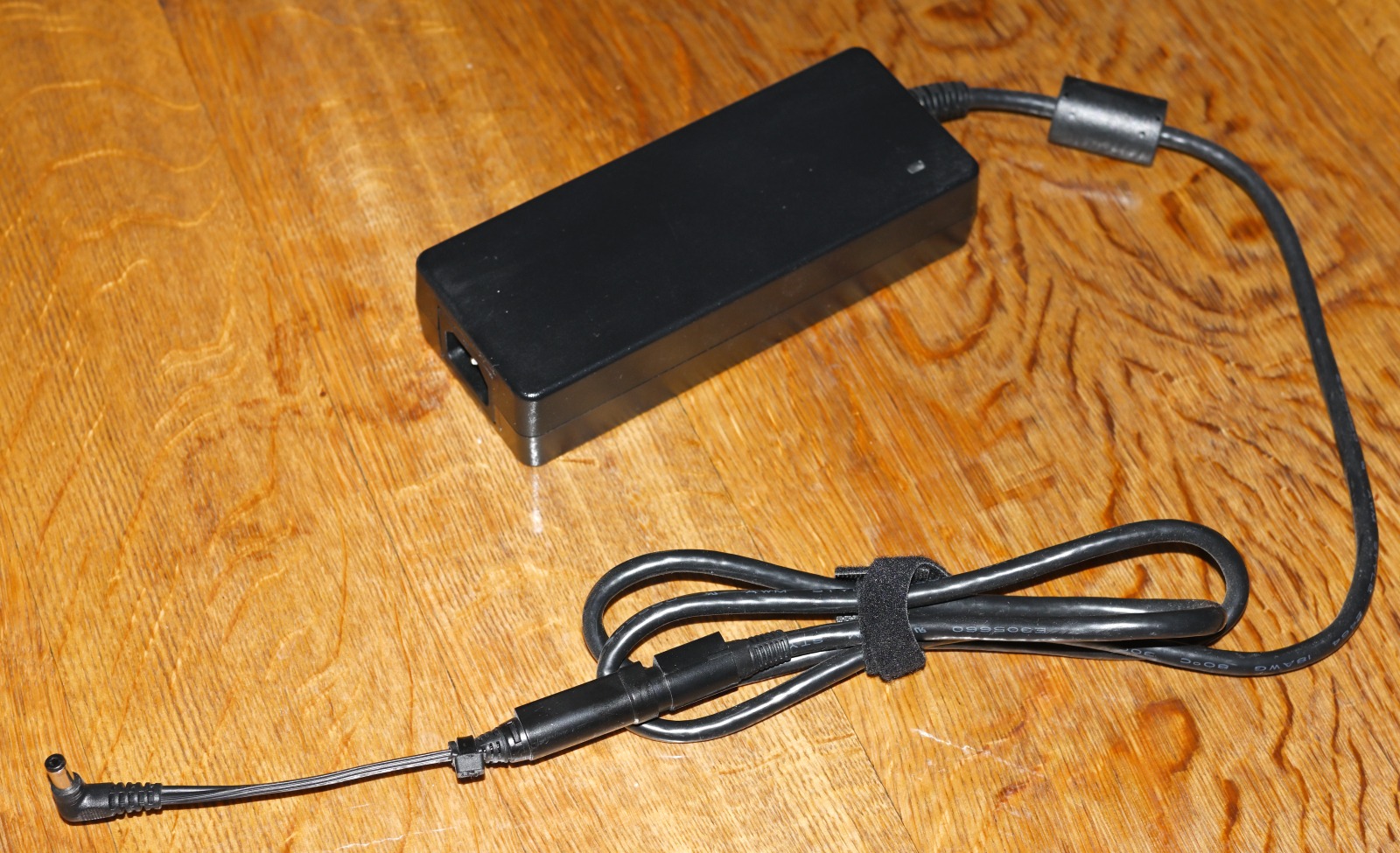

I use a 3rd party 12V PSU (linear) for my DAC.

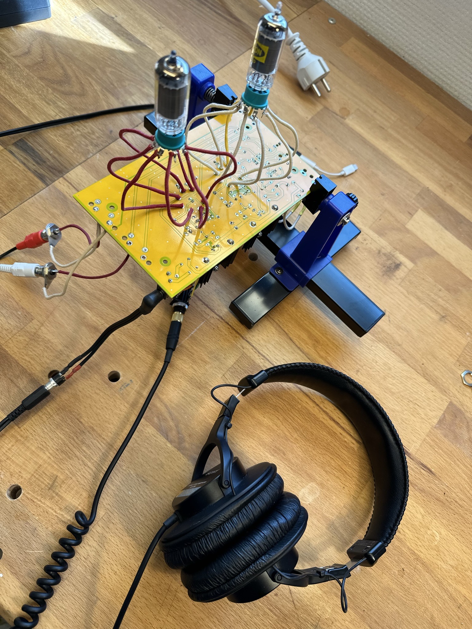

This was a great and great sounding build! Lovely to be able to combine my two hobbies; woodworking and electronics. Thanks!

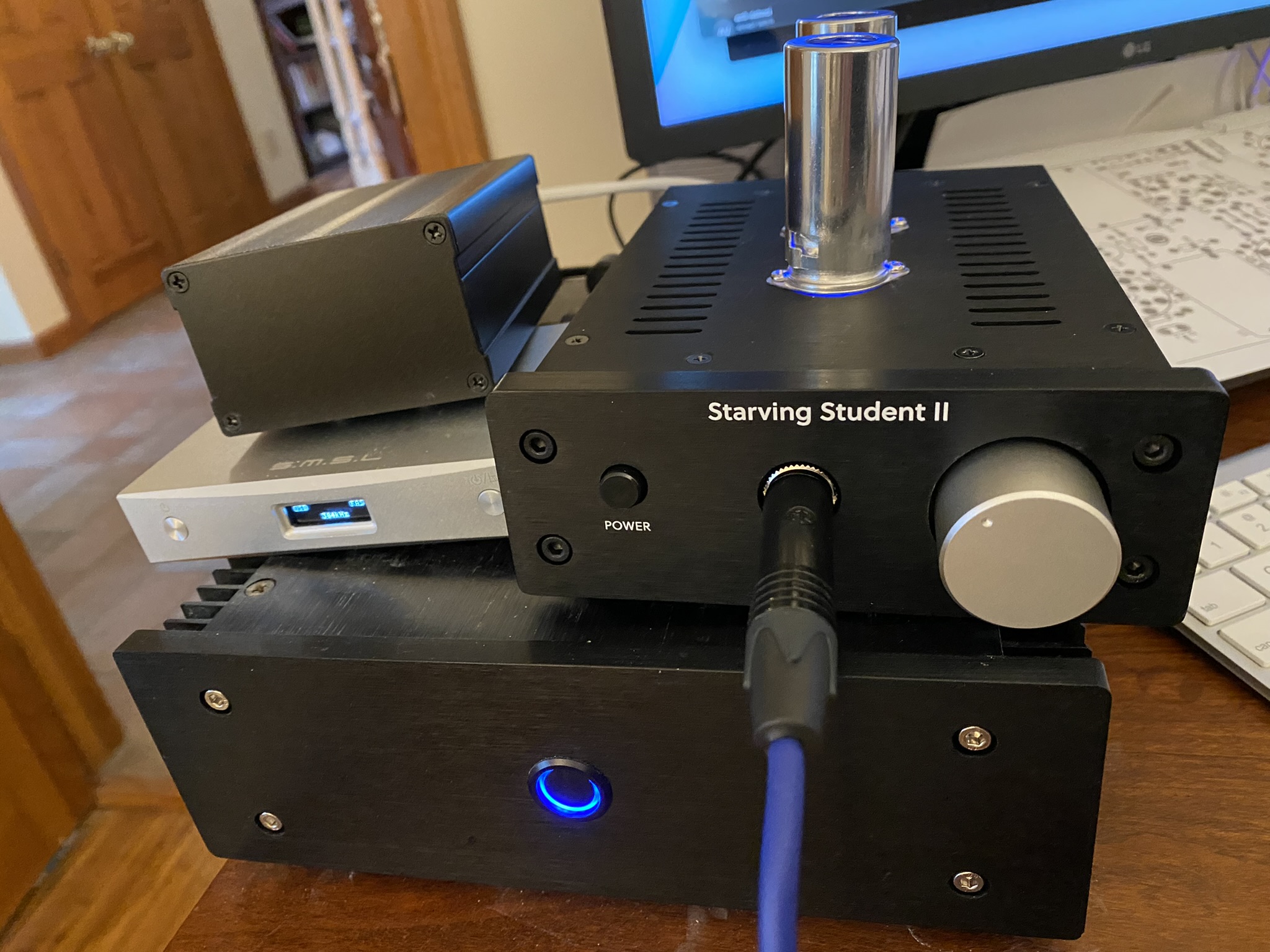

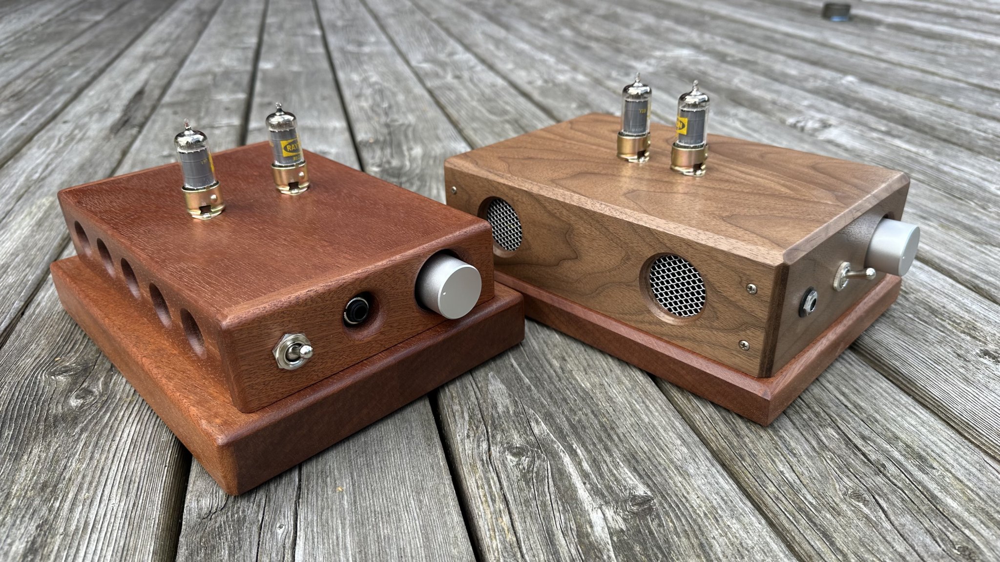

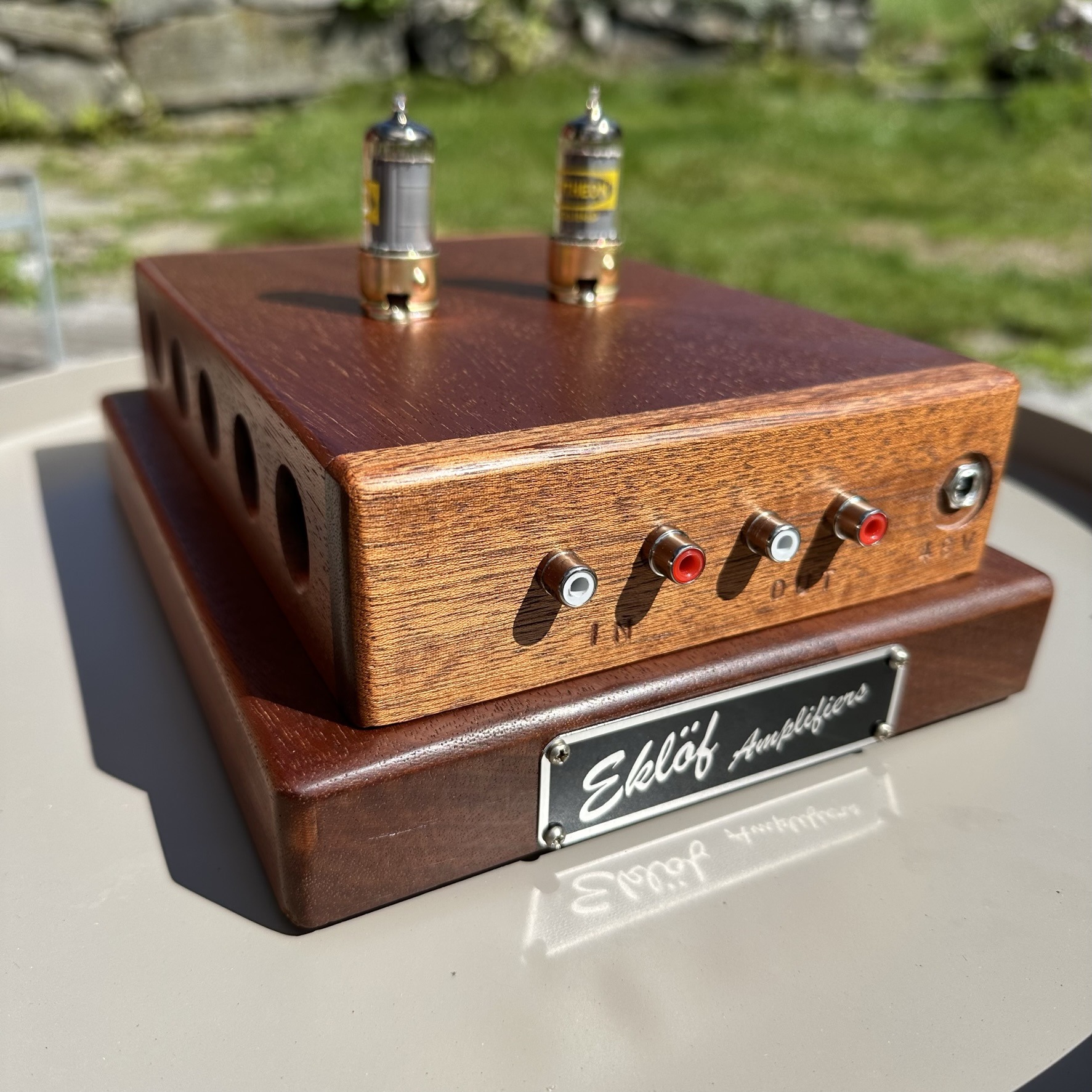

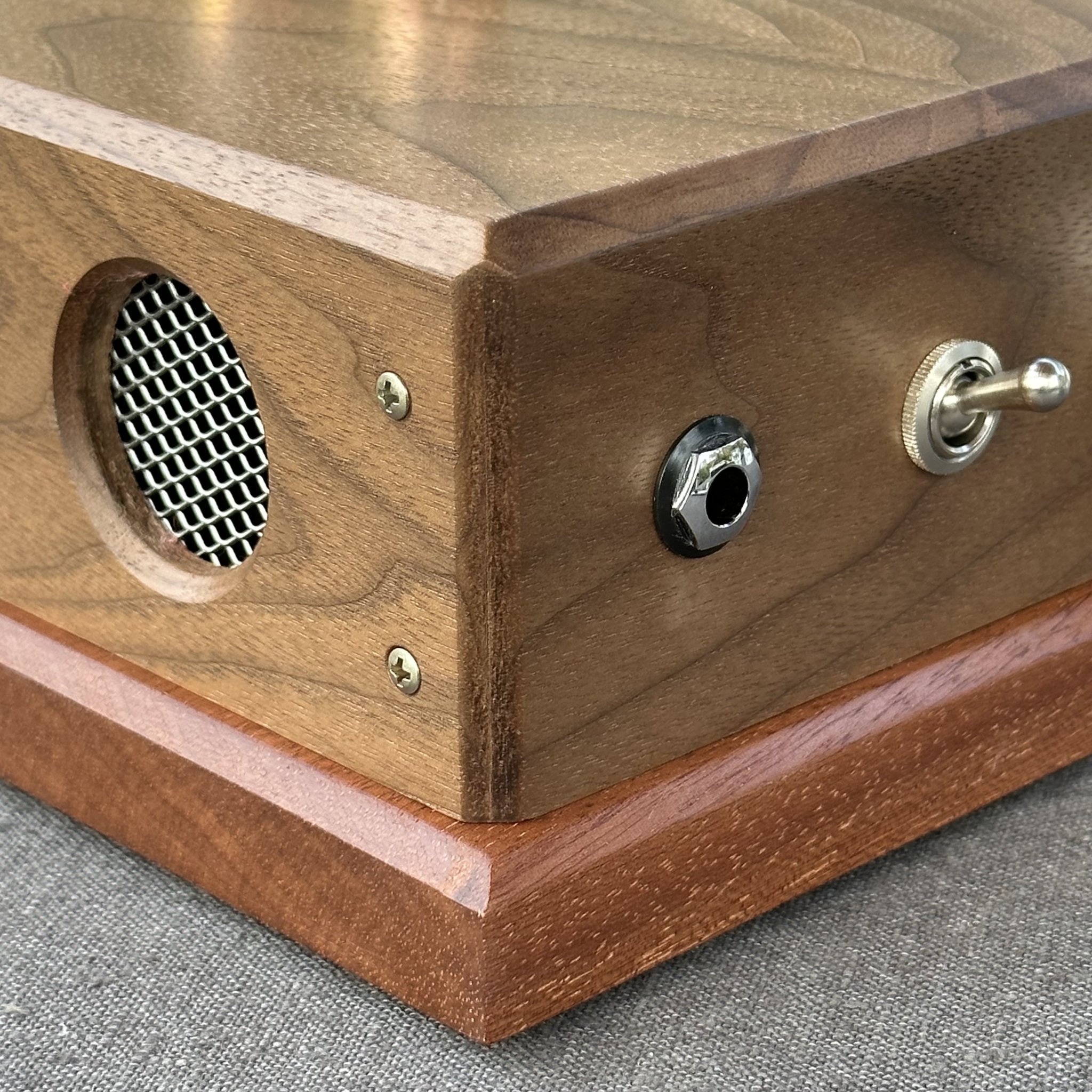

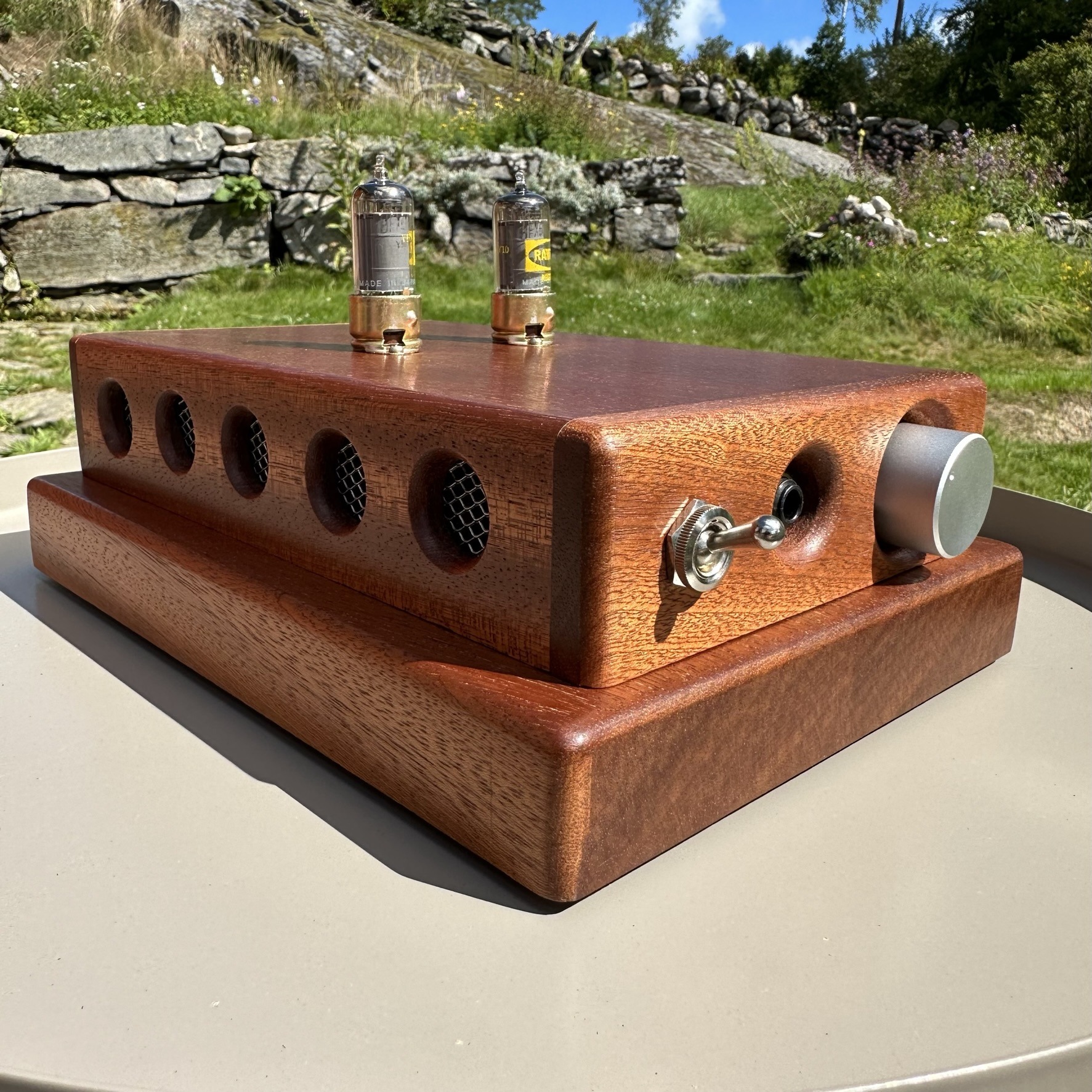

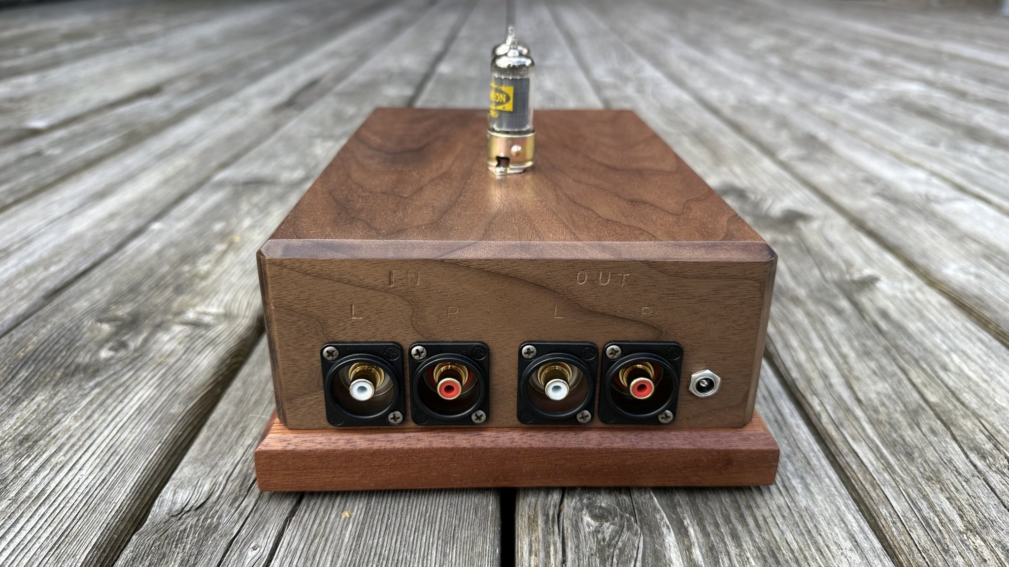

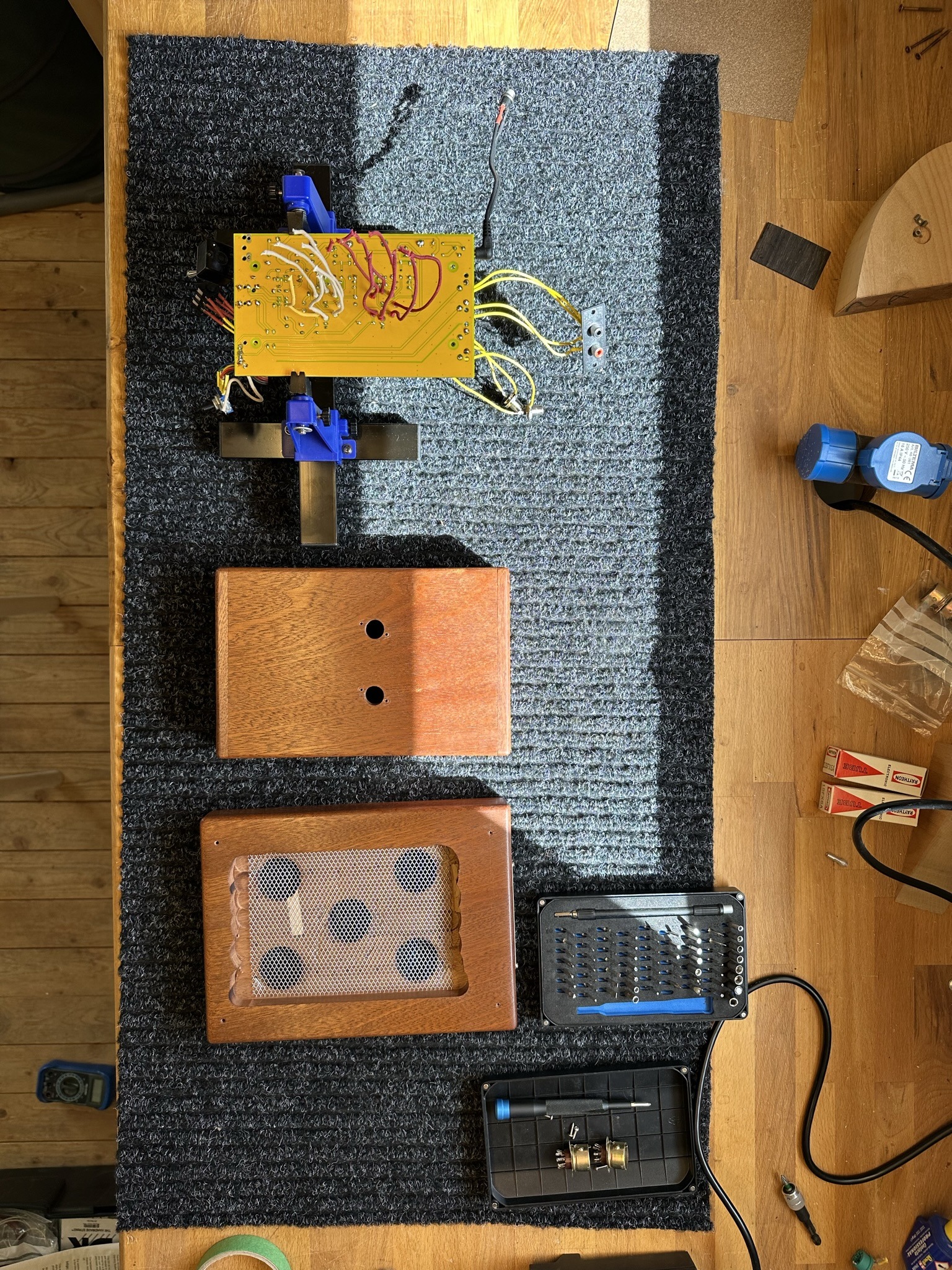

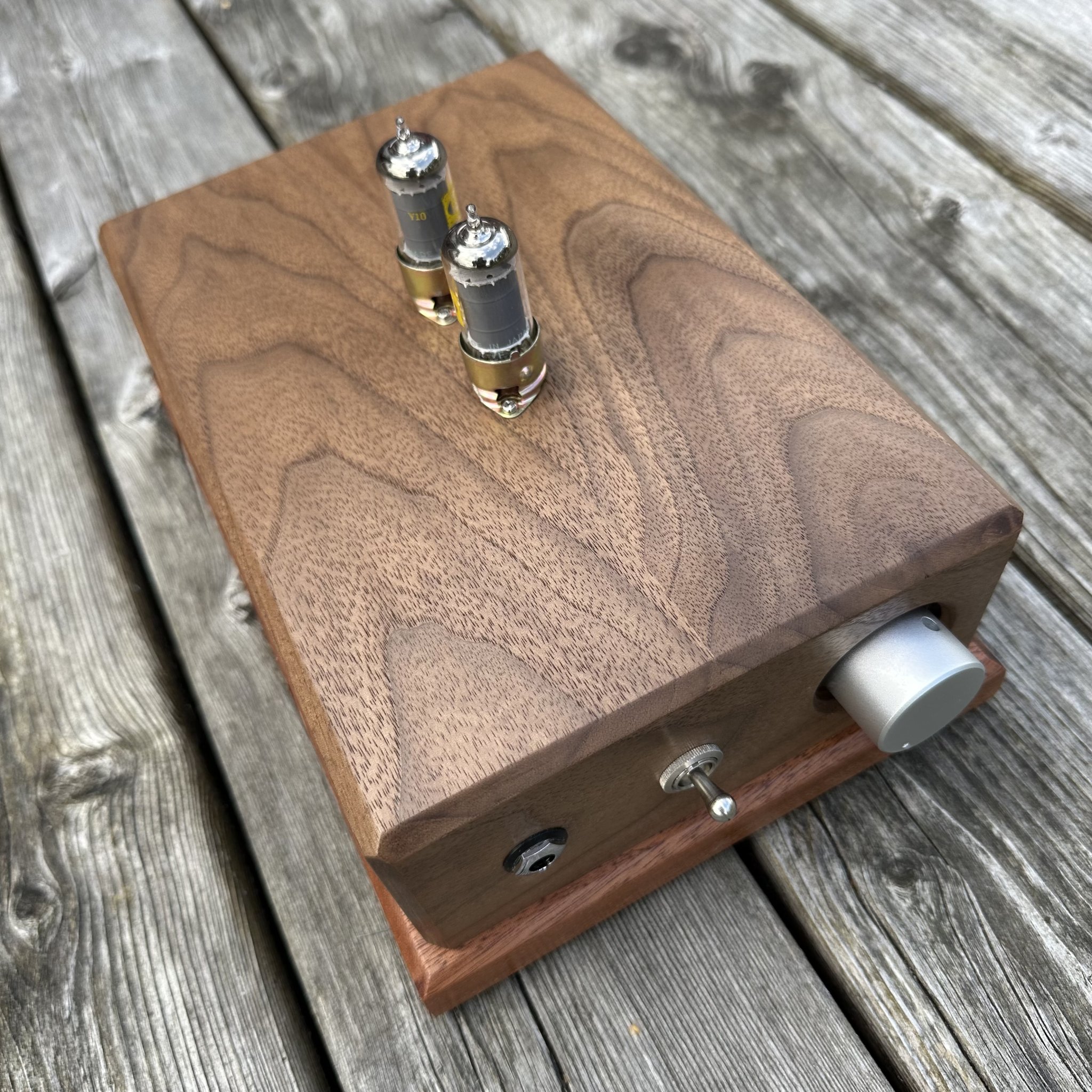

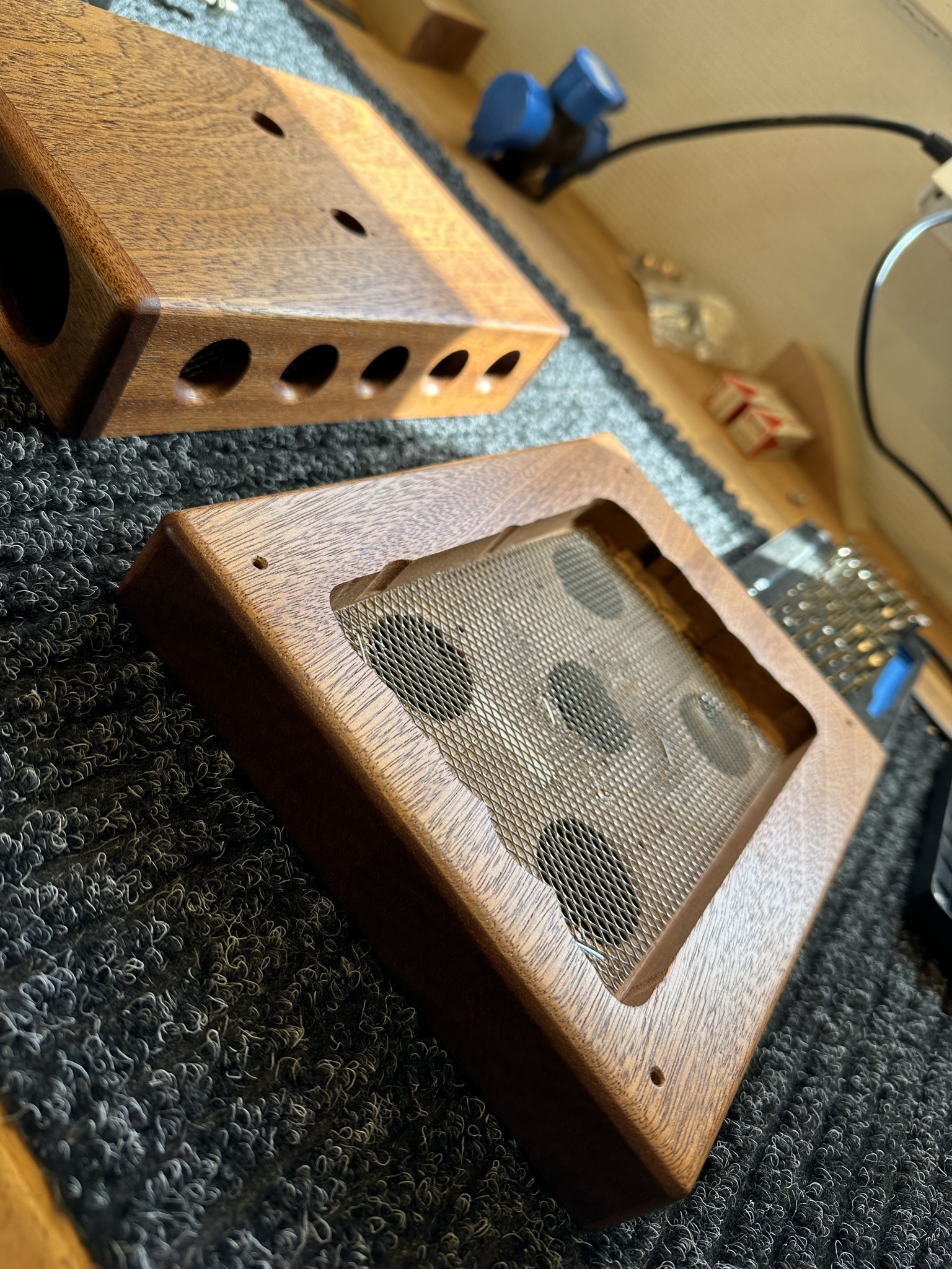

I bought two kits and built a second enclosure, this time in walnut with a mahogany plinth, turned out pretty nice I think.
