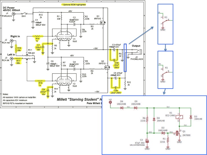

I'm thinking of removing the front panel switch and putting a rocker on the back since I'm modding a Galaxy 1u case anyway.
Is there anything I should worry about here? Should I just solder a 4 wires directly from the relay to the new switch? Looking at this part
Maybe a dumb question.. but I'm a total newbie to anything "off script" with these projects.
I'd probably do it differently: Wire the power supply through the switch, and just solder 'jumpers' across the connection for the old one. But that will depend, obviously, upon how you set the whole thing up.

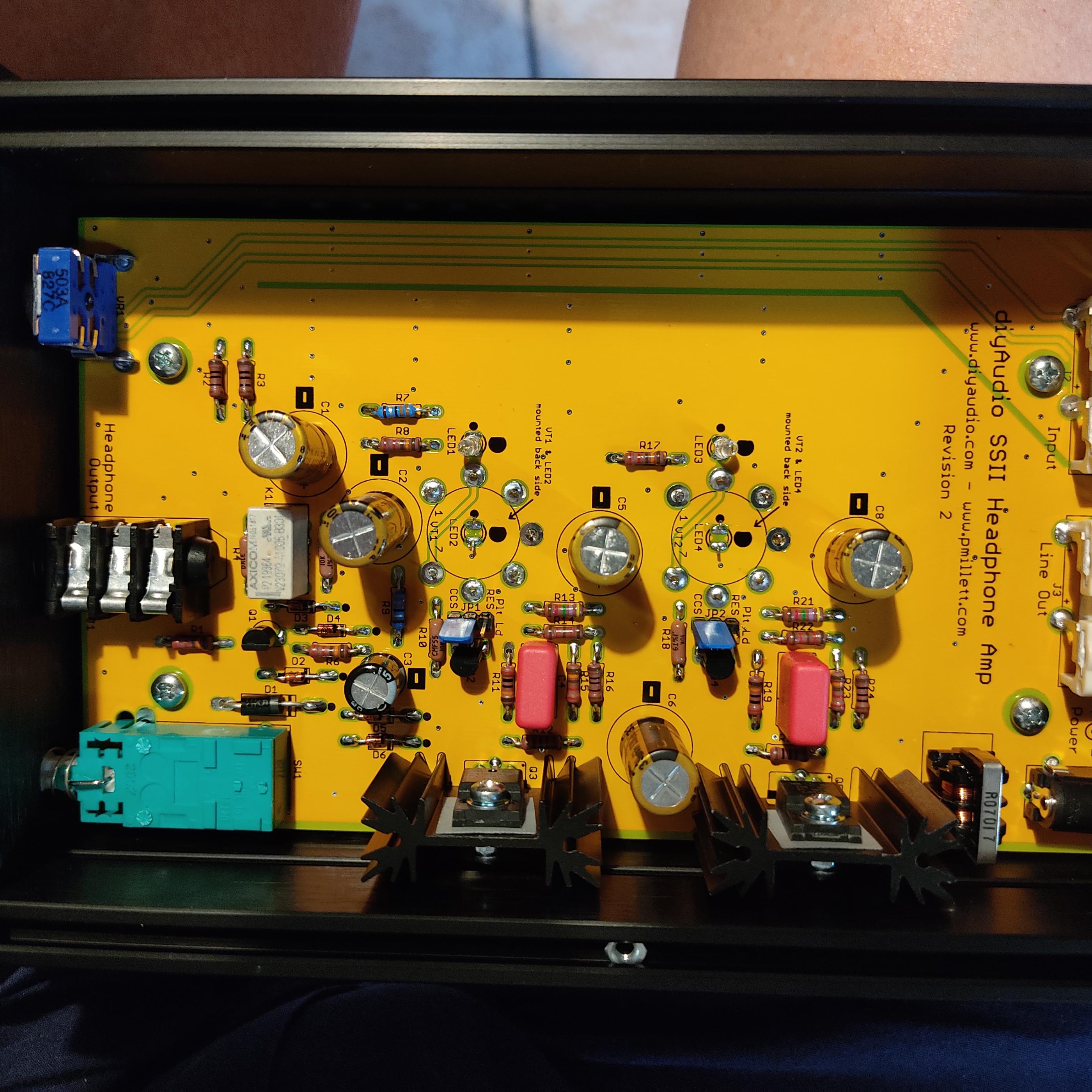

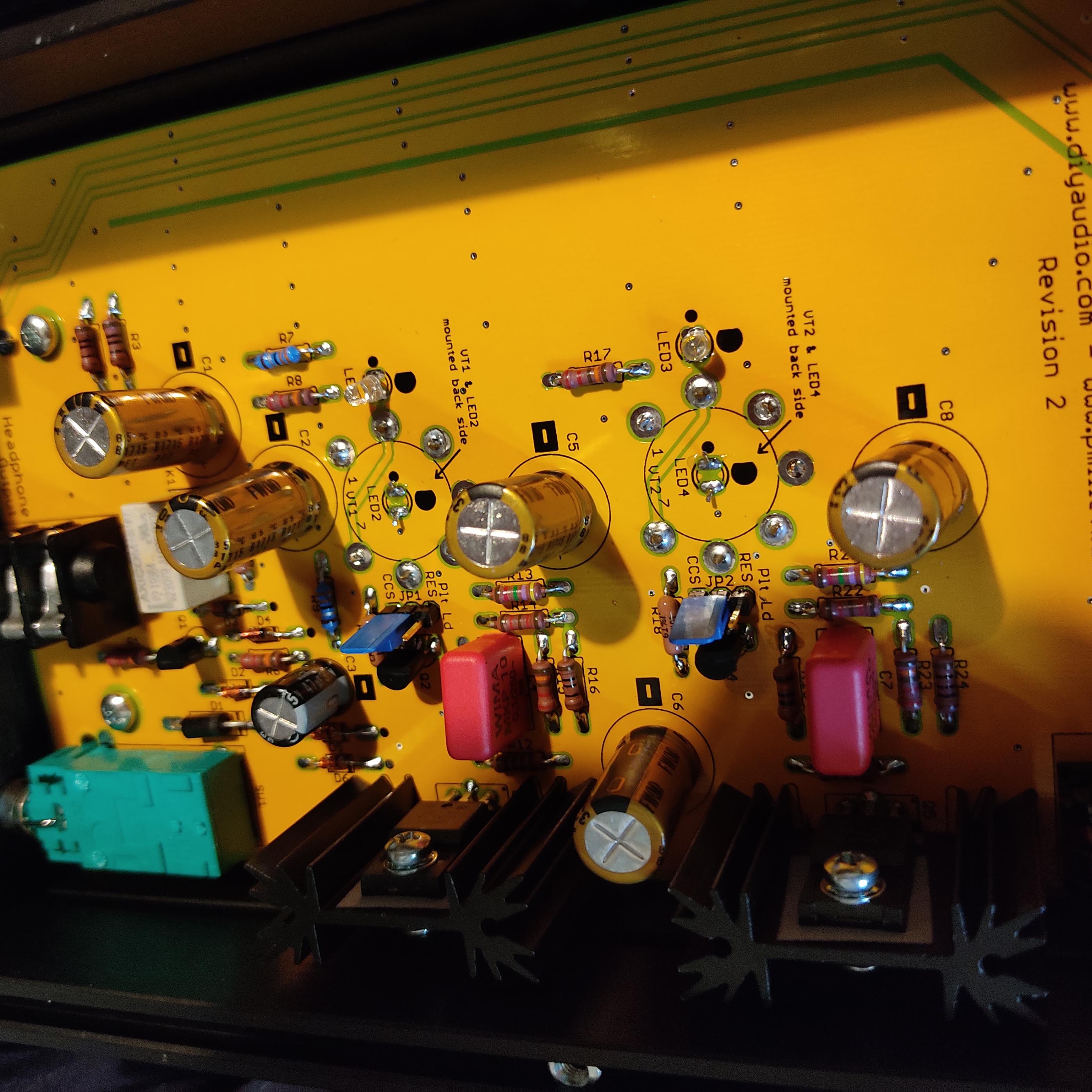

Loving my amp so far, but it's started to develop more hum. Or maybe I'm just noticing it more!
I'm wondering if it's related to the difficulty I've had seating the tubes in their sockets. See pic.
As you can see, I haven't installed the chassis yet. It's out at Front Panel Express.
The hum is kind of two "layers": a persistent hiss that's always there (maybe just the standard noisefloor for this amp?) and a louder hum that gets louder as I move my hand closer to the tubes.
If I touch the 1/4" headphone adapter the hum reduces slightly.
Any tips?
Any tips?

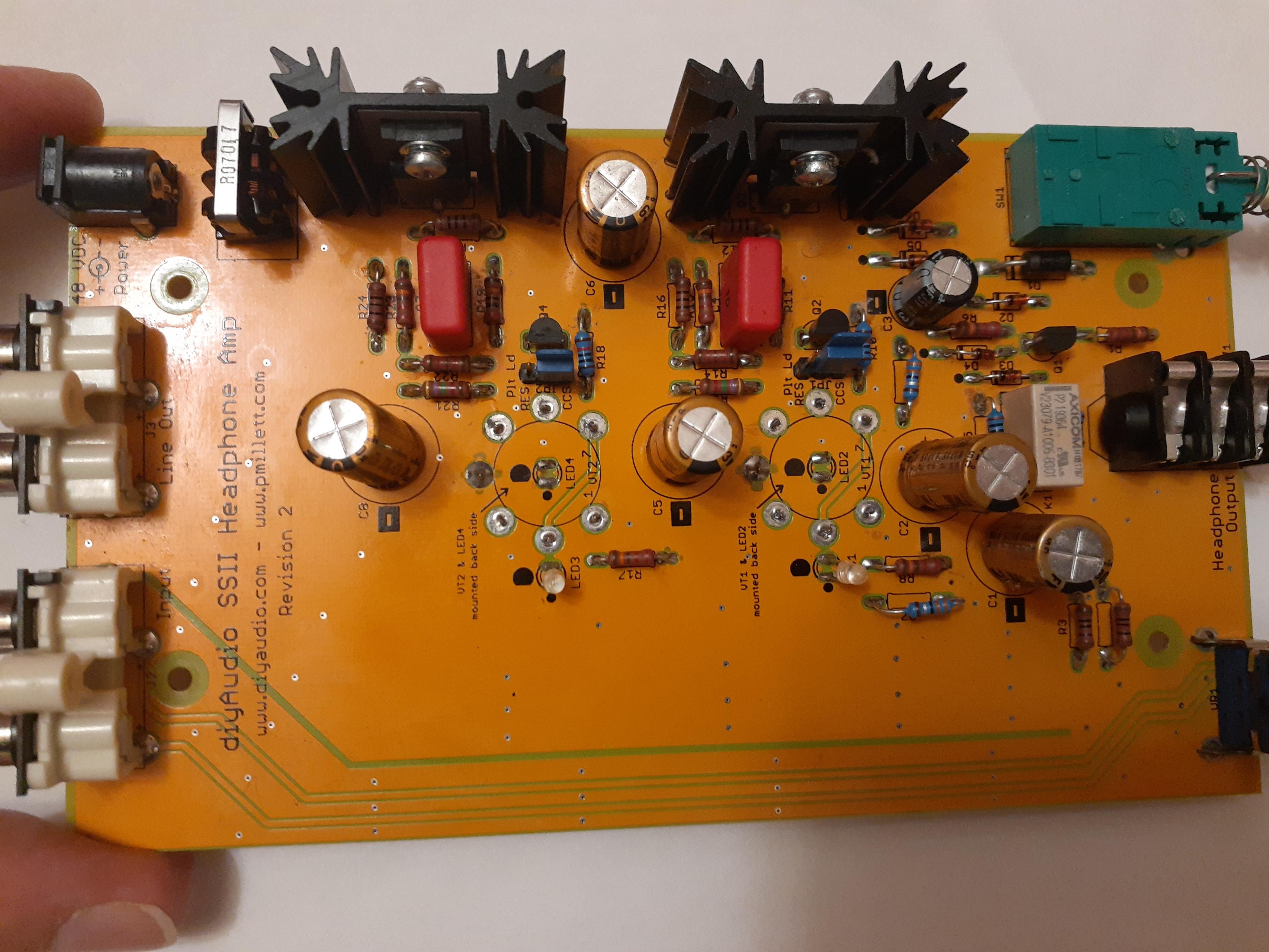

Should I be worried about 19.8 volts on pin 3?
Noob here, I just completed my build and the voltage on pin 3 of the sockets was 19.8 +/- .04. The fact they measure so close to each other seems good, but the documentation says the range should be 18.5 to 19.5 so I'm slightly over that. Should I be concerned? If it's a result of my error, where should I look for the error? I've gone ahead and listened to it for a number of hours, it all seems good to me and nothing has blown up so far. But ignorance is bliss only until it isn't so I thought I'd better ask if there is something here I need to rectify. Thanks.

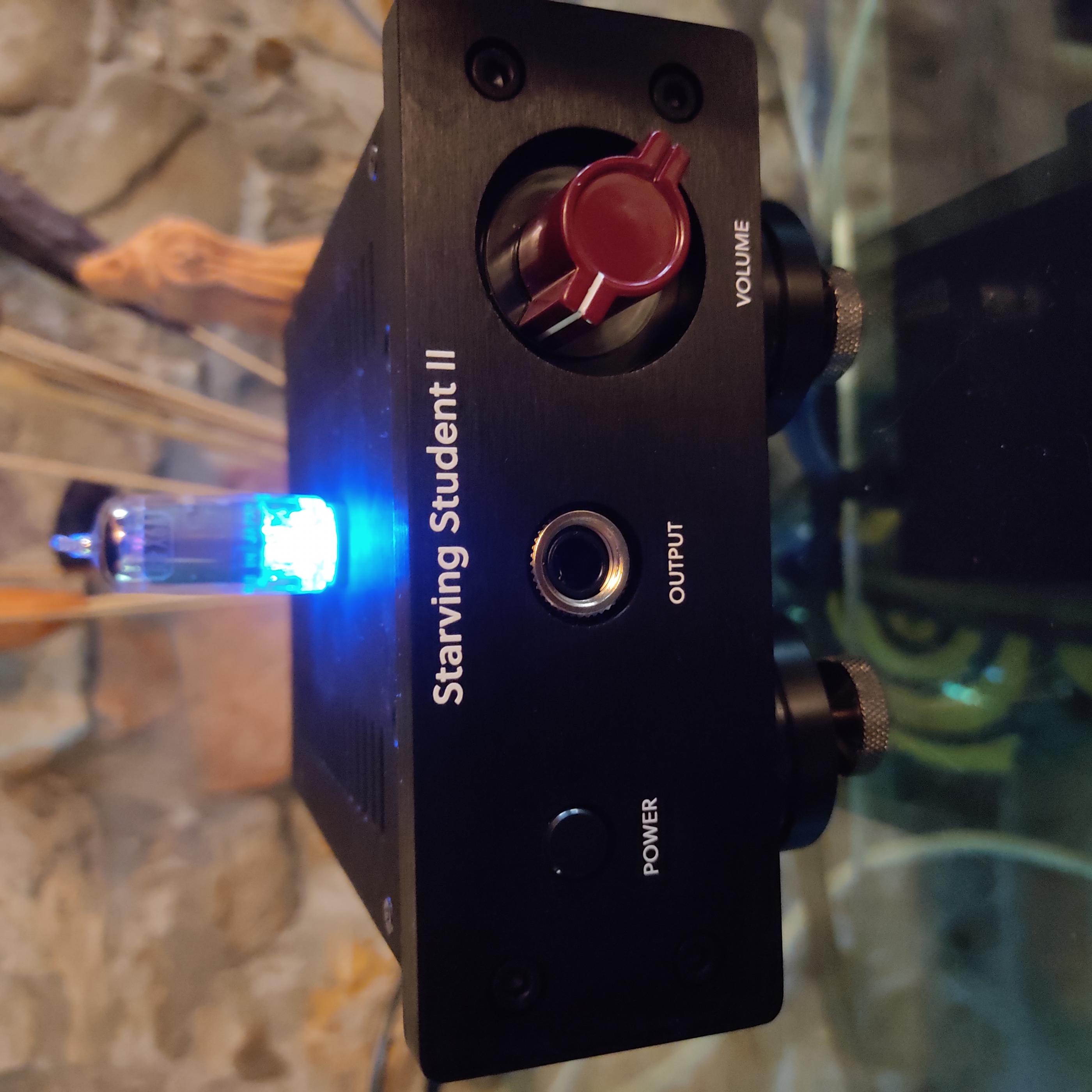

No sound from new build.
I bought this kit for my son and he built it without any real problems. But, once plugged in it did not produce any sound.
The blue LEDs light up.
The two white LEDs on the inside light up when I max the volume.
But there is not sound.
Does anyone see an obvious problem with the build?
