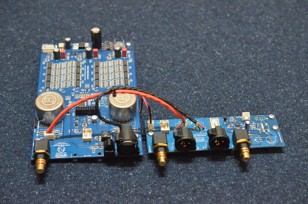

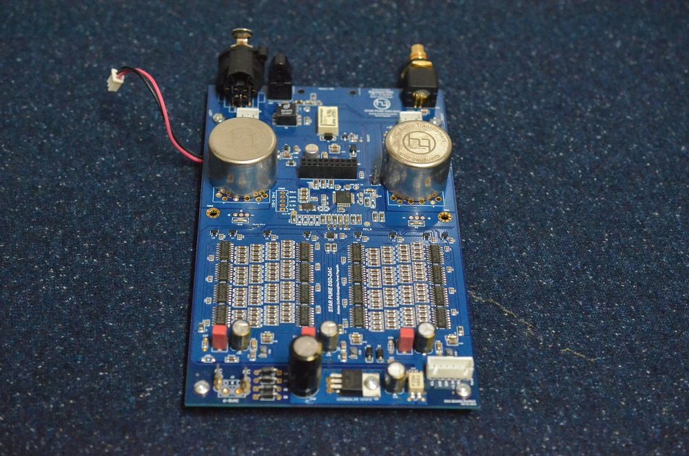

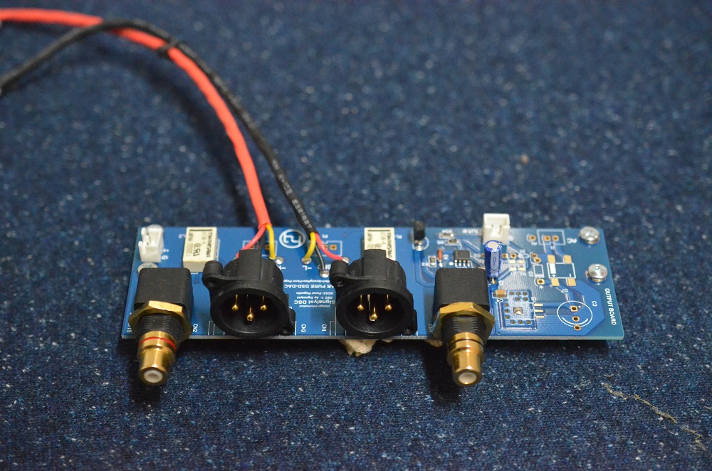

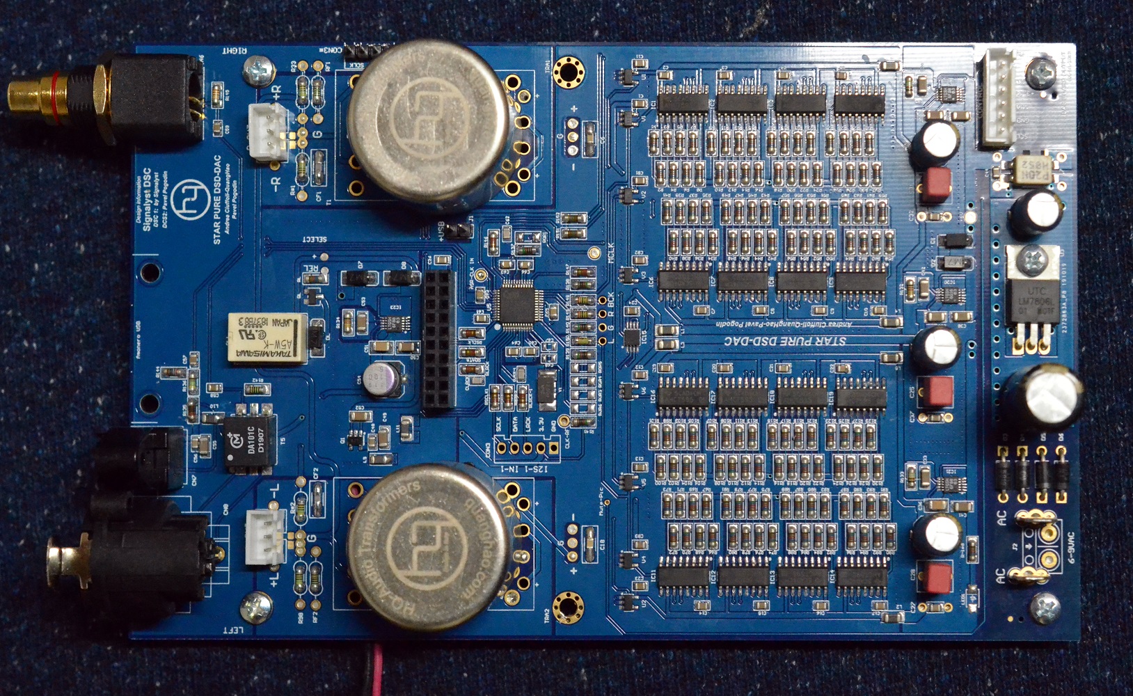

Here are some pictures of Star pure Dsd DAC.
1- Star pure Dsd DAC board
2- Star pure Dsd DAC output board
3- Control circuit board.
4- Remote control
5- A full set of Star pure Dsd DAC
