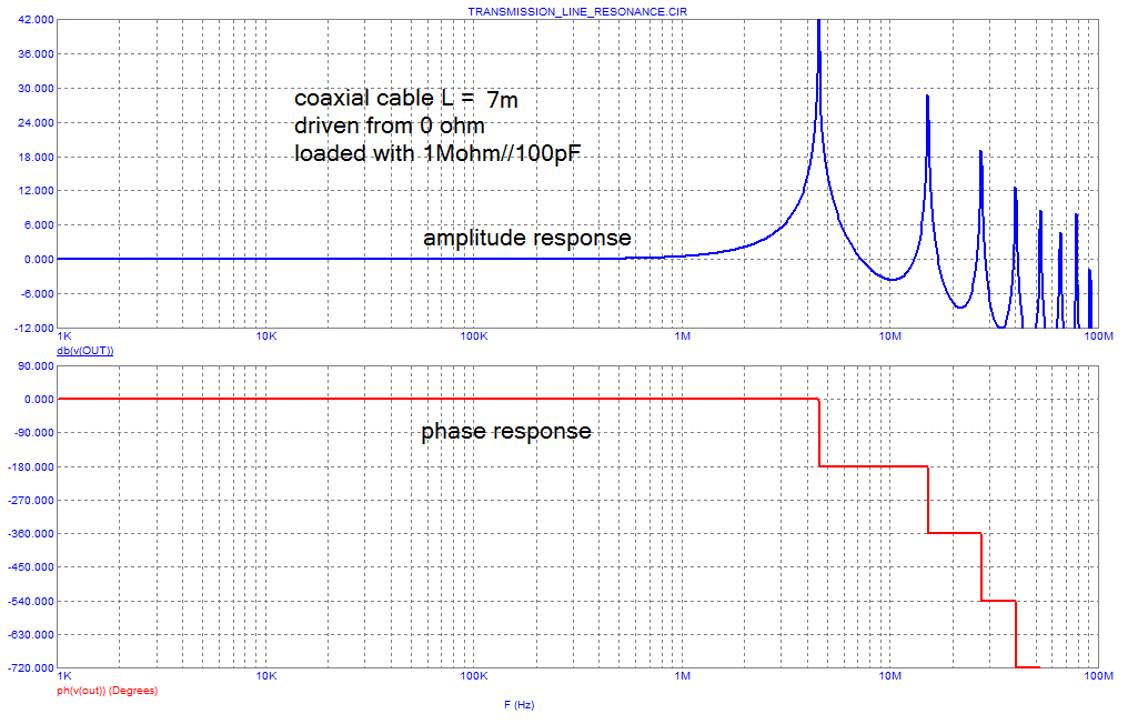

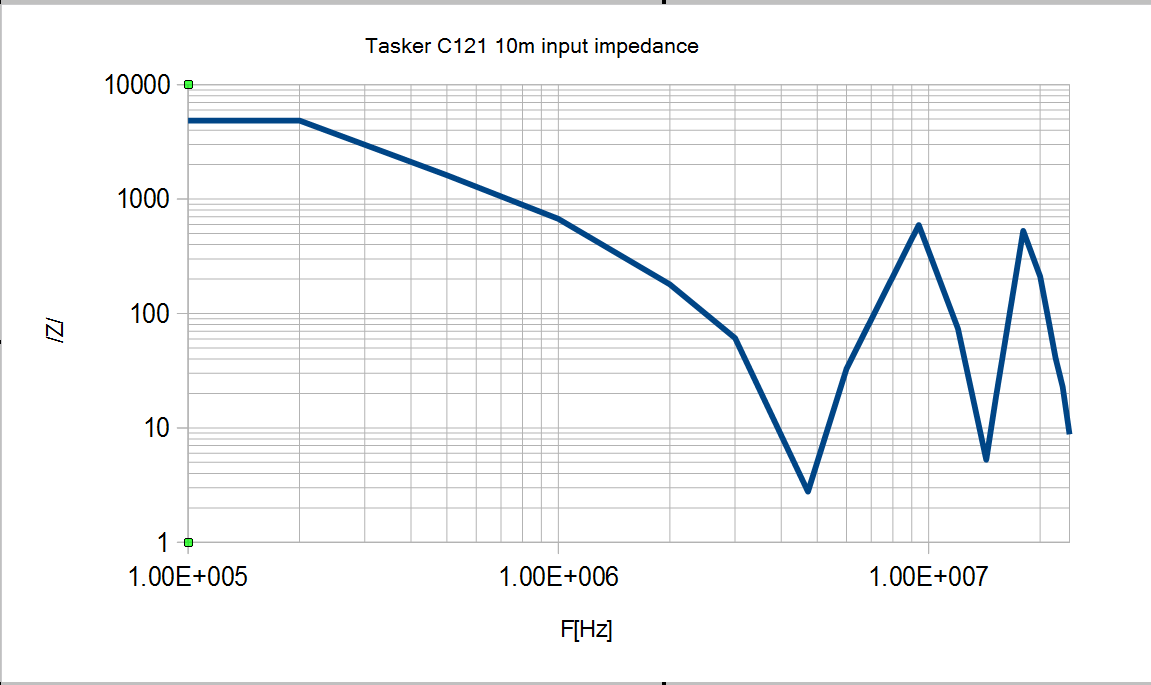

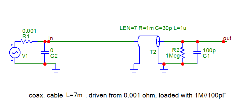

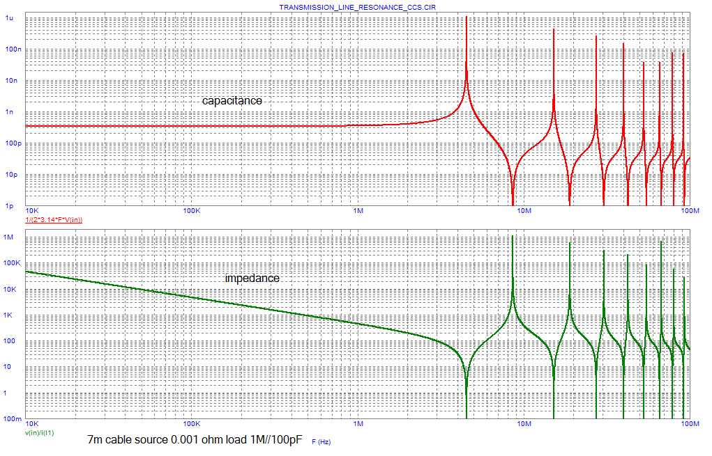

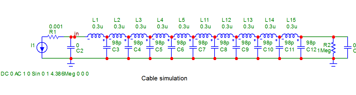

I see coaxial cable continues to be marketed by Van den Hul as it was over 30 years ago. I have a small length of this my cable collection, this having a brown jacket. It would have been nice if it had been less rigid and had plugs to suit but I deemed it unusable in our living space. This cable is expensive and would have to be sourced from other than electronics suppliers in Australia. I did not pursue this - there is a lot of capacitance in your transmission line it is understandable this gives rise to high levels resonance. I have not done a Tian plot but your cable may require unity gain stability.Coaxial cable simulation
View attachment 1240105 View attachment 1240106 View attachment 1240107
Alternative sim circuit
View attachment 1240108 View attachment 1240109

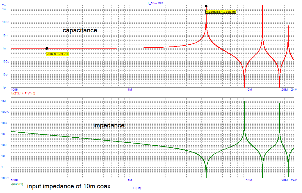

Class AB amp (without output coil) oscillations with long unloaded coax cable
View attachment 1240110 measured impedance View attachment 1240111
I do. It is called a speaker.You MUST use output coil in this design.

Speaker is placed behind the speaker cable. The possible instability I tried to explain has an origin in input capacitive impedance (at discrete high frequencies above 1MHz) of the cable as a transmission line, cable open at the end, which is the equivalent of speaker inductive load. I have shown simulations, I have shown measurements and real life example of oscillations. I cannot do anything more.I do. It is called a speaker.

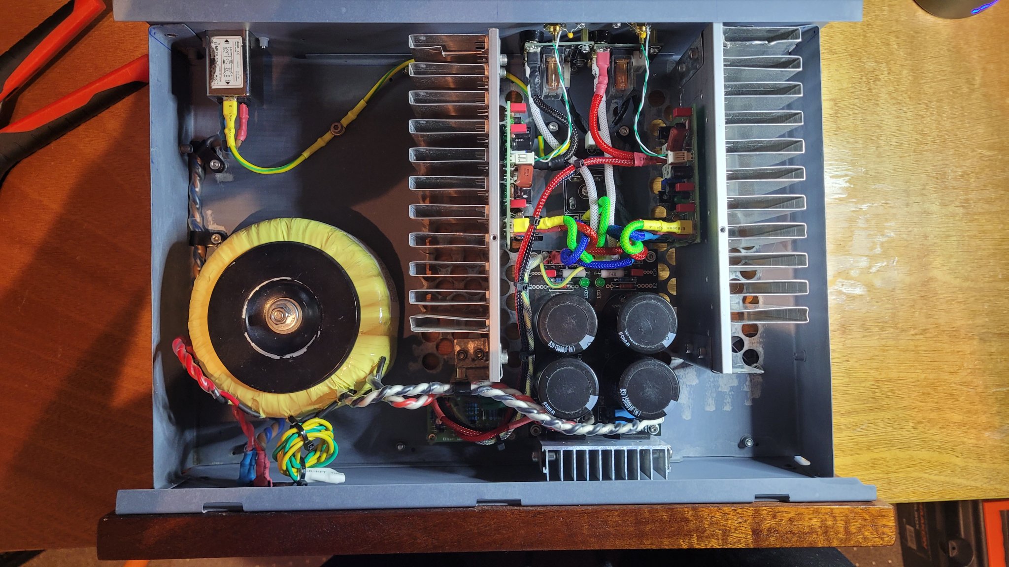

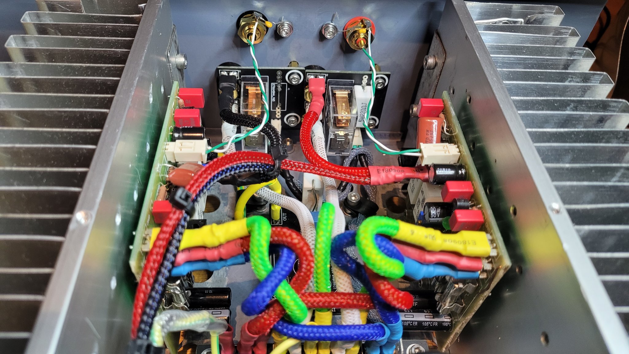

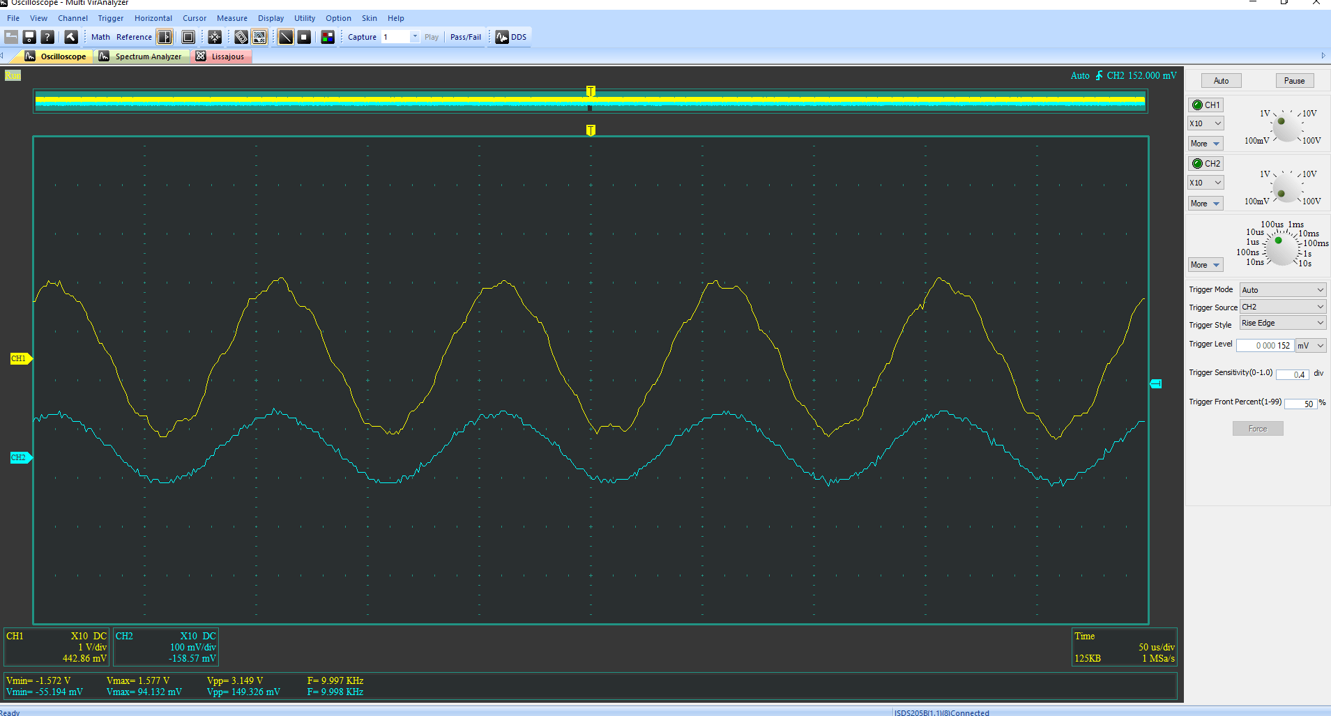

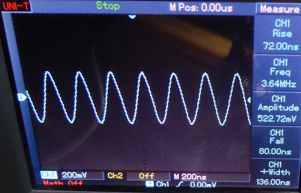

G'day Guys,

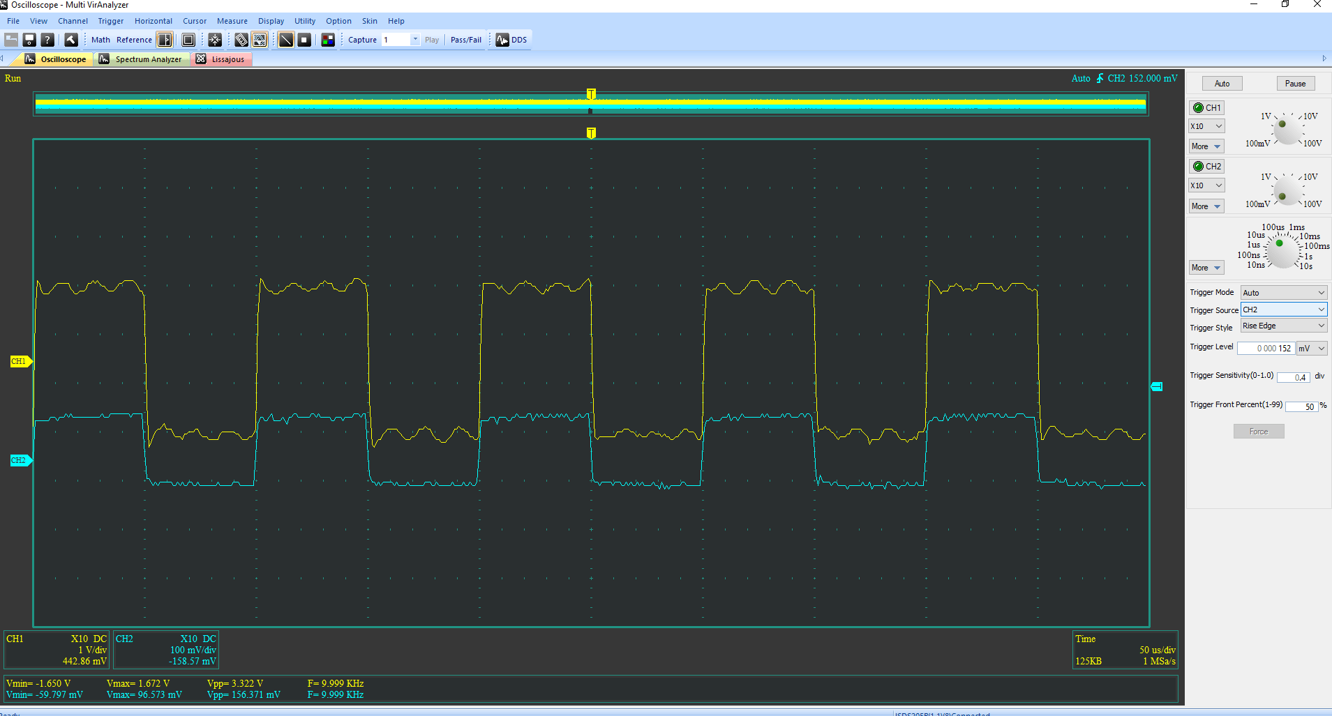

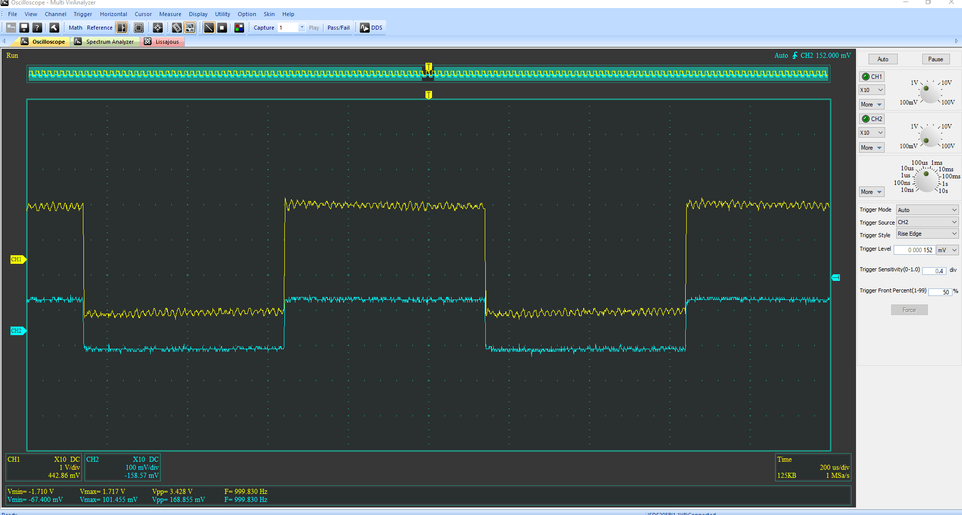

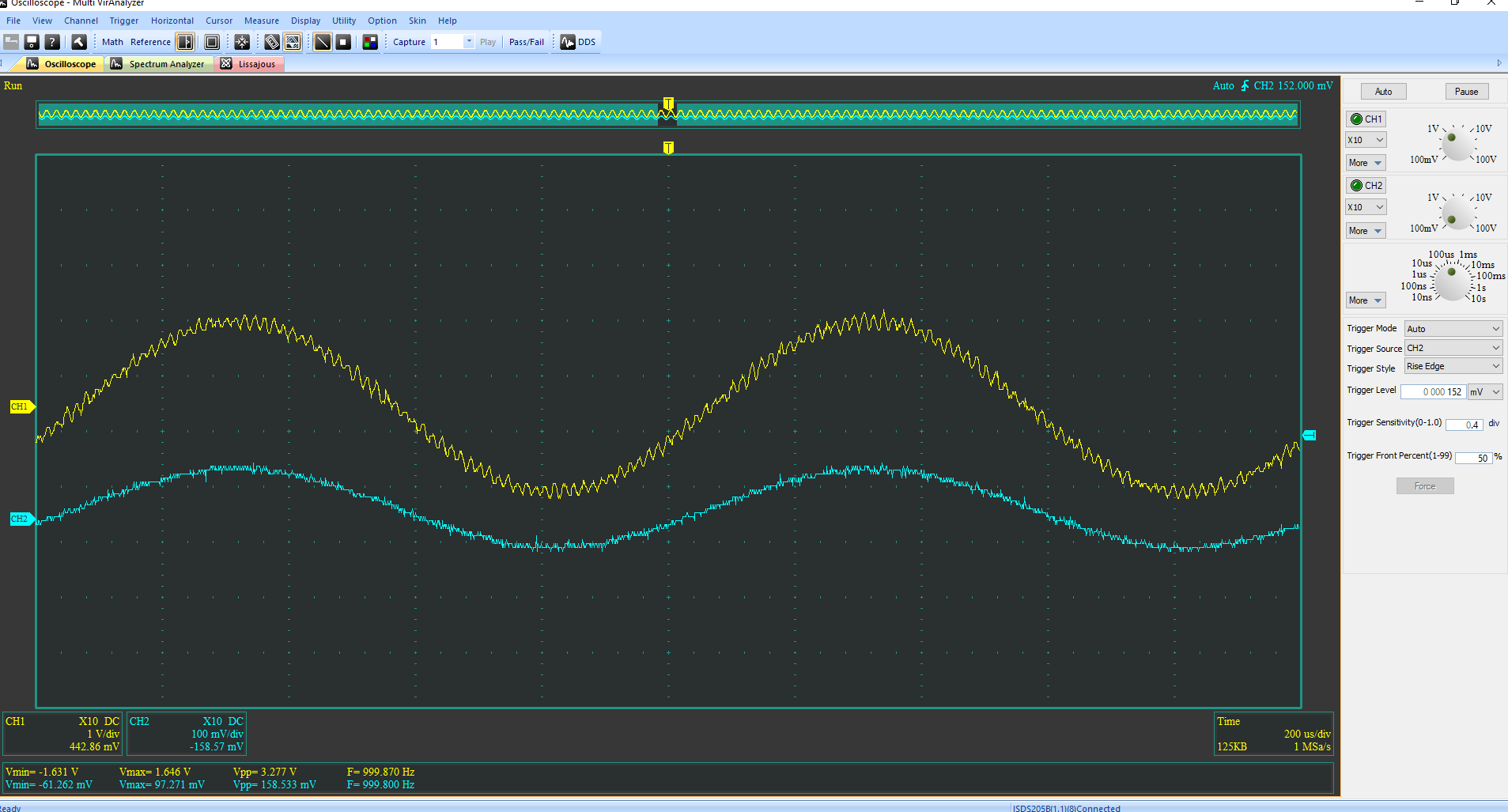

I have finished putting the P3A into the new chassis.
During the process I removed the 100nF cap across the bias spreader Q9 as testing had shown this gave no improvement.
My square waves now look a bit better on a 4R load. The overshoot is now gone.
The sine wave still seems to have the same old 'grass' on a 4R load.
The 10k sine wave looks a bit odd but I think the blame on that goes on the sig gen.
A quick count of the peaks gives 13 peaks within a 200us division.
200/13 = 15.38
1/0.00001538 = 65019 Hz.
Which is exactly what somebody suggested earlier in the thread.
So I still have a bit of oscillation to deal with.
I will ponder the next step overnight however right now I am tempted to try the suggestion of Tombo and slide some ferrite beads over the legs of the emitter pins on the driver transistors Q5/Q6.

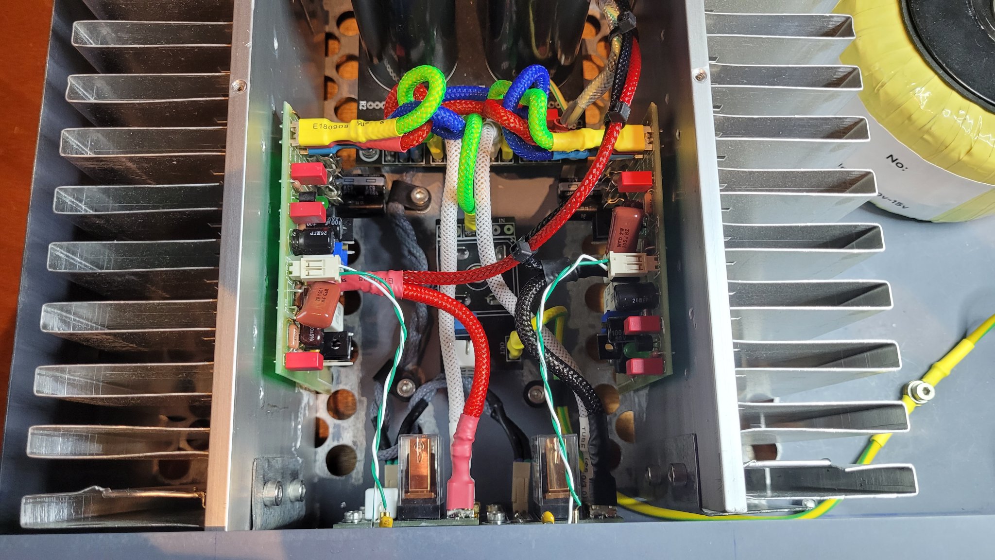

Your dc protection circuit is close to your inputs where output radiated fields will be present. Your input wiring ought to be upgraded to something with better shielding. You will have to dismantle some of your work to put a ferrite bead on the emitter leads of Q5/Q6. In practice your signal control point has to be in series with Q1 base lead which is where a ferrite bead should be deployed. You can put that at the end of the new signal wire at the point where this connects to the input terminals. Microphone cable has better shielding properties as there is a braid covering 4 available wires- you can use this for external cables.G'day Guys,

yesYour dc protection circuit is close to your inputs where output radiated fields will be present. Your input wiring ought to be upgraded to something with better shielding. You will have to dismantle some of your work to put a ferrite bead on the emitter leads of Q5/Q6. In practice your signal control point has to be in series with Q1 base lead which is where a ferrite bead should be deployed. You can put that at the end of the new signal wire at the point where this connects to the input terminals. Microphone cable has better shielding properties as there is a braid covering 4 available wires- you can use this for external cables.
use for example RG 316 - cheap and big enough to solder.
Your input signal has an additional parasitic high frequency component present. To me it looks like this is being amplified along with the desired signal. At least you are making some progress. If you short the input to ground what do you see on the output when no load is connected (CRO trace picture)? What driver and output devices are you now using?The sine wave still seems to have the same old 'grass' on a 4R load.
