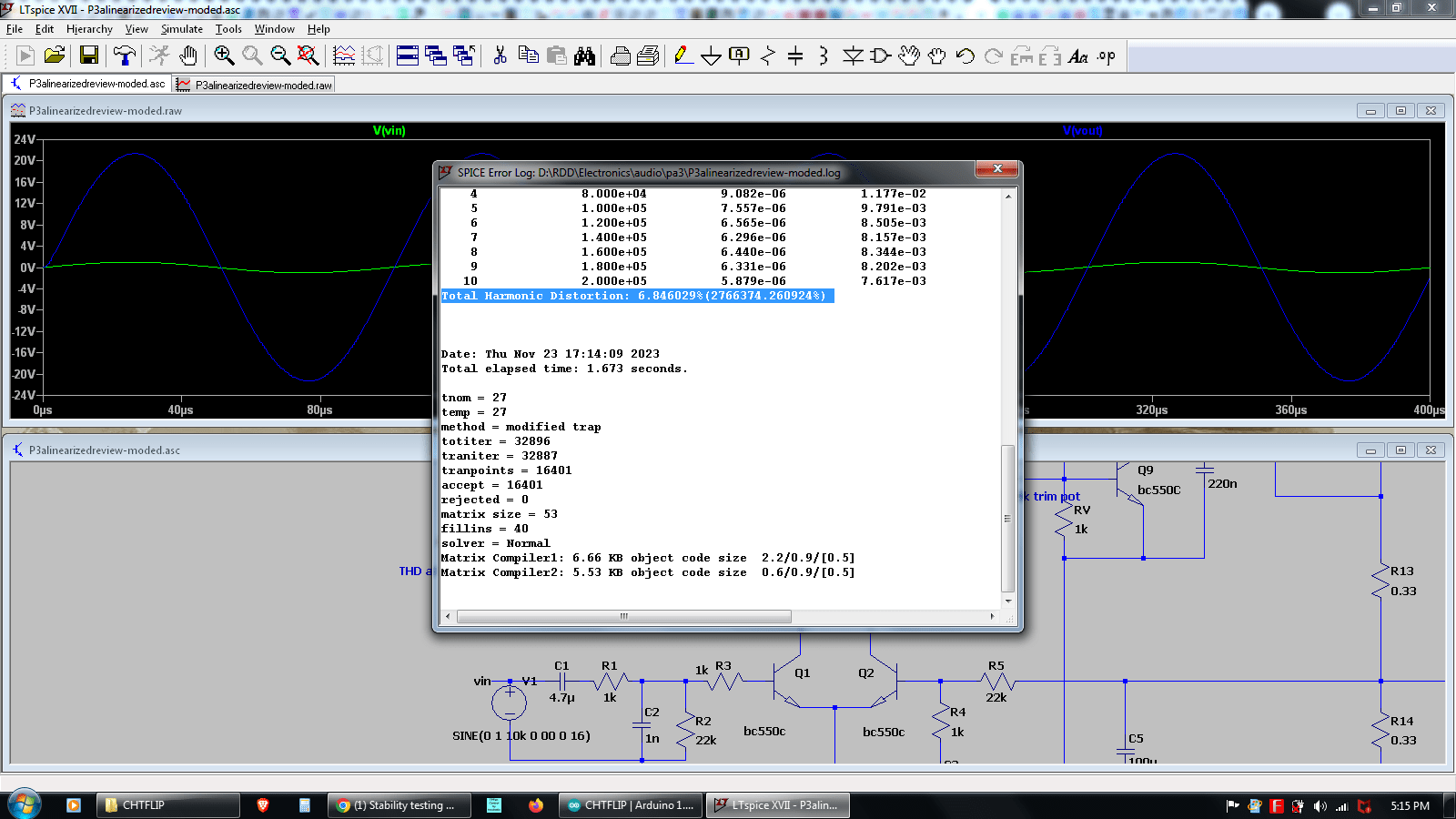

I changed the vin to 1v and the freq to 10khz.
And this is what I got very high THD off 6%
Im just trying to see if the 70 watts output is possible on 35 volt rails with 1 volt peak to peak as per original design of Rods.

To measure distortion at 10kHz you cannot use the script for measuring 1kHz distortion. I don't have that for 10kHz you can find how to change that by looking a Mooly's tutorial on setting up and using LT Spice on this site.I changed the vin to 1v and the freq to 10khz.

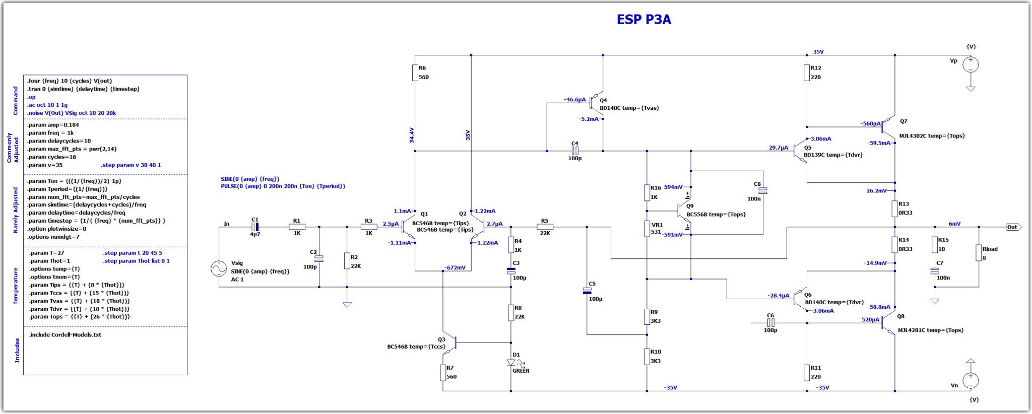

Here is how I run sims. Several others on this forum do it in a similar way. It uses parameters for amplitude and frequency that adjust the settings to produce the THD and FFT data.
For the max_fft_pts param, I use pwr(2,14) when adjusting the sim (runs faster), and then increase to pwr(2,18) if I want a better FFT plot. If you want the FFT floor slope to settle, you'll need to replace the electrolytic caps with voltage sources. Or run the sim for a VERY long time (by increasing the delaycycles). Mooly discusses this in the LTSpice How To thread.
This also include estimated junction temps for the semi's with a param to run it hot or cold. You can use this to see how offset and bias are affected by temp. You can also use the step function on the supply voltage to see how voltage fluctuations affect the sim.

I'm showing the schematic as designed on the ESP website. With the exception of small the VBE cap discussed on this thread. On Rod's site, his pages on "Power Amplifier Design Guidelines" specifically states that the P3A "hates inductors".
However, it you read these pages, you can see that he goes back and forth on whether the design can benefit from it. But, this current design has been in use for decades in this fashion, so to say it MUST use an inductor is simply not true.

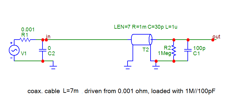

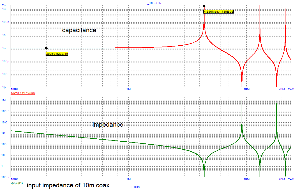

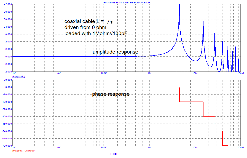

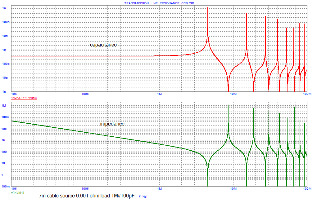

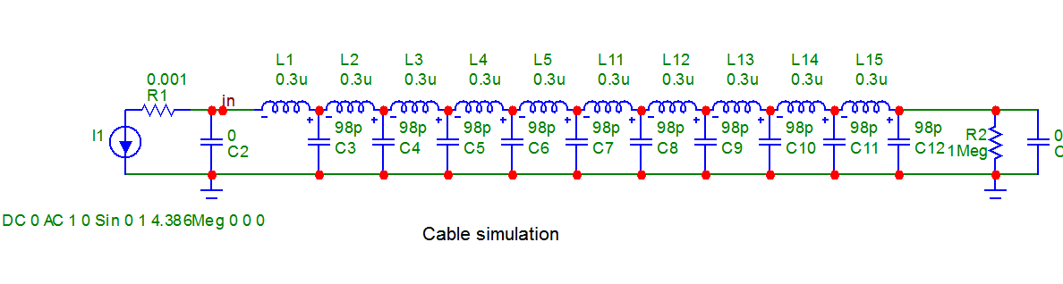

Most simulation end at the amplifier output terminals. Knowing that cable has levels of capacitance per metre has a bearing on results. My low inductance cable, by Supra has 0.15uH of inductance per metre. A reasonable length say 2.5 metres, is 0.37-38uH.There is no circuit design reason for the amp to “hate output inductors”. Have you tried a range of capacitive loads 1nF - 1uF? Is it stable? It is important not only for the reason of cable simple capacitance, but, at high frequencies above 1MHz the cable driven from low impedance (amp output) and almost open at the other end (speaker inductance) has impedance that resembles a comb profile, with capacitance maxima in uF order, this may drive some amplifiers crazy resulting in unexplainable failures.
I simulated this in Spice on the previous page in post 396 showing 10kHz square wave with cable inductance in series with the load of 8R//2uF.
I have not drawn up a Tian plot simulation.
