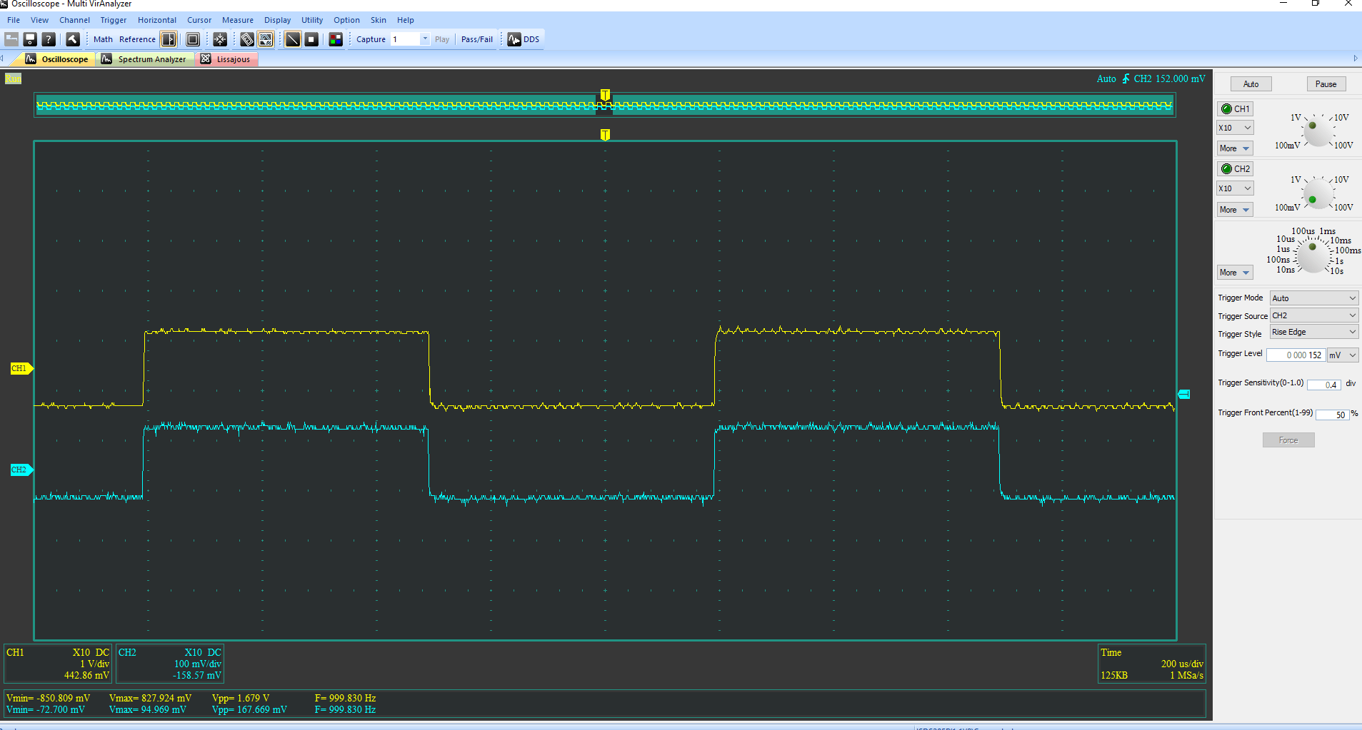

So if I am understanding you correctly:With square wave input you have to look at the rise time on your scope that is from zero to the top of the scale where it flattens out. The frequency involved for rise time is in inverse proportion to this
Fortunately square wave is not representative of music what one has to consider is the rise time of the wave form as the nominal 1kHz is 1/t the same applies for 20k square wave. The instantaneous frequency on the vertical scale is much greater than 1kHz on the horizontal scale. It the output is low say 4V peak for 1W then the rise time will be lower than for say 20V peak for 25W.
There is another stability measure to apply know as settling time at the peak of the wave along the horizontal axis where the wave form should recover from any anomaly within a specified time of no more than 10 uS.
If you are seeking to drive your amplifier into low impedance loads at high volume levels, I noticed that Rod Elliott's Class A circuit was virtually the same as the present one with additional output transistor pairs. From other designs with similar output powers as yours I think that the safe operating area of a single pair of output devices is not sufficient for your intended use if my previous comment is true.
on the 1kHz square wave the time from the 0v cross to the peak of the square wave appears to be:
200us scale divided by 5 subdivisions = 40us per subdivision.
I count 33 pixels per subdivision: 33 pixels / 40us = 1.2 us per pixel.
From this I see the rise time on the positive going half of the 1khz square wave to be 2.4us from 0v to the 1.774v peak.
I don't quite follow what can be inferred from this? Slew rate?
The settling time is a bit hard to decipher due to the noise on the square wave trace. I've stared at it for a few minutes and its not obvious what is the settling of the overshoot versus the general noise.

Rise time is measured from 0 volts to the peak of the square wave on the horizontal time base. Slew rate is the voltage measured on vertical axis at 1us on the foregoing time basis.Plugged it in this evening.

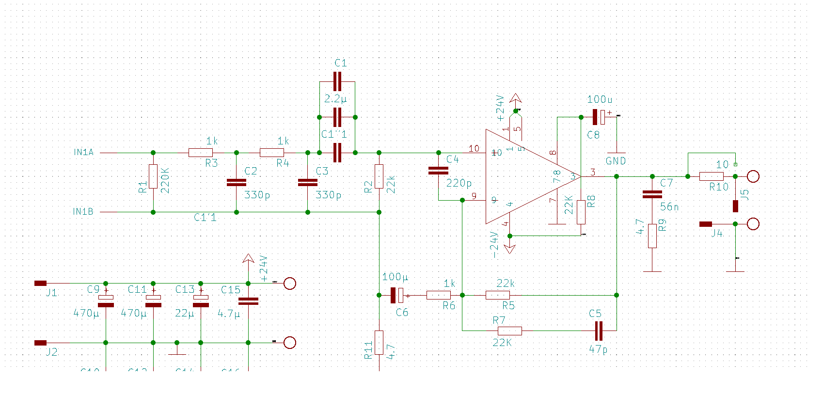

G'day Guys,
I did a bit of testing on my old LM3886 power amp that this build is supposed to replace.

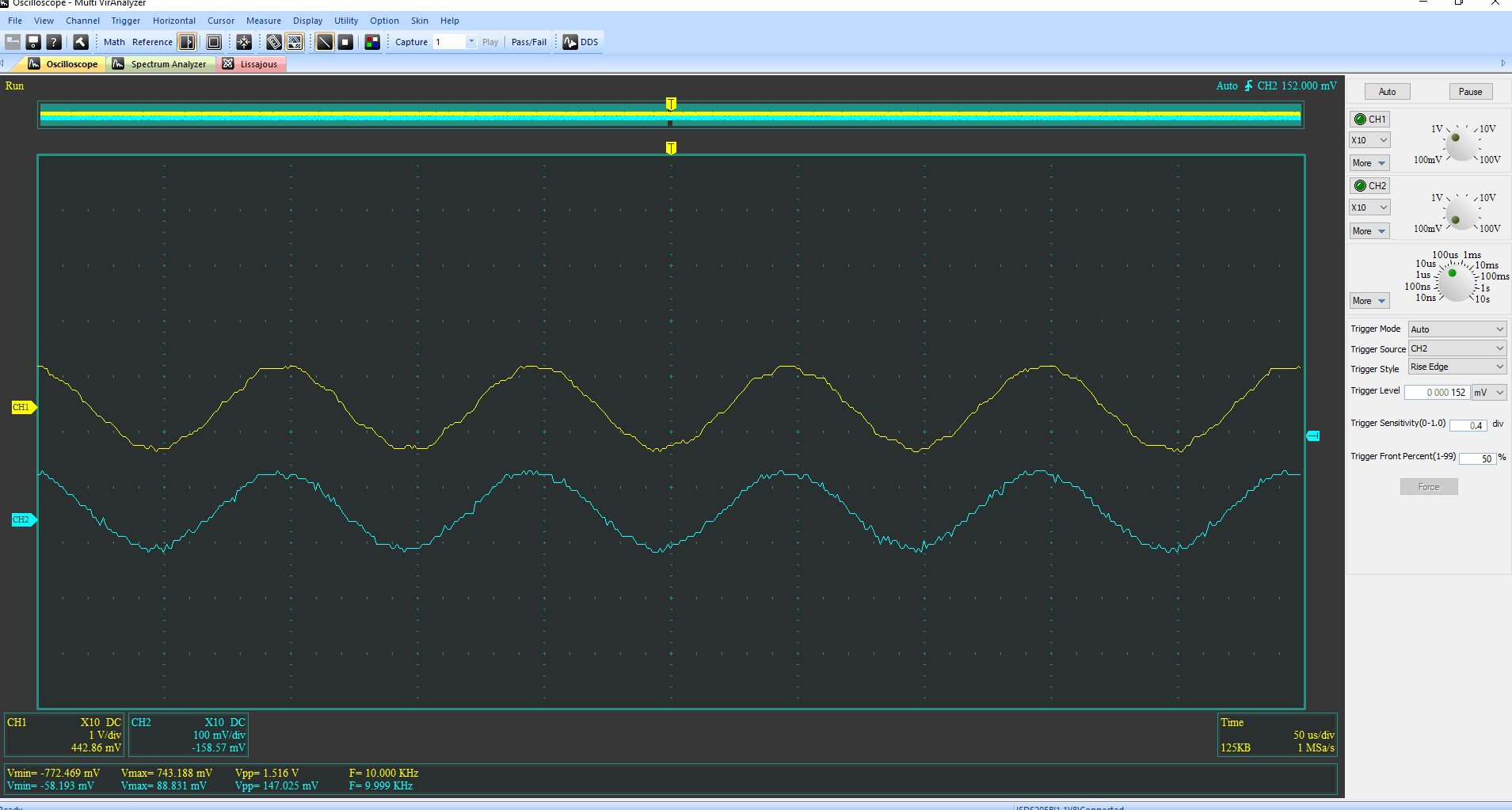

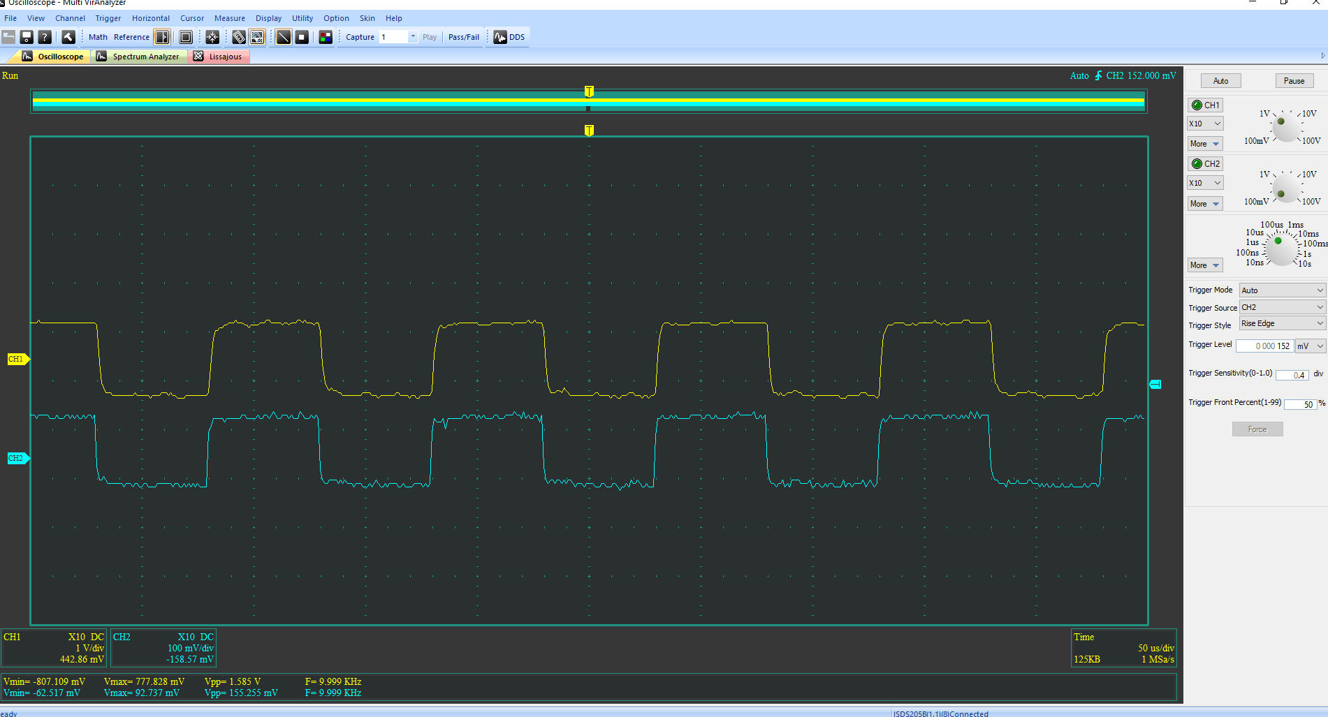

The square waves are much cleaner looking on this amplifier, I only went as far as a 4R load and established that the messy square waves I am getting from my P3A are due to the P3A and not the test equipment:
The sine waves look the same. Square waves are much nicer looking.
Here is the schematic for the LM3886 board:
I notice that the input filter is more aggressive.
I think the next step for me is to increase the value of C2.

My unit gives nice clean square waves upto 100 Khz. No coil on the output. The Zobel resistor did get hot.
I need to repeat the tests without the Zobel. (100nf and 8 ohm resistor). Its good that you compared another amp. I have had issues with the scope, my probes and with my body introducing signal measurement issues.

The filter is a multi stage one with a higher roll off slope for frequency input. Normal single pole filters roll off at 6dB/Octave = a slope of 0.707. The one in your old LM3886 will have a higher rate of roll off that allows higher frequencies to pass without compromising stability. The square waves are better than you could expect with normal filtering because of the sophistication of the chip and the structure built around it. I like what I see in this as a model to work with - of course not possible with out re-designing your P3A.G'day Guys,

Your tests have been done in the raw without consideration of such items as a volume control and speaker cable. The former can add series resistance unless a low stage buffer stage is used at the input. I think Rod Elliott expected a higher impedance in series with the P3A input and some inductance in the speaker cable.
I have simulated the P3A with multiple parallel cap values and while this was stable in previous simulations as I believed to the sufficient given experience of others who have built this amplifier, I did not go so far as to test lower parallel capacitor values which I know will have higher resonance frequencies which will therefore be more challenging of circuit stability. I was prompted to check lower values by comments in post 465 by PMA which has substance.
There is no scope to modify your input low pass filter to emulate the LM3886 and I believe you are using a low output impedance buffer ahead of your input. In that case your only option is to increase the value of C2. You can solder some test values to tracks under your pcb however I think you will end up with a value of around 1nF. The other thing you could do is put your test load at the end of the length of speaker cable you intend to use and put your scope on the load attached to the far end. As there will be some inductance in this some ripple will be observed which is normal. If you then put the probe at the output of your amplifier you should see a clean square wave. Don't fret if this has some rounding.

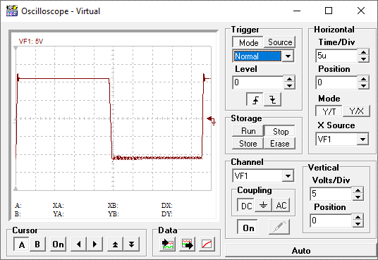

I have a P3A that was oscillating on the rise around 0V and fall just before the negative peak when I left the power transistor leads long. After clipping them, the (rather large) parasitic oscillations went away, but I shelved the amp for a while thinking it must be pretty marginal..original P3A

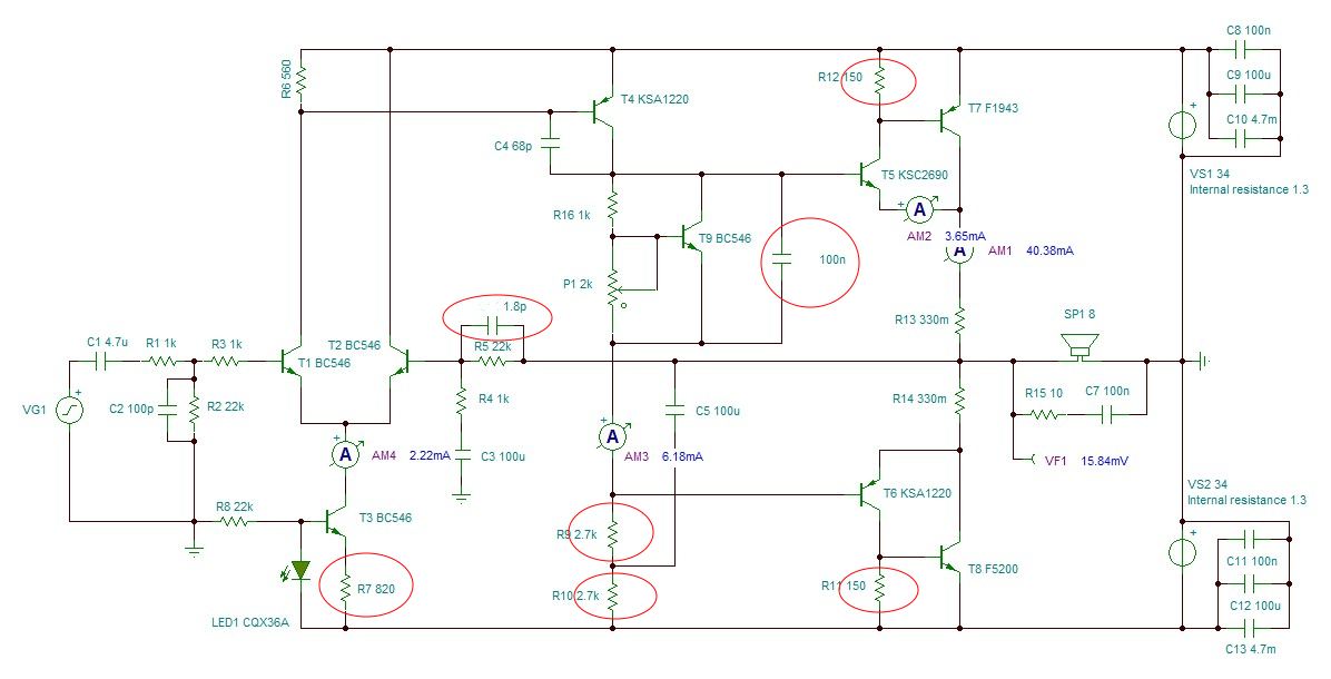

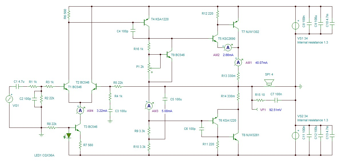

AM4 diff current too high 3.22 ma
feasible too high with no degen.
AM3 second Gain stage.
Marginal low current 5ma
Should be closer to 6 to 8ma
AM2 driver transistors
Marginal current 2.66ma could be closer to
3 or 4ma
VF1 DC offset 92 mV = bad

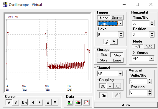

Look familiar? = Ringing Oscillator
Just removing C6 reduces the ringing, pretty much pointless part
causes more problems. Still not stable. So lets try to fix it

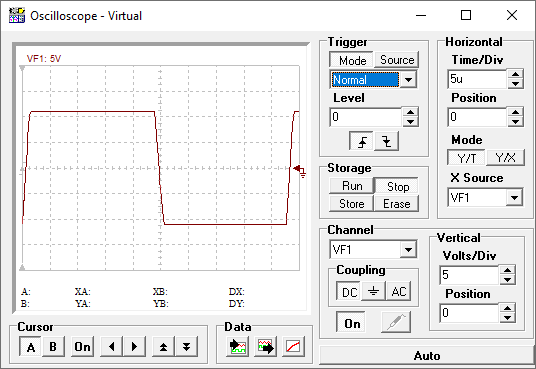

without redesigning the whole board and with just value changes
To fix DC offset raise R7 to 820 ohms
lowers current from 3ma to 2ma and helps to stabilize the amp
since degen cant be added.
Lower bootstrap resistors R9/10 to 2.7k
Raises current from 5ma to 6ma.
This changed DC offset from 92mV to 15.8 mV
vast improvement.
Improved stability greatly.
100n needs to be added across T9
and removing C6 contributed the most
to actually stabilizing the amp.
C4 can possible be lowered to 68p to improve
high frequency slew rate.
If the the amp is still unstable add 1.8p across R5
Lower R12 and R11 to 150 ohms to increase driver current.
from 2.66mA to 3.66mA
This will help keep bias from being sky high or way at the end
of the pot travel. If bias still to high at way end of the pot
you can even go lower to 120 ohms
No ringing, feasible DC offset
My Adcom amplifier started making a buzzing sound (the amp itself, not heard through the speakers) yesterday, so I took that out and put my P3A on the bench.
I applied your changes except for the 1.8pF lead compensation cap. Ran the amp through some simple tests with an oscilloscope and my phone as an audio source. No signs of oscillation. Installed it in the living room. Sounds great.
Wish I could do some THD measurements but I don't have the equipment. Thanks for the tips.
