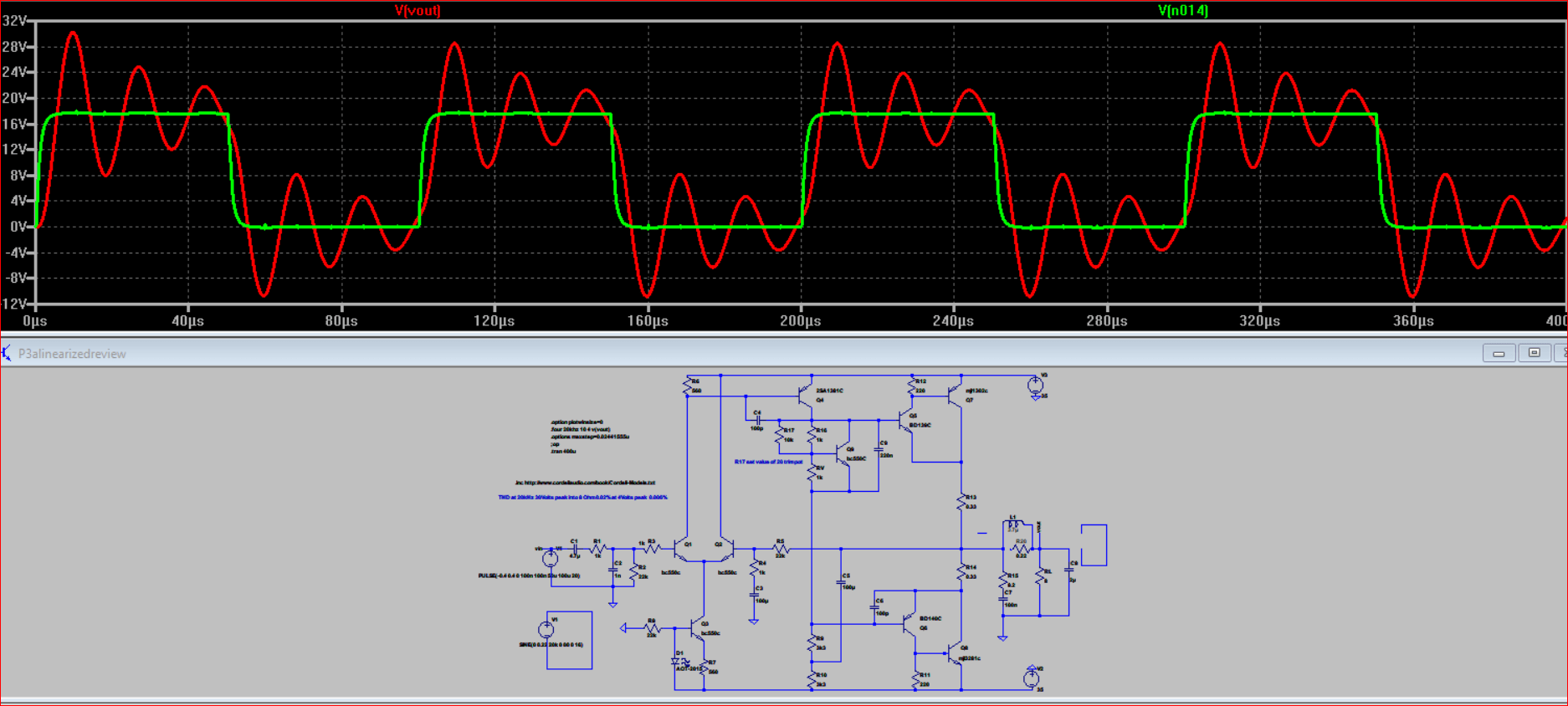

The phase shift will start a decade in frequency below the -3dB point 0.707 of the input signal at 15.9 KHz.What is the rational for increasing C2 to 1nF? This drops the input pole from 1.59MHz to 159KHz. Lower still if the source impedance is high. If the objective of this is to block high frequency interference, then it seems to already be adequate at its original value.
Phase shift will also arise inside the circuit and a phase margin of 45 degrees will be needed as well in the interests of stability.
The value of C2 suggested is for low impedance input sources. If a volume or balance control set up is included at the input that changes the situation
Apart from the zobel network there is no coil to stop out of phase signals entering the rear barn door. The output leads could be twisted to add some inductance however that can be a hit and miss.So your ears can hear 159kHz? Remember, that's the -3db frequency, not an absolute cutoff point. This amplifier is like a barn, with the doors wide open. It'll pick up all kinds of interference. 1nF is a more appropriate value. Most source impedances are in the 50 to 100 ohms range.
The output terminal has an input function where signals are received from the load and from mother earth as an input and additionally an output for back emf from earth. If a 0.22 Ohm resistor is put in series with the output where this is in common series with the driver emitters.
This will to increase emitter feedback to vary the base voltages of the drivers. These will receive the same level of signal behind the buffer resistor.
There is a small level of non-linear resistance in emitter junctions. In series with a linear resistor the voltage drop across combined resistances is more linear overall. In effect the non linear element is swamped out.

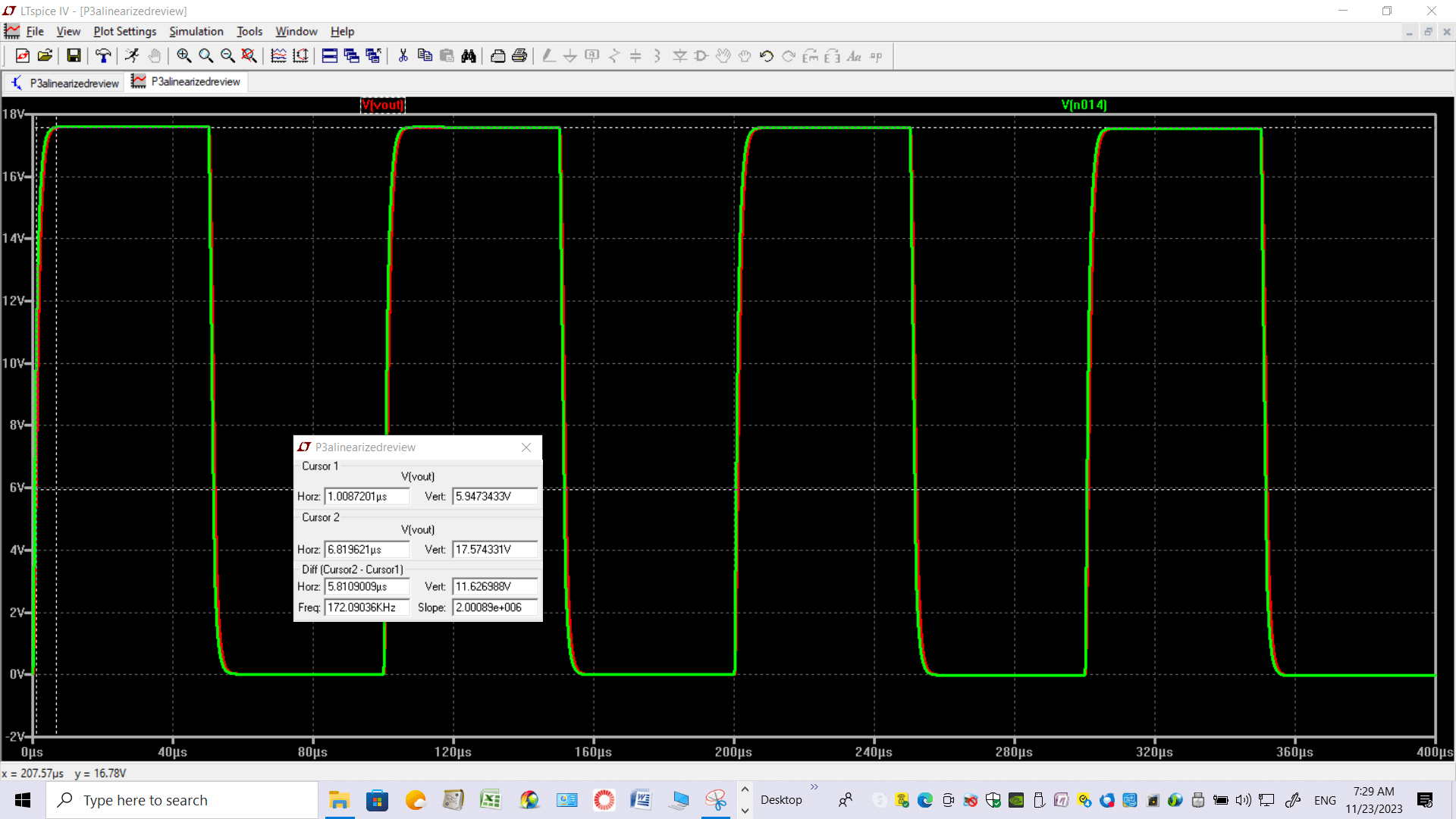

In simulations this makes for stable square wave results with capacitors in parallel with speaker loads. It also allows reductions in capacitors C4 and C6 with the 30 MHz output transistors.These dont need the same values than might be required for 4 MHz outputs.
Common emitter amplifiers with collector to base capacitors multiply the set value of these capacitors and these increase the load and time required for Q1 to drive Q4 which slows that process down reducing slew rate performance.

The early P3 designs included an output coil this one does not. I think Rod Elliott has a mindset of keeping thing simple and saw that the inductance in speaker cables could give the same result and so this was not included for P3A. One can look up specifications for speaker cable to work out values.
It was only when I started testing on the scope that the issues started." For 'scope tests into a dummy load you do this up close on a bench. In life however speakers are connected to the amplifier via cables which are part of the circuit.

The inductance of a length of 2.5metres will be 0.375uH and sufficient for stable results as I have simulated. If one feels a must need to run bench tests on square waves then twisting the internal lengths of speaker cable may give a similar level of inductance to the exterior cable length.

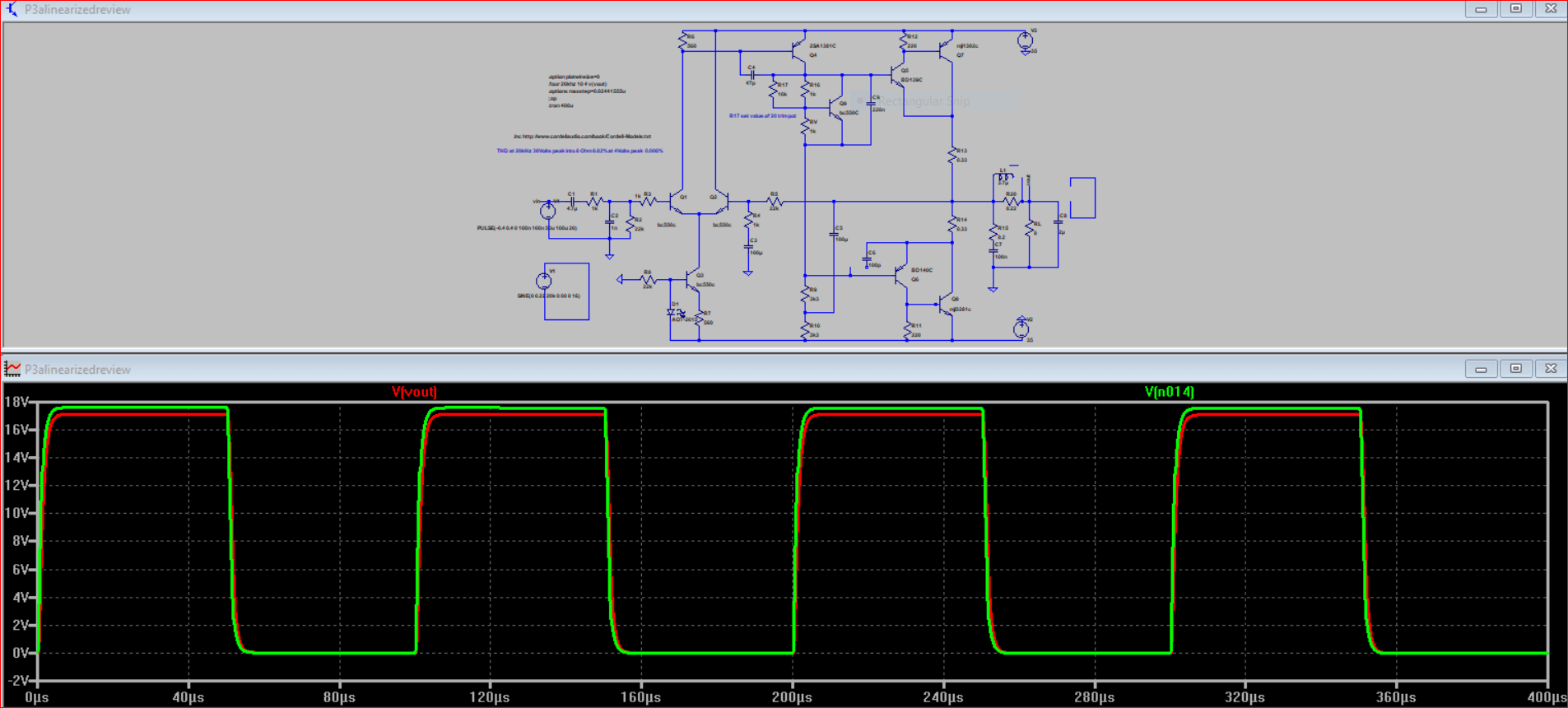

Anyway back in post 382 I suggested including a 0.22 Ohm series resistor at the amplifier output. I took some trouble to give reasons for this but nobody took this seriously. Note changes in capacitor C4 and C6 in the second attachment and the lack of notches in the top of the square wave at node 14.
Since square waves are not representative of music these notches might be inconsequential in practice however these bear some resemblance to the grass Sadface scope tests, that he is hoping to nullify.

The file is attached as the link to Cordell models is shown anyone can download Spice and run the simulation. Rod Elliott has given a list of suitable output transistors with varying unity gain specs and a one size fits all set of stability capacitors.
Sadface opted for the high spec devices which allows other capacitor values to be used. I looked at reducing the value of C4 to take advantage of these specs. When C4 is reduced the slew rate of the Vas transistor can be increased since load on the base of Q4 will be reduced. Q6 base has a similar load which causes a lag response for the bootstrap collector load which is a helps the main Vas however the improved unity gain of 30MHz devices allows a single dominant pole at the Vas to suffice. A suitable low pass filter is needed at the amplifier input to ensure the signal is within the slew rate capacity of the Vas - otherwise the result will be slew rate limiting and spikes on square wave tests. The attachments for slew rate are without the load having parallel capacitance.
You can change the BC550/BC560 transistors in the simulation. I have a good supply of these but they are better used in lower power amplifiers so BC546/BC556B would be a better choice here.
