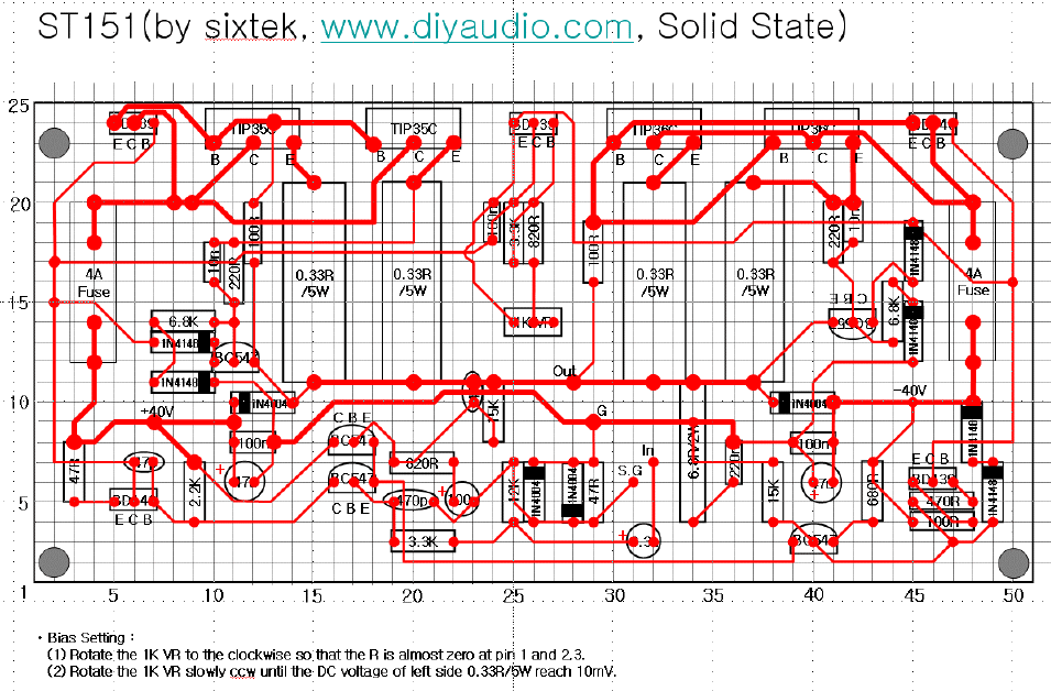

"ST151" 100W amplifier
0.3mm diameter is only 0.07sqmm, that is tiny for output currents.
0.45mm is only a little larger than tiny.
0.6mm is 0.28sqmm and even that is pretty small. I would use double 0.6mm for power lines and outputs. AND keep them short.
Are the 0.3 or 0.45 enamelled?
Then grouping them into bundles of 8 to 12cores may sound quite nice if the claims made for insulated multicore are to be believed.
UEW thickness problem.
Thank you AndrewT.
By surfing the net, I found the following (refer to http://elm-chan.org/docs/wire/wiring_e.html).
0.16 or 0.2mm dia UEW is equivalent to 0.5 or 0.9 mm width printed pattern.
Considerring the pattern thickness of general pcb(0.035mm), I think this is almost correct.
So, 0.3 or 0.45mm dia UEW is equivalent to about 2.0 or 4.5mm width printed pattern.
If my calculations are correct, the UEWs I used are not thin compared to the pcb by sixtek.
Anyway, I'll keep on testing and monitoring what happens to my ST151.
Thank you so much.

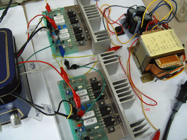

Testing...
Testing with just normal volume level.
So good until now.
Amp not connected, the voltage is (+,-) 32.10V
When the amp is connected and turned on,
the voltage is dropped to (+,-) 31.42V.
Does this means that the transformer should be larger
or just ok?
No serious hum.
Thanks, AndrewT.
I don't know about the quiescent current.
Could you tell me how to measure or calculate it?
I just tried to listen to the hum with source just stopped
at min. volume and max. volume.
There is only a very little hum at max. volume.
Everything is just fine until now.
Sound is also very good than I expected to be.

As sixtek said, I set P1 so that the voltage drop
over one of the 0.33R resistors is about 10mV.
After the amplifier warmed up, it reads 10.9mV.
Somewhat higher but I didn't adjust again.
I calculated and got 33mA for that registor.
Then, 66mA will be the quiescent current as you said.
Nice built, Cantabile!!! universal pcb very professional!!
"2. As you see in the pictures, I used general and cheap parts.
OK with the parts? Or are there some unsuitable parts?"
- in brazil is not so general parts!! hehe!
I´m glad to know that 1943/5200 transistors works fine on this amp. I will test.
And, one more time, Thanks Sixtec!!!
