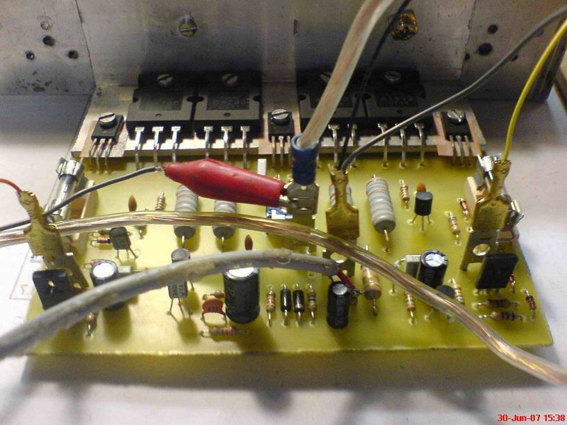

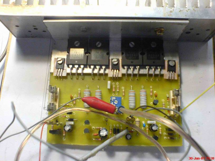

Another ST151
Hi Sixtek
I found my problem with my amp. The amp is working fine. Sounds great and very stable. The bias current is set to 10mA(9.8mA). My supply is +-49V DC. The outputs are 2SC5200/2SA1943. Working okey. Tested it for about 1hr driving 8ohm load and still okey. Busy with my second channel. See photo's below of completed channel. Thanks for this amp and design. Will keep you posted.

some of our amplifier experts here suggest (strongly) that Vre should be between 15mV and 25mV.
D.Self also goes for near 25mV for an Emitter Follower (EF) stage.
If you can keep your amplifier cool enough it might be worth trying this higher range of bias to keep out of the ClassB distortion region.
Pity your PCB prevents you mounting the output devices direct to the heatsink.
Since you use the aluminium angle for indirect mounting, I suggest you use at least 5mm thick aluminium angle and preferably nearer 8mm when the leg length is that long.

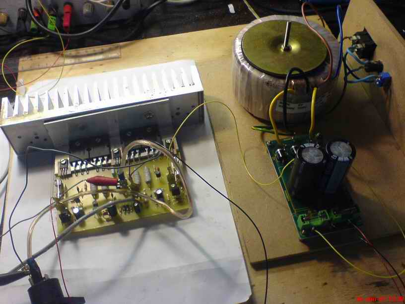

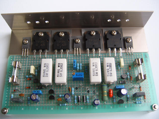

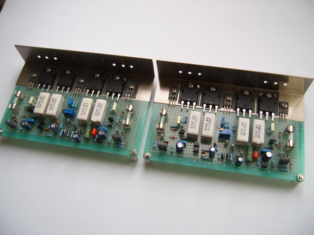

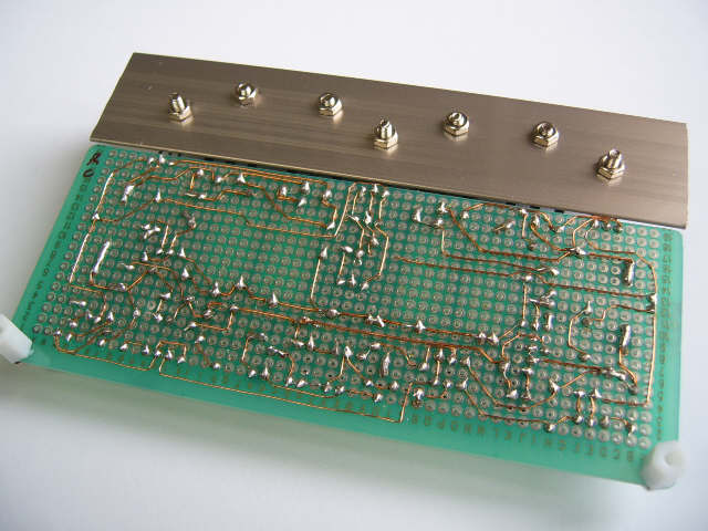

2 channels built. Testing...
I built 2 channels on the universal pcb and testing with +,-31V.
I used pots at the input(100k A type).
TIP35C, TIP36C, BD139, BD140, BC547, BC557 are used.
No serious problems by now but I have some questions.
1. The sound is somewhat small. Is this by the low voltage?
Then, I will get a transformer and test again later on.
2. As you see in the pictures, I used general and cheap parts.
OK with the parts? Or are there some unsuitable parts?

I have another question.
The pop noise is somewhat large when power is on.
Is there any simple solution?
Simplest solution - connect speakers through a relay that has a time delay on switch on. You can also add to that a DC-Protect circuit should the amplifier ever fail.
Only one comment on your PCB's - the wiring used for the output transistors looks a little thin.. better to use some thicker wire for this, or 2-3 pieces of your point to point wire twisted together.

I used 2 kinds of wire thickness.
According to the sixtek's diagram( http://sixtek.uw.hu/st151_beult.pdf ),
0.45mm UEW for the power lines and the output transistors.
And 0.30mm UEW for all the other connections.
They say that 0.30mm UEW is actually more effective
than the leads of the normal resistors and capacitors.
Anyway, is your recommendation
"2-3 pieces of your point to point wire twisted together"
means that I'd better twist 2 or 3 of my UEW lines together and
use that for more thickness?
