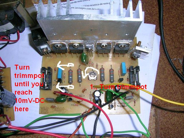

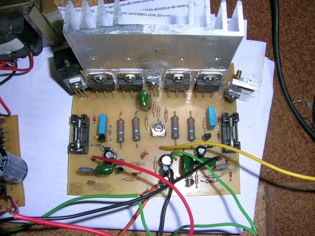

I finished to build amplifier ST151. My problem is in relation the regulation of the bias setup. I know that trimpot 1K regulates the bias on the amplifier. How to make the measurement and adjusting to the value?
The amplifier works fine, but the transistor gettind hot in short time(1~2 min.). The speaker is a behringer monitor1c, impedance is 4 ohms, perhaps because this, but i really think that if i let the amp at full power more than 5 min, the transistors will dead.
See the picture of my amplifier!
P.s: in Brazil, good capacitors is expensive$$

Thanks for posting the image. Nice built!
Bias adjustment:
1., before turning on the amplifier adjust the 1k trimmpot to maximum
2., then turn on the amp, and let's measure the voltage on one of the 0.33 Ohm resistors. slowly turn the 1k bias trimmer to reach 10mV on the 0.33 Ohm resistor.
Good luck!
