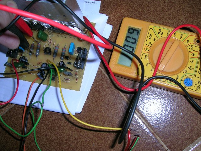

How does the bias setup runs? Everything is OK now with your ST151?
How does it sounds for you? Are you satisfied?

I used one old supply, trafo 24V and 4700uf per rail, 70W rms is enough loud!! Heatsink is small, i will get another.
The bias setup, the dc oscillate around 10mv, (8mv, 10mv, 9mv, 11mv), is right???
doubt: another amps need a inductor before connect the speaker, in this amp is needed?

Hi Dedepc,
I'm happy to hear that your amplifier runs fine.
Small sltering of bias current (8-11mV on the 0.33 Ohm) is not problem. Anyway I hadn't observed that.
No, the ST151 is stable without Thiel-network (Thiel network = paralel 1-5uH inductor and 1-20 Ohm).
