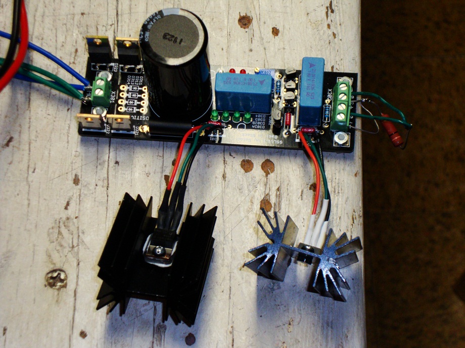

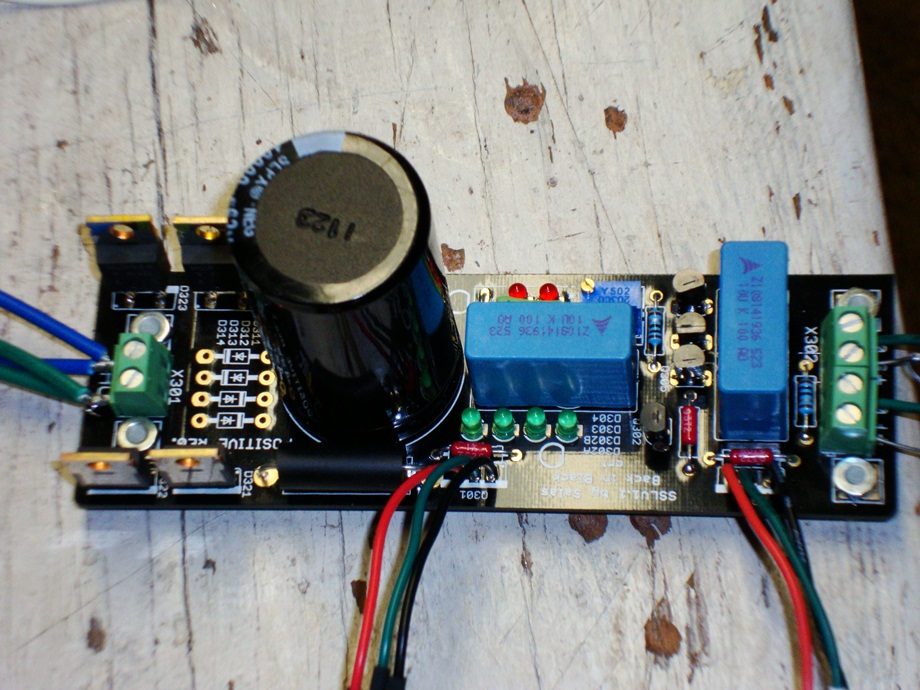

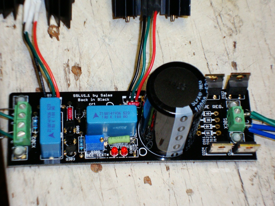

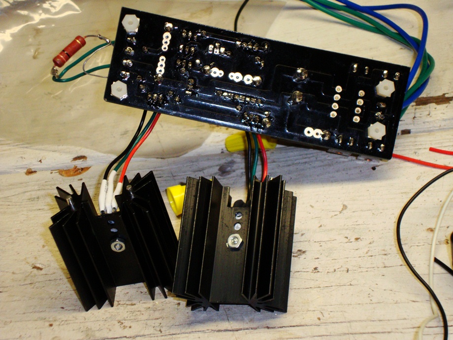

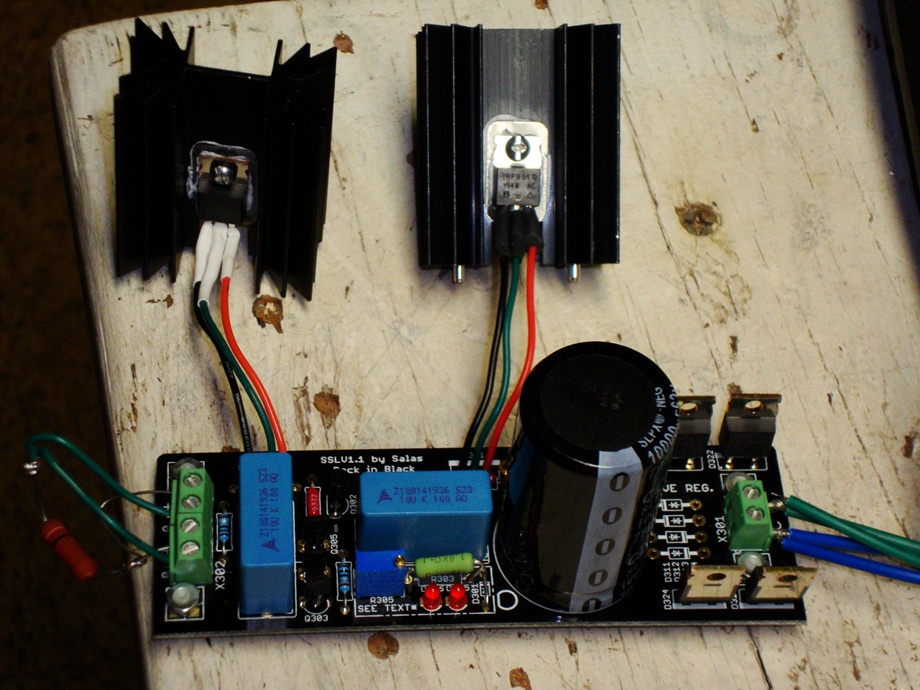

Here's my build - pretty standard, 18V is my target. I'm using a 24V transformer, but I only get 3.8V at the output, and adjusting the trimmer doesn't have any effect. All the LEDs light up, and all the right parts are in the right places. (The trimmer is in backwards, but it doesn't fit the other way and it shouldn't make any difference anyway, as long as the wiper is in the middle.) There's about 293mA through R101 (10 ohm), about what I was aiming for. However there's a 25V drop over Q101 (R101 to output) and only 0.1mA through R103, neither of which seems right to me, though I don't know what they should be. Q101 gets pretty warm after a bit but Q306 doesn't. Other voltages: 0V across R102, 115mV across R108, 3.8V over C102, 0V over Q103, 0V over R106. 24.8V over Q102. Can anyone help?
First you got to get rid of the cables to the Mosfets. Only local PCB fit. You got wrong shape sinks for easy side or bottom fit I see.
