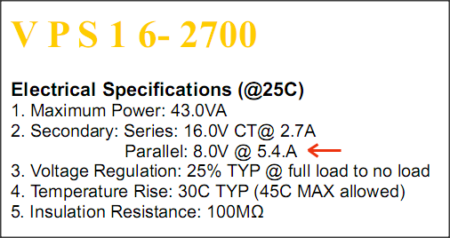

I have replaced the heatsink with the other one full contact on back. It still gets very hot. I unplugged it after it hit 240 F. Dummy load does get warm. The transformer I am using is a Triad vps16-2700. Could that cause this?
YesDo you connect F+,S+ at one dummy's lead and F0,S0 at the other?
Is IR9610 CCS Mosfet as hot? And what is the AC voltage on PCB's trafo connector while working?
Salas,Is IR9610 CCS Mosfet as hot? And what is the AC voltage on PCB's trafo connector while working?
I am sorry it is the IR9610 that is hot, the 9530 is about 109 F. AC voltage at connector is 18.35 V.
