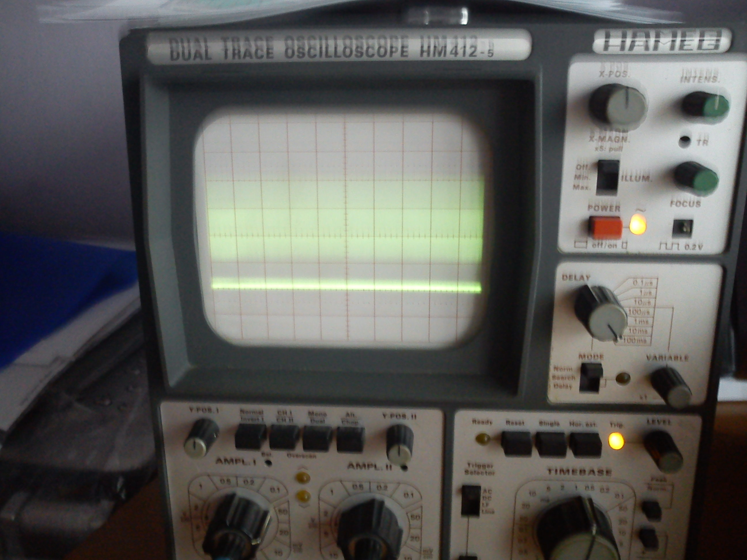

That's the proper line, even on real active circuit load.
What was the vertical (volt/div) knob's position George?
Didn' t notice, because I put the scope on AC. The line on the scope doesn' t change as I rotaded it though.
Supply voltage is 17V.
Transistors, Jfets, inspected for proper type proper place odd mistake too?
Yes old mosfets, JFETs inspected and are all OK in both regs.

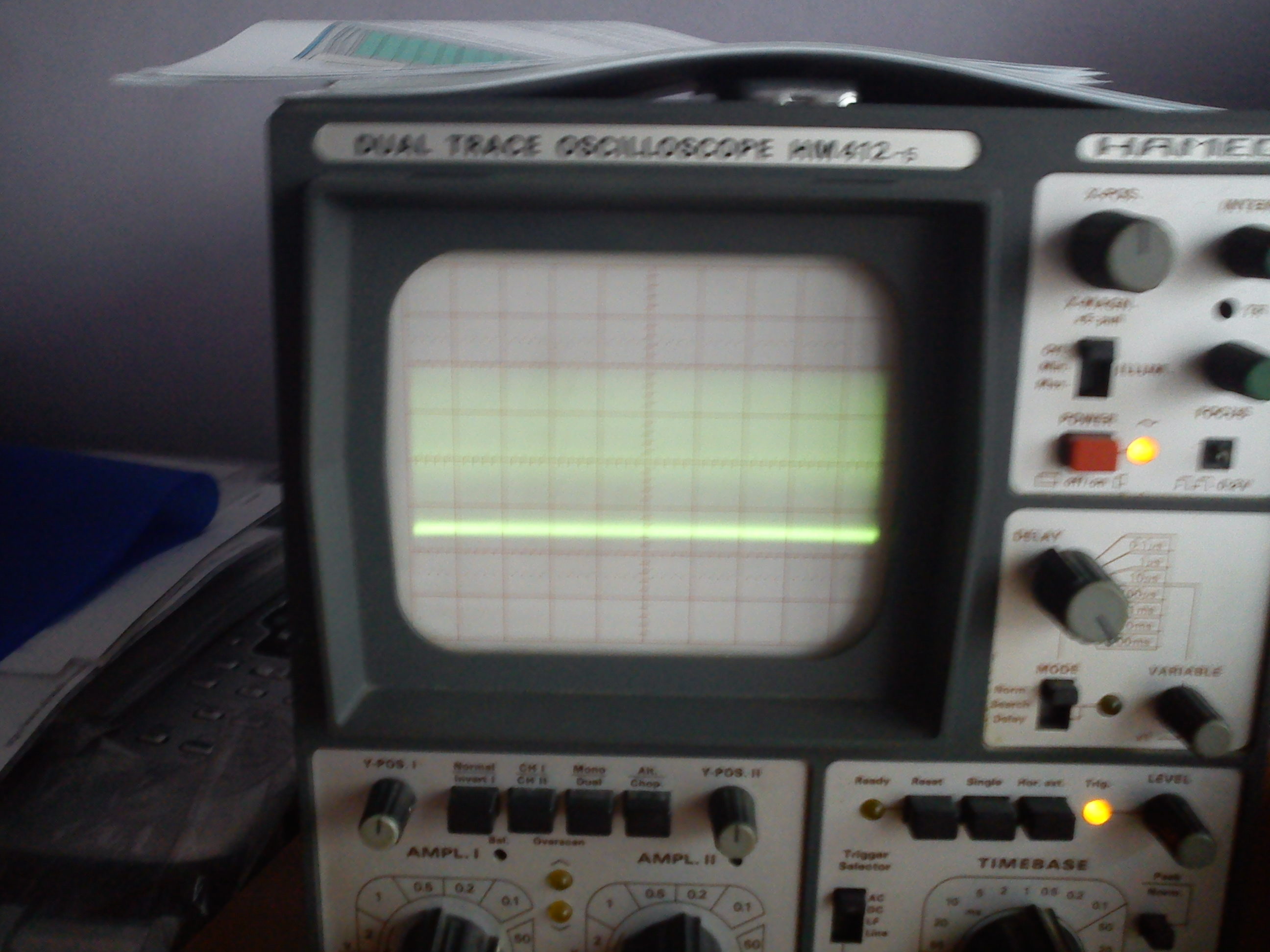

Left channel negative rail with 100uF BG NP + Zobel 1R added
Try MKT.
Felipe, once I put a sk117 in the place of 560 and it worked, but had some issues, as far as I remember. Took me some time to figure out. So, please check for stupid mistakes like this.
FYI, I use 4,7uf MKT at the output

Thanks George, verified I have both 560 in place in both regulators.
Salas I change to 10uF MKT & check.

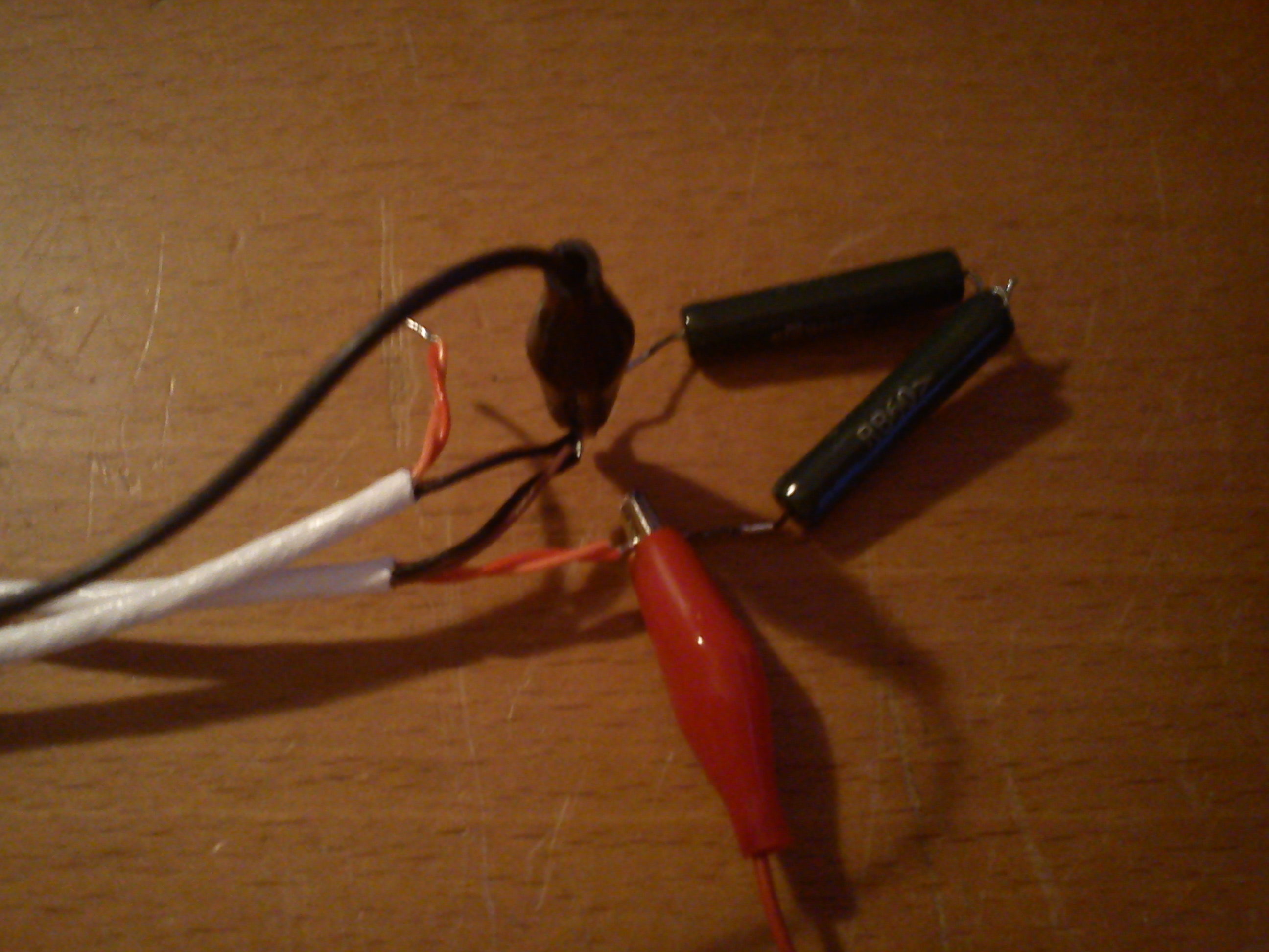

What's different or wrong between your negative and George's smooth line negative? Any clear picture full length from above and under? Also picture of wires to dummy?Left channel with MKT
