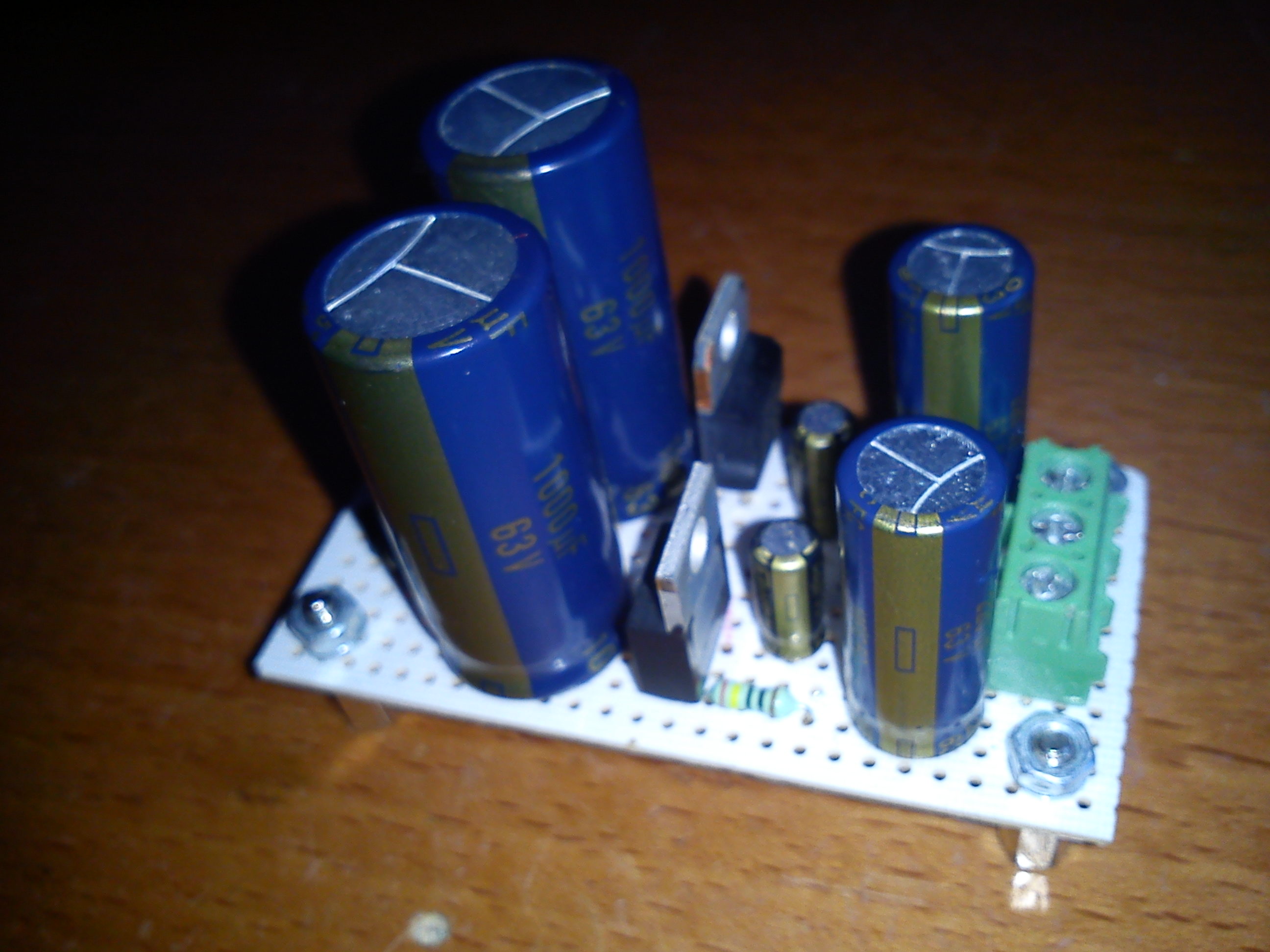

Salas I forgot to tell you that the NP D1 I/V only sounded with voice without presence or deep with the BiB and when I increased the volume I heard a little of hum, whit LM317 + LM337 sounded good no hum, any idea what happens? I tried 10uF MKT & 220uF lytic as Vref also zobel 10uF MKT+1R & zobel with 47uF lytic & without R?
Don't know, it can be the wide PSU bandwidth not helping the particular circuit. Any PSU is in the total current loop. Use whatever helps better a specific circuit. I don't know the analysis of the particular one to speculate more, not familiar with it. Hum beyond ground loops or ripple is also a sign of instability many times. Its either you can fully scope it and measure it and compensate it to play great with this reg or just skip it if it demands beyond simple experiments with parts you feel confident to perform. Or you can persist on trial & error.

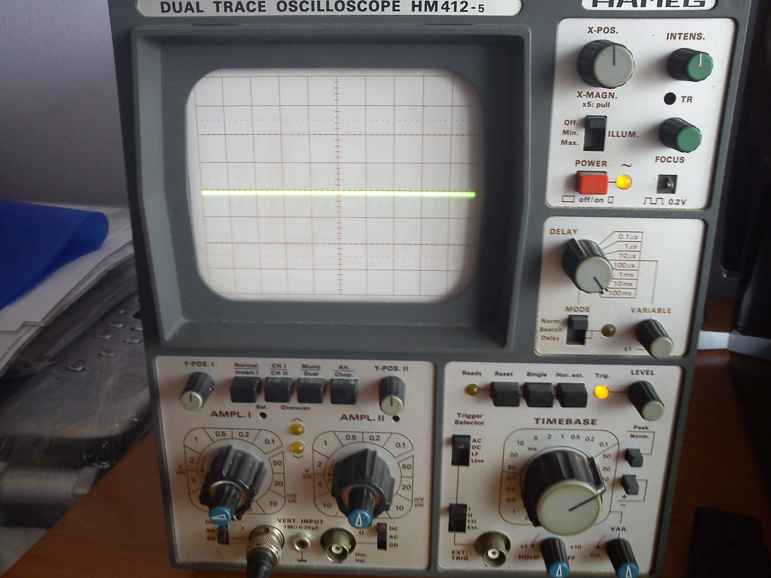

Put your scope on the reg to I/V power rail in ac mode input and post a picture. If its a matter of bad interfacing it should show weird patterns or spikes instead of simply a line. In general if so, a 100uF cap across sense only locally on the reg, kills it.

The scope I will try to do it. The 100uF cap across sense only do you refer the cap connected the positive leg to sense positive & negative leg to negative sense, right?

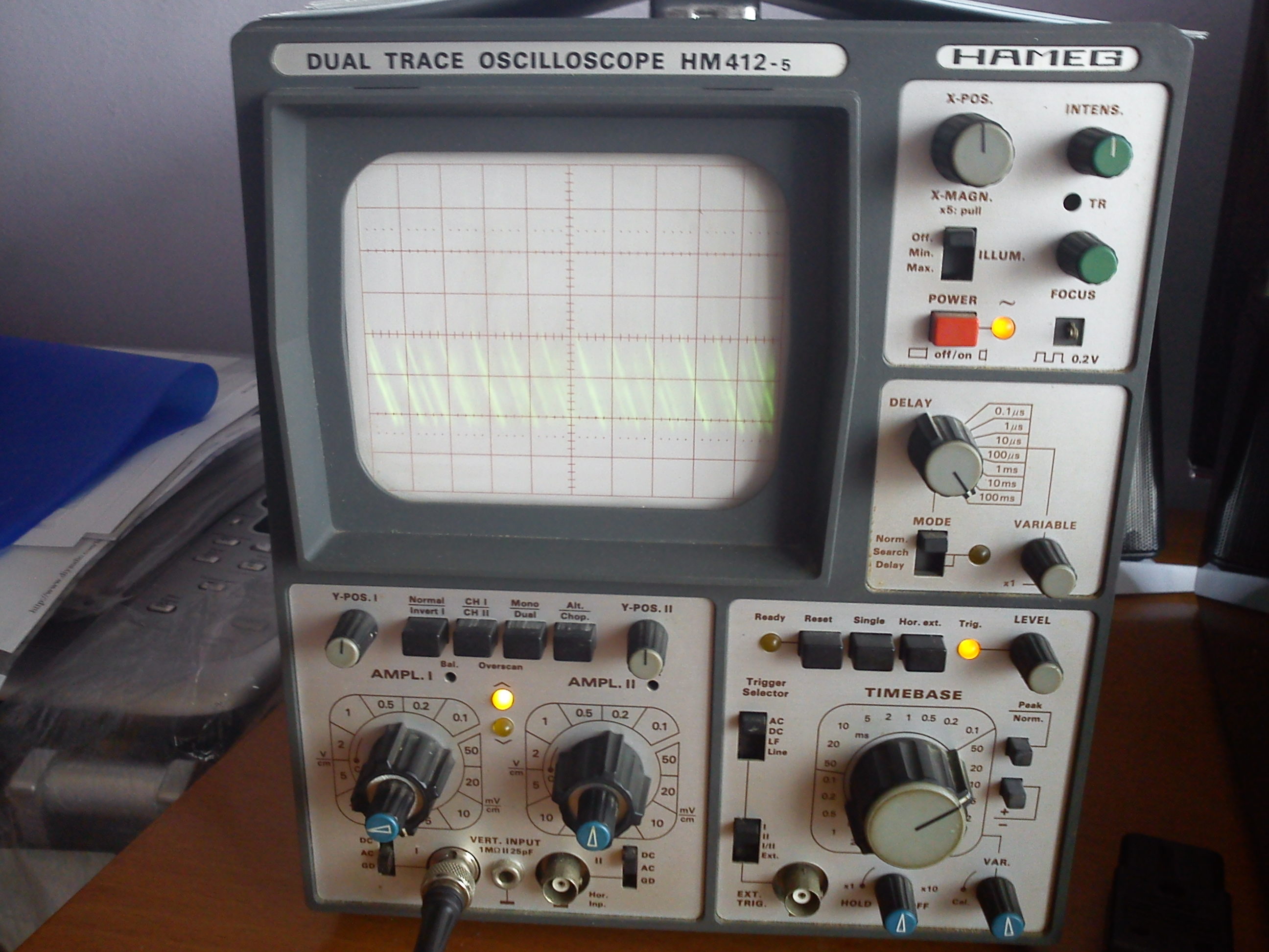

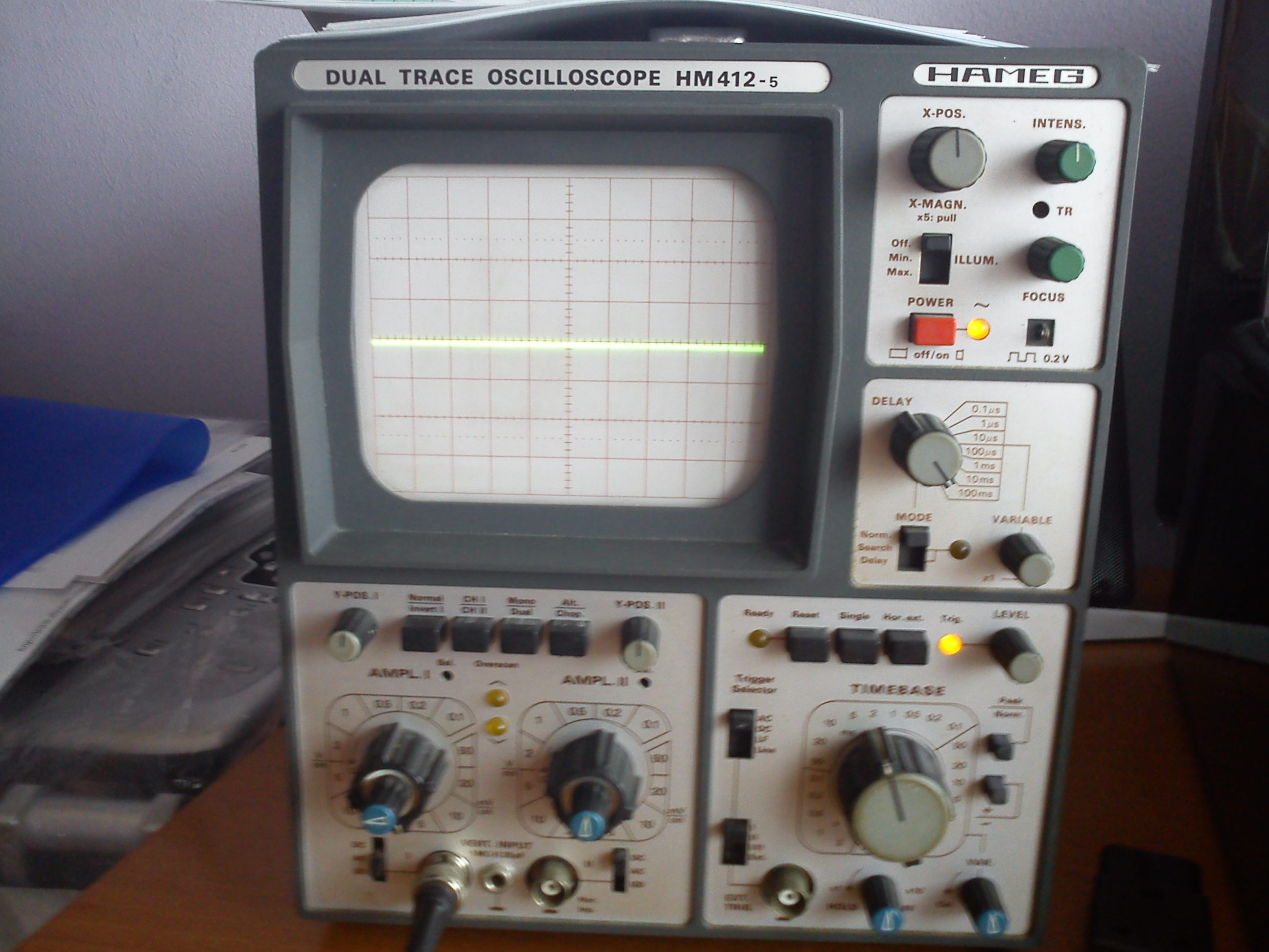

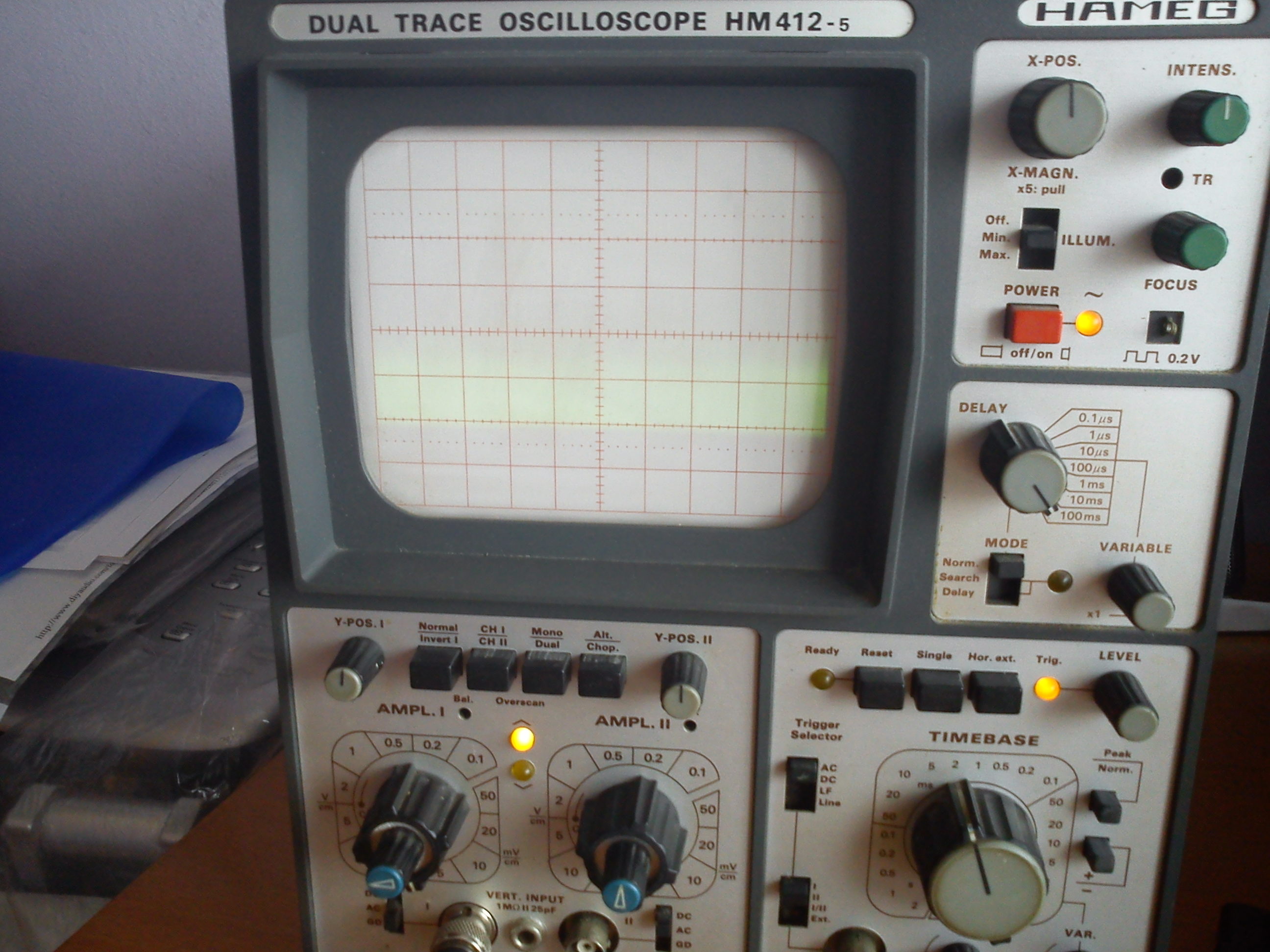

Left channel thin line positive rail big line negative rail
Salas I'm sorry for the bad measurement is the 1st time that I use the scope so I need guidance thank you for your patience.
Thanks George could you check that the scope is in the right position to do the AC measurements?
It must be the button on the lower right of the scope and is set to AC for the left channel - the one you use - so it looks OK.
I would put the negative on the scope with a dummy load to see if you still have oscillation. If no, then you should look further down, maybe your cabling or something.
