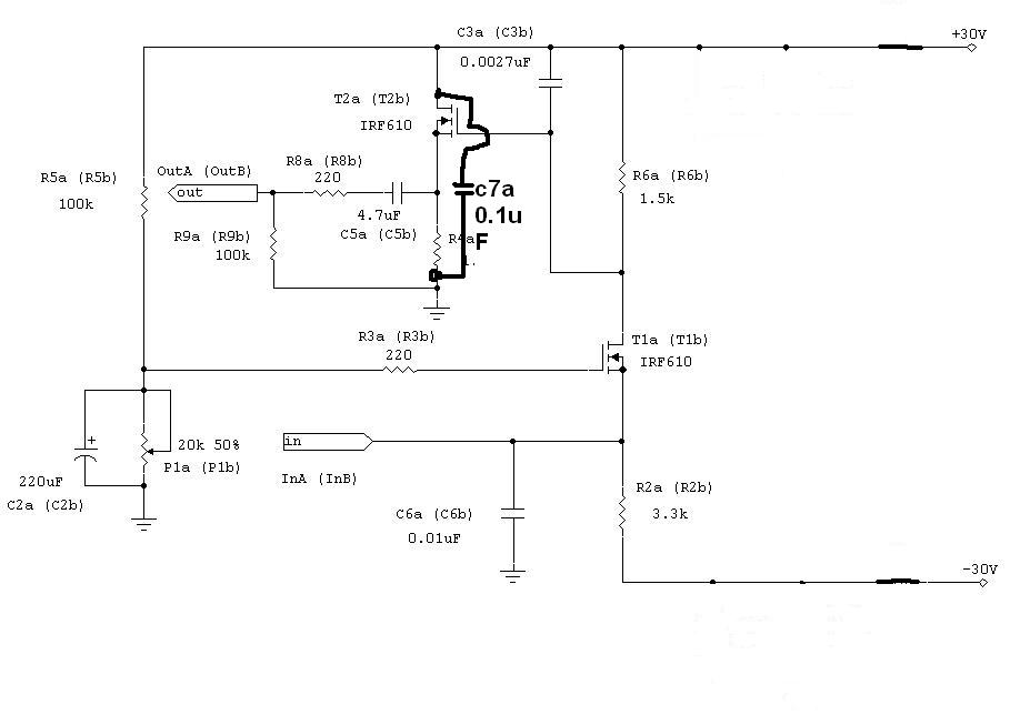

If the regulator outputs are located exactly on the amplifier power inputs then the local MF & LF decoupling can be dispensed with.
You can design the two PCBs, PSU & Amplifier, to stack bottom face to bottom face to get as little as 2mm of lead length (a solid copper link) to make best use of very short lead lengths and very low added inductance.
I am not so sure the HF decoupling can be dispensed with, I suspect this is still required across the main output device, i.e. right across the output device, T2a Drain PIN to R4a GND PIN.
C7a is shown in the wrong position on the schematic. C7b may be near useless in it's present location.
Your proposition is like the attached schematic?
If you do that you will probably have oscillation problems with the reg. You should keep the buffer in-line resistors if you will do that.
what value of resistors? 0r1, 1r0? Not 10r.
How do we find 0r1, that are 2mm long, to place between the two back to back PCBs?
1R suffices to buffer the 0.1uF from strongly affecting the reg's zobel, saving from shorting phase margin drastically.
