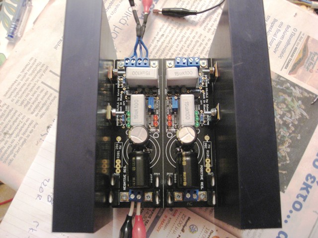

Just finished two +-15 Vout regs. On the negative reg, i have difficulties to reach 450-500mA CCS, now voltage across R201 is 0.67V for R201=1R8. This is 370mA CCS.
Can i safely go for lower value R201, or something's wrong?

Its not wrong, the 610 usually has more Vgs than the 9610. Since you are at low Vo, dissipation isn't a problem for the LEDS JFET, so jumper the 47R R208 with a crock clip is the easiest first step. It will allow full IDSS so to see if your now LEDS can go a bit stronger, before you might look for happier ones or change R201, etc. Low dissipation on Rset bcs of small Vdrop is a good thing. We will just see to set it in a manageable manner.

If it's safe lowering R201 value to get desired current, this is great. No problem putting a smaller value resistor there.
R208 shorted, voltage across R201=0.75V
R208 non shorted, voltage across R201=0.67V
R208 is there to protect the Jfet's dissipation for the total Vin to Vout range. In your 15V case shorting it is safe, and gave something more (416mA), but as you see, main thing is IRF610 and Leds. If we had 4 leds, most lower current settings would create much Vdrop to make resistors too hot, but it would be easier to choose values in higher current settings especially in the negative. I wonder if there are LED makes of say Green 2.5Vf easy to get so we recommend for when things get tight.

There should be some happier Vf generic ones in the shops by chance if someone looks with the DVM on diode setting. There is also the odd blue one to mix which is high Vf, but I would be hesitant due to they are invariably noisier. What Vgs your IRF610 has at that current? One member had a 4.7V reading at about the same current region for instance.
If you are speaking about my measurements, they were with 4.7R resistors, because the departure point was about 2V, nothing like 1.49 or 1.1V. (In fact I have ordered lower values to test, but I suspect that it could be difficult to arrive to 400-450mA and 600-625mA for buffalo+tridents almost impossible with this configuration)
I´ve tested with theoretically yellow 2.4V Leds, but the reading for this strings (3 Leds) is also 5.7V, I don´t know why.
Good, manamanam. Guys, are you sure those DACs actually draw so much? Did anybody put a DVM in current mode and in series with one rail? IRF610s look like rising Vgs easily, and there are ways we can kick our Vref difference to Vgs, but is it really needed, or too much will go on sinks?
