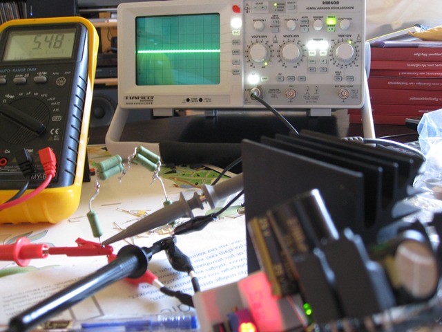

First 5.5V out build is working!
568mA CCS, 30mV voltage drift, perfect clean output, no oscillations.
I noticed when tuning the CCS resistor, that the voltage across it is more with bigger resistor values and less with smaller resistor values.
For example:
12Ω resistor, 1.87V
2Ω2 resistor, 1.25V
Is this normal?
For example:
12Ω resistor, 1.87V
2Ω2 resistor, 1.25V
Is this normal?
