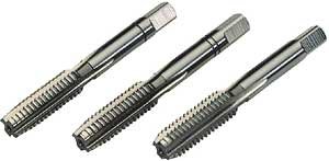

... as we have the first sunny summer day since three weeks, the testing of my new psu is postponed.
At least some little progress: mounted on the final heathsink with M3 screws and freshly cutted threads.
Franz
