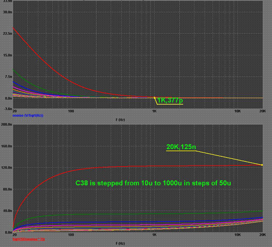

Salas: is the recomendation for the 220uf electro based on dielectric performance, or simply size?

Size. Gets the output noise down by filtering the reference locally more, leaving less noise to be amplified internally. Dielectric is mediocre. But you don't care about that for a clock, you want best 1/f noise on the noise graph's left. See the noise stepping with capacitor values noise analysis. Comes from a third party and my LT Spice one followed it nicely. I listened to a double mono BIB @ 35V with separate 100VA M6 EI Tx for MC Simplistic phono, where I recommended 47uF FC 63V//0.022uF FT1 Teflon underneath for C101,102,301,302 and it was open, very good balance and detail. There it matters for the whole audio spectrum. That circuit has very limited PSRR and high gain though. If it was with OPAMPS or had current sources as loads 10uF MKP would suffice. No oscillation frequency could be found on 20cm twisted sense and force cables both with a 100MHz DSO and a a 50MHz Philips CRO, on actual load mode @ 200mA set for each channel. 1,8V over R101,301.
thanks for that Salas, very interesting chart indeed. i think I just found my first victim for the new CDE 944U 220uf DC link polypropylene I ordered earlier this week. I bought it to just put after the batteries in place of the regulator, but i'll try it here too. i want to test them out and grab for my SS circlotron power supply..

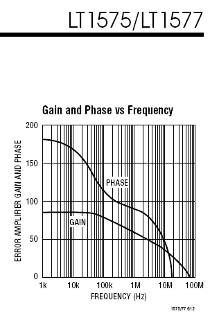

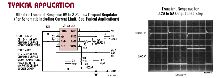

wrt the graphs, i was just agreeing with your and ikoflexer's comments that layout and decoupling rule at very high speeds. The lt1575 datasheet i linked on the previous page (plus the lt1764A datasheet if you look at that, the lt datasheets are very thorough) that up in the clock speed domain you really have to leave it up to layout and decoupling to do their job. the lt1764A only covers frequency vs transient response, ripple rejection vs frequency (about 25db at 100khz and 19db at 1mhz) noise vs frequency (30uV over 10hz->100khz with 3A load) etc etc, but the lt1575 system from what i gather is their fastest transient response offering, but they dont give a lot of specific info with noise or output z, as it depends on what mosfet you use it with.
From its OLG graph and 220uF electrolytic across output don't expect miracles of extension. Although very good. Its just settling rapidly for high current step. Which is important in computers. FT1 22nF are those 4 silver ones on the right board, and the one behind the ERO MKC on the 1.2R reg left hand smaller board, to get a size idea.

??? I havent bought the lt1575, just started thinking about it the other day while searching the site and thought it looked like an interesting idea. i wouldnt put a 220uf cap on the output of a fast reg like that, might even damage it. I'm not using a regulator with the film cap, the lt regs i'm using and the ones i gave numbers for (LT1764A), i'm using in a portable sabre dac unit for the clock and main dac supply with minimal output caps (10uf smd panasonic solid polymer and 10nf np0).
