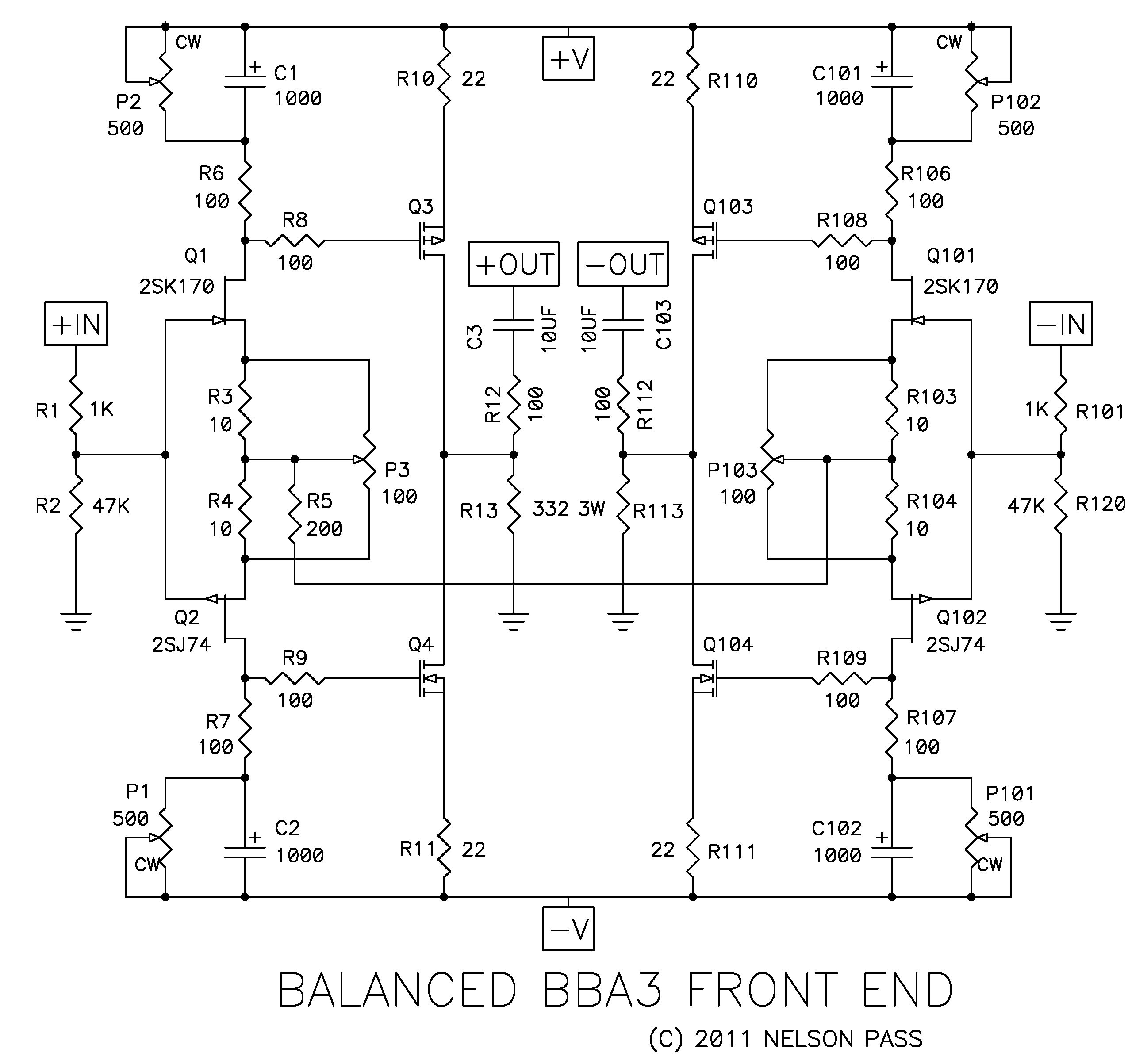

Output capacitors for BA3 FE with Salas BIIB supplies
Just completed building the two positive and two negative regulators and they all ran perfectly with dummy loads for over an hour. Bumped up the CC setting to 360ma for now. Will watch the heat and readjust when all is done.
I have not built a DCB1 but have read quite a bit of the thread and it appears that using symmetrical supplies has greatly reduced the need to use an output coupling capacitor and so there is none used, with usual caveats about a known good source, possible catastrophic regulator failure, etc. I am building a BA3 Balanced preamp using the BIIB regs. Do I really need the output cap shown as C3? Shouldn't the same thinking that went into not using the output cap in the DCB1 apply here?

Although I have listened to one made by a friend and I had also run a simulation in a how much gain discussion over at its thread, I am not practically intimate with this design so to give you a definite answer. It is not having a CCS for its output stage and no relay to disengage fast so there should be DC drift until its output bias has settled and a power off DC cycle as the PSU capacitors will be drying out never exactly symmetrically. But better ask Nelson or expert builders. Someone may measure DC offset at the input side of the coupling capacitor for you.The supplies regulation type does not come into this BTW.

Thanks Salas. I participated in the gain discussion with you at that thread.
I think I will build it without C3 and R12 first and measure DC offset carefully for each phase and differentially and then decide. My fear is that not including C3 and R12 may lead to some weird oscillation?
Sans R12 there is some ground to think that and you should keep it, but the single coupling cap usually does not participate in stability. Because a series output resistor damps and gives more phase margin in the ultra HF open loop gain analysis of a loop feedback system. Where the capacitor is for blocking DC only and rarely comes into play for value and LF stability. Maybe you have heard about the "motorboating" LF oscillation effect in multistage tube amps, usually three stage ones with two couplings. I would not expect it here.Thanks Salas. I participated in the gain discussion with you at that thread.
