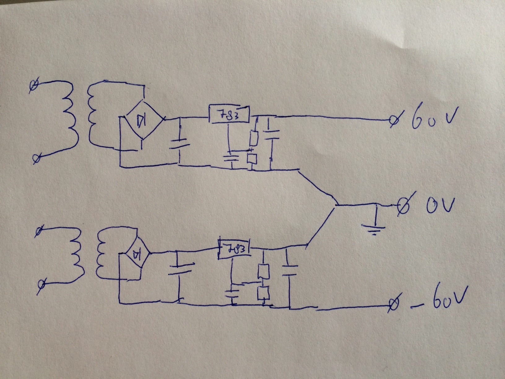

can we use two positive bibs in the following fashion? I have one 18v supply but can we use two positive regulators like in the follwing pic?

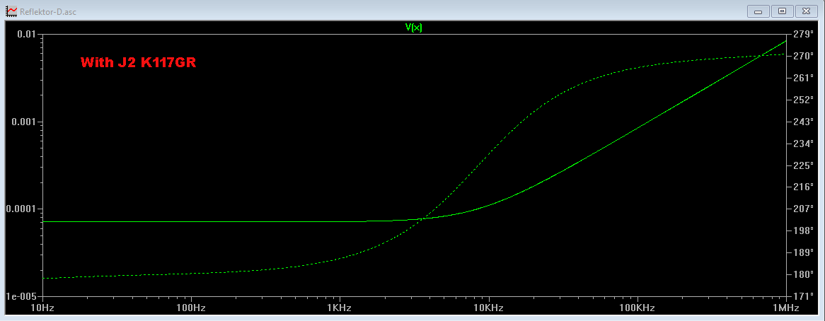

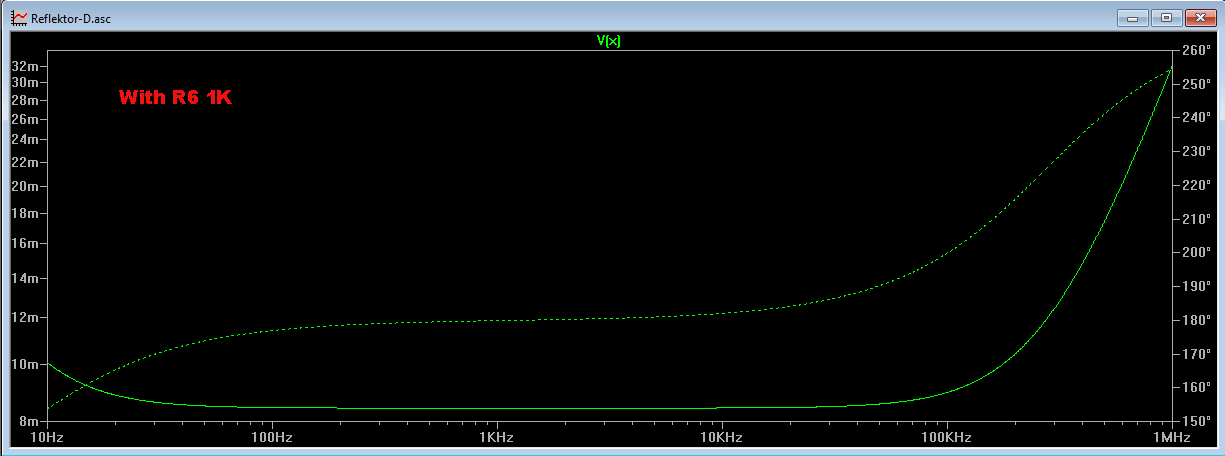

Salas are there any Zout plot for ref d?
Here are the Zout simulation plots I promised. I am very doubtful about the completeness of the JFET models available and there are many practical build parameters not easy to predict so don't consider those plots absolutely trustful.
