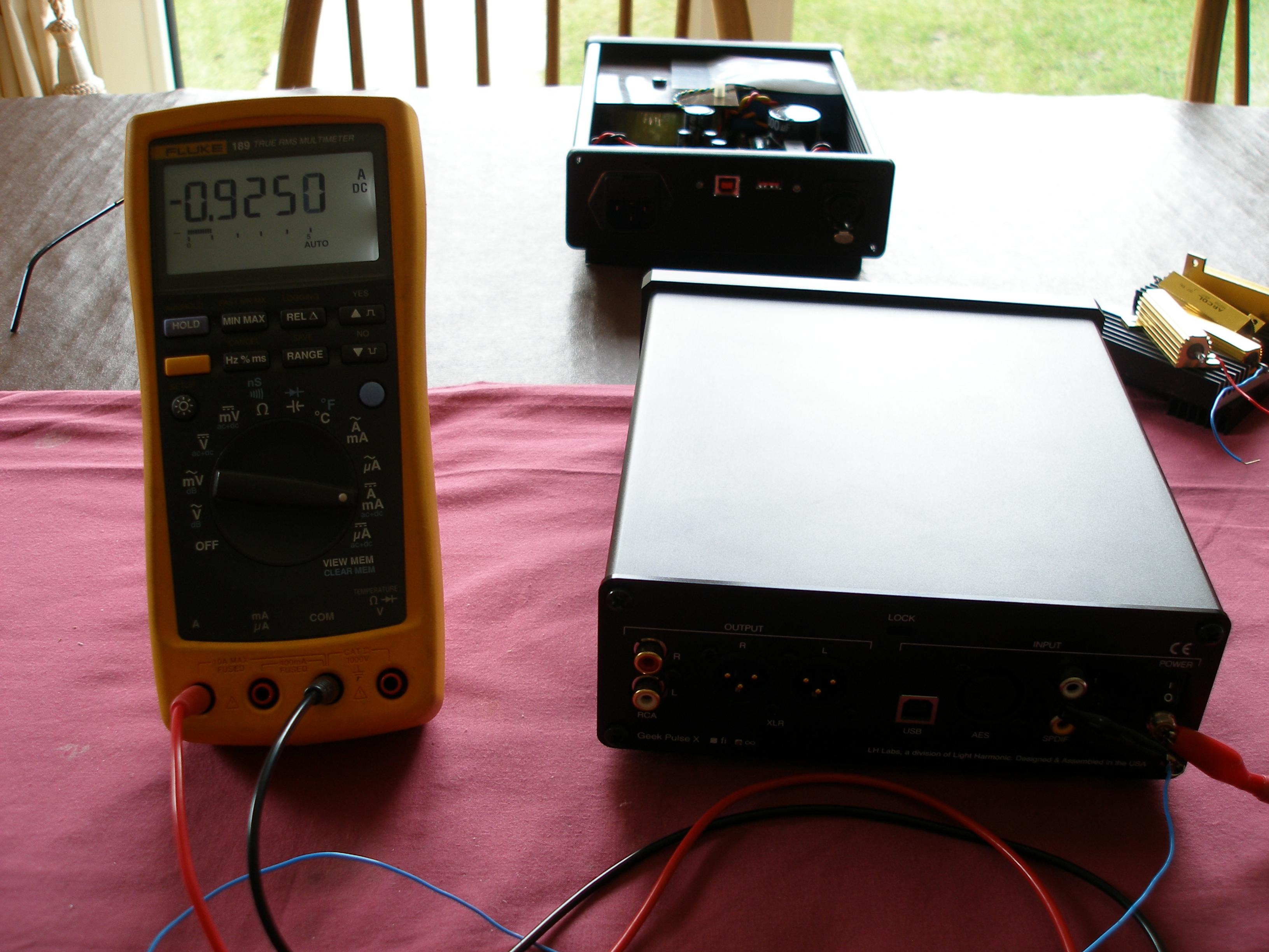

Geek Pulse DAC draws 392ma on switch-on, 700ma + 3 secs, peaks at 930ma at + 9 secs, drops to 911ma at +11 secs and settles at 925ma after 2 minutes. Stable with SMPS 12V supply and also with basic LM317 12V supply.

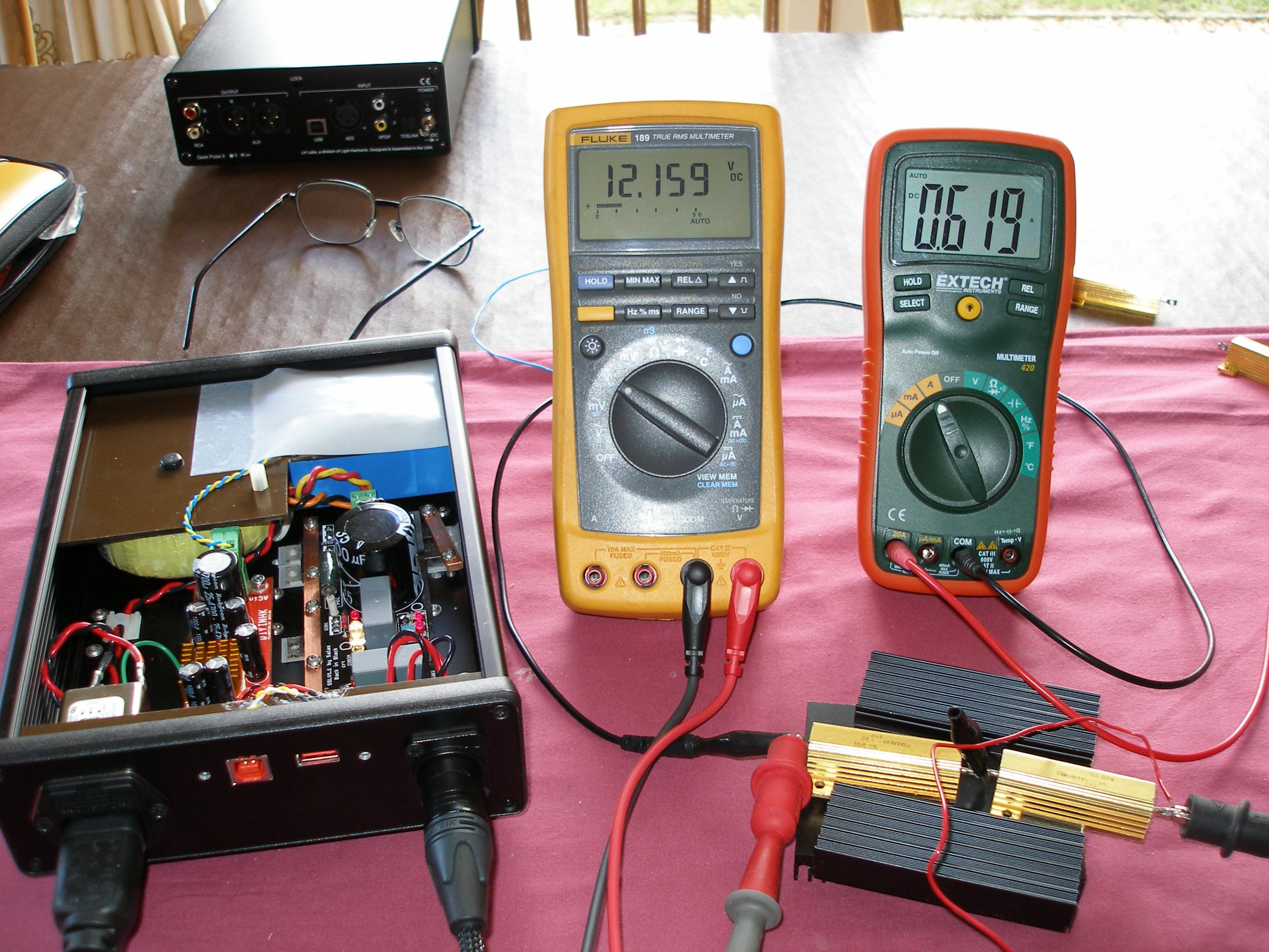

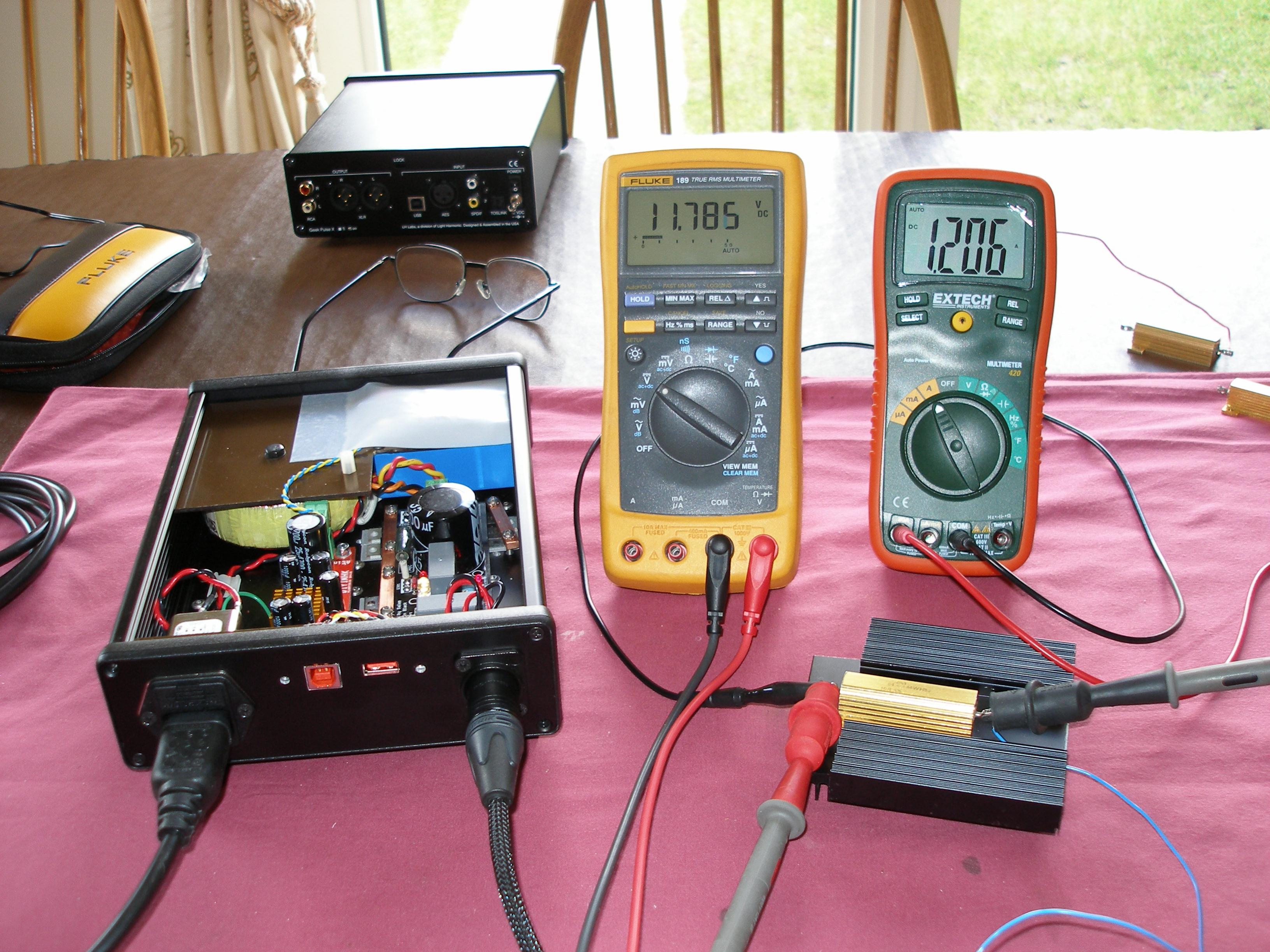

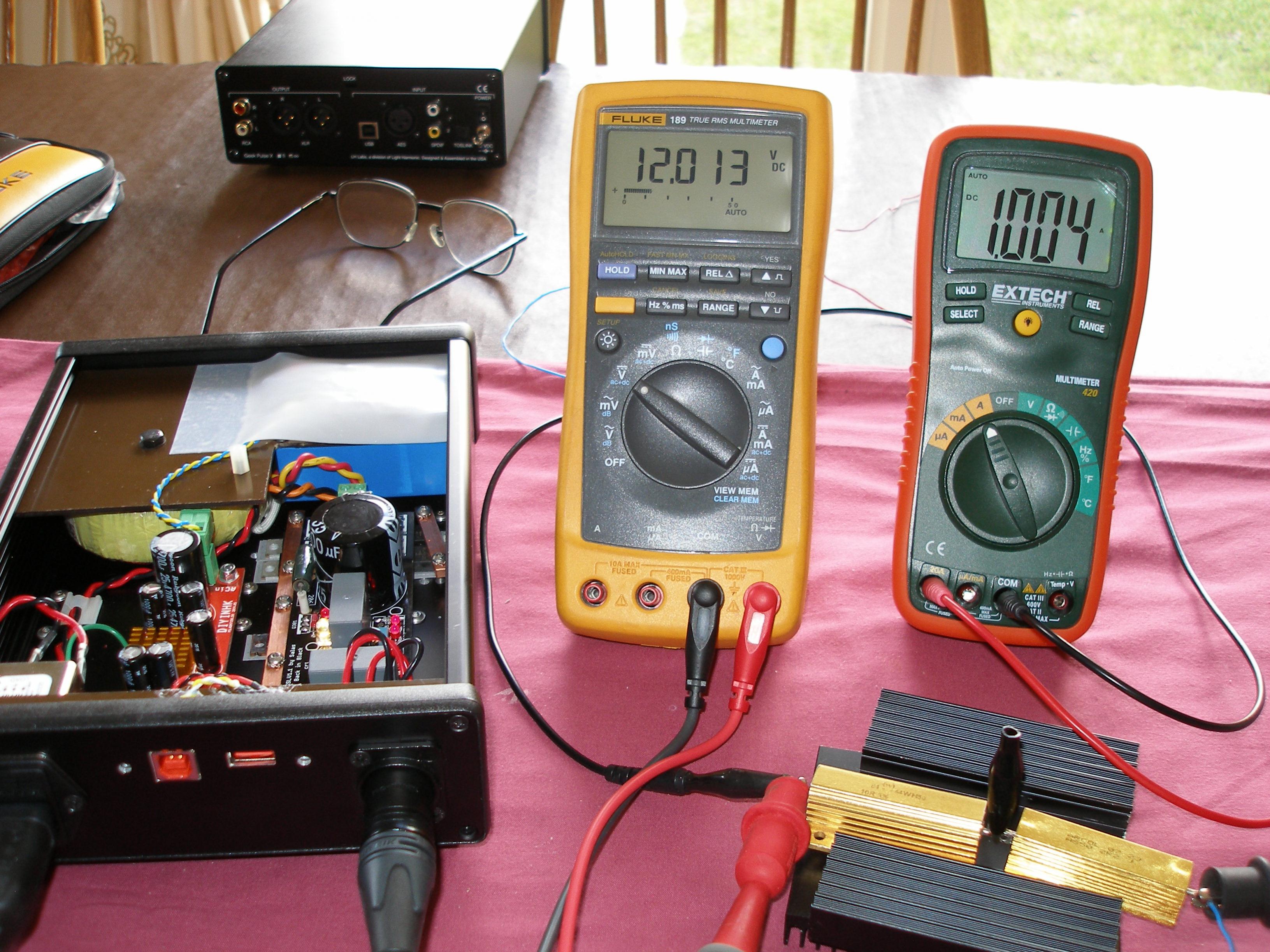

Salas reg gives steady voltage with dummy loads of 619ma, 830ma, 1.004A and even 1.206A. Max temp of IRF9610 tab = 85°C and IRF9530 tab = 53°C. Ambient case temp = 35°C, so they're hot, but within spec.

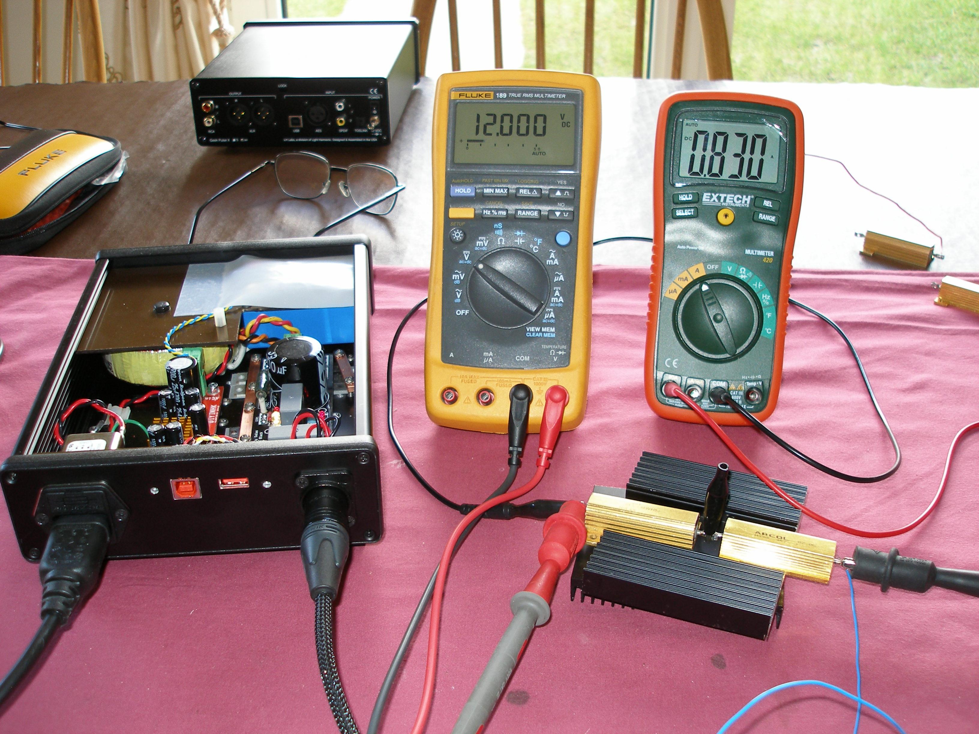

Salas reg measurements with dummy load of 829ma;
Vout = 12.73
Vin = 20.6V
R101 = 0R33. 420Mv (5% resistor not measured)
R108 = 104.5mv
IRF9610 VGS = 5.942V
IRF9530 VGS = 3.7V
D106 + 105 drop = 3.59V
D102 > D104 drop = 6.35V
Q103 VDG = 0.6V
Q104 VCE = 9.1V
Q105 VDG = 3.668V
Salas connected to Pulse DAC drawing 925ma. (2 wire connection)
Vout = 7.46V
Vin = 20.6V
R101 = 0R33. 425Mv
R108 = 107mv
IRF9610 VGS = 5.9V
IRF9530 VGS = 3.82V
D106 + 105 drop = 3.39V
D102 > D104 drop = 6.34V
Q103 VDG = 0.536V
Q104 VCE = 3.69V
Q105 VDG = 3.8V
So everything seems to be working fine in isolation, it's just that the Salas and the Pulse won't play nice together! Hmmmm.

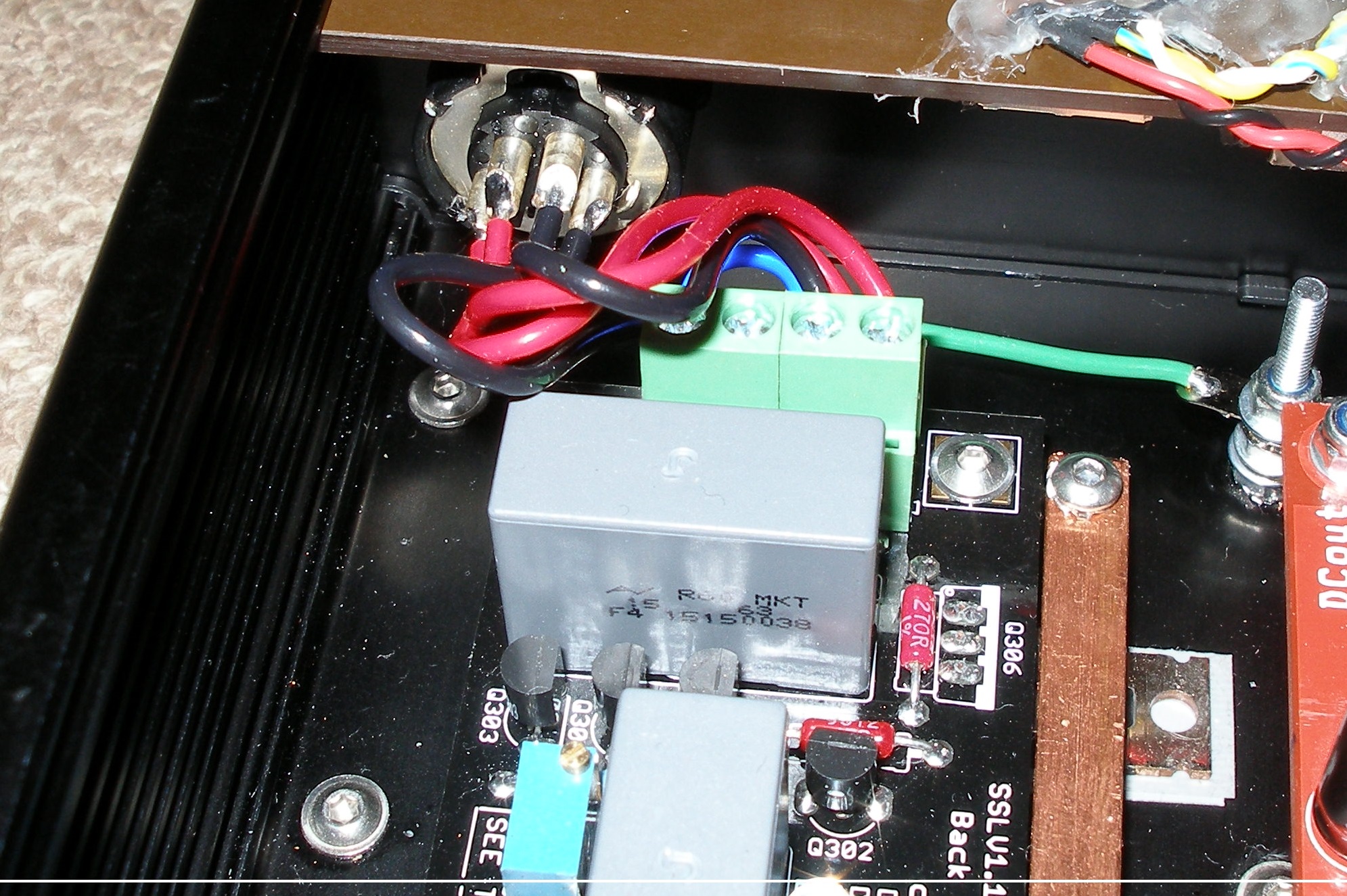

The jumper is replacing R107 (207,307) the electrolytic is C103 (203, 303) and has a place that will be revealed when you will remove the film cap C104 (204, 304)

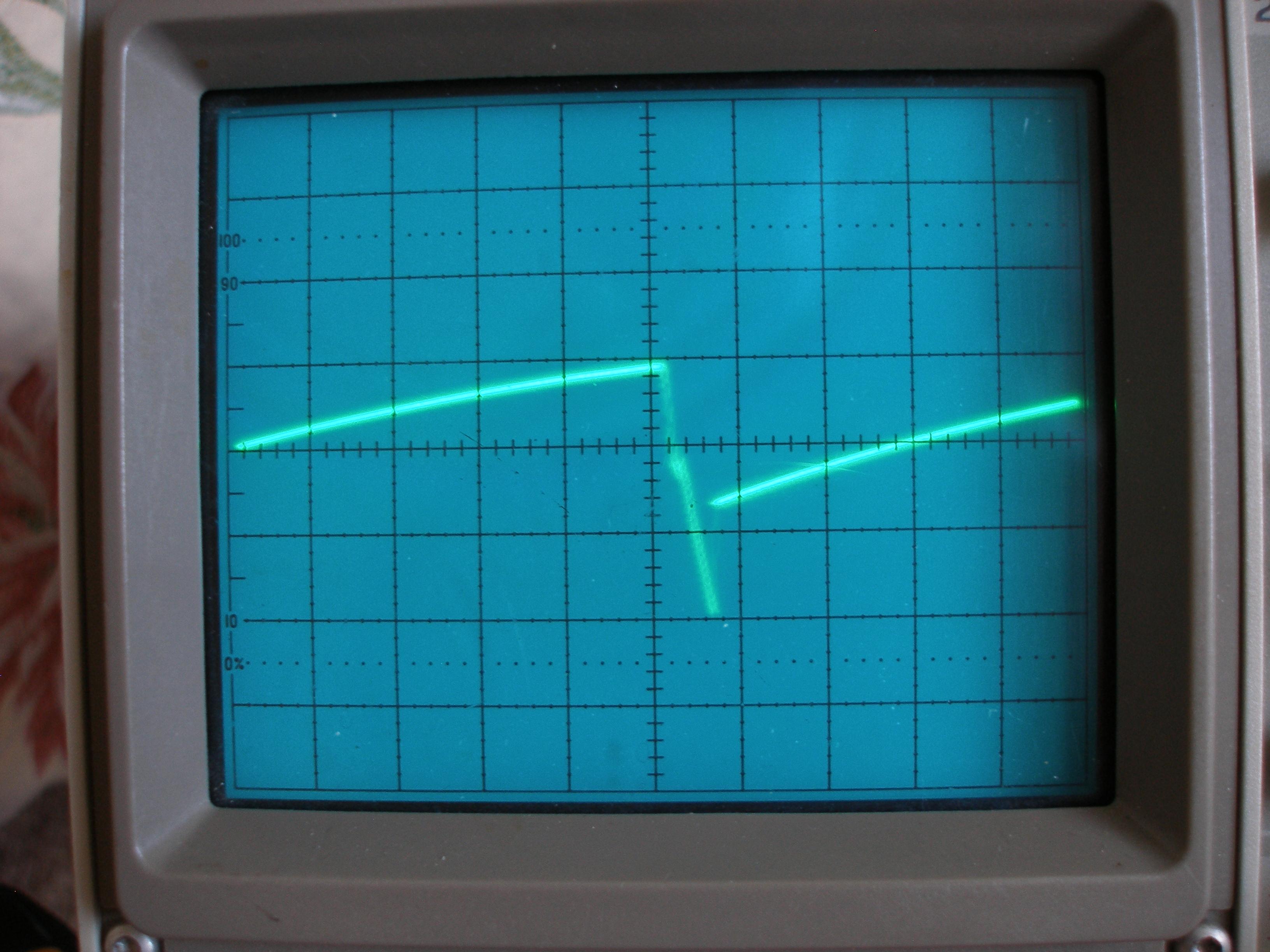

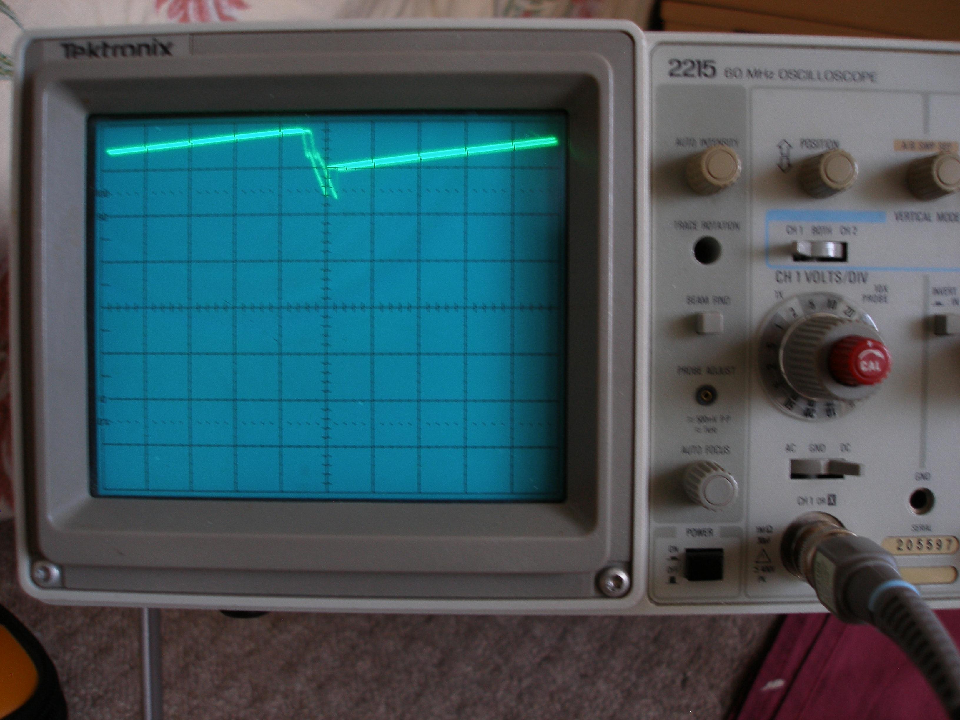

OK, now I've got a 47uf Blackgate at C104 and a jumper at R107, same result. Around 6.5V out. 'scope pics show a 71hz, 3v wave riding on the dc.
This is looking like a no-goer, unless it's worth increasing the value of C104? It's a shame really because the output into the dummy loads between 0.6-1.2A is rock steady, however it looks like the DAC may be causing the problem.
I think the DAC is drawing more current (during the repetitive pulses) than you have measured.
The CCS+Shunt is going into current limiting and that's why you are seeing the droop in voltage.
71Hz can't be an oscillation. It would have been in the 2-5MHz region if so. Replace the 9610 with a 9530 try it again and if it does the same crank the current a bit more up.

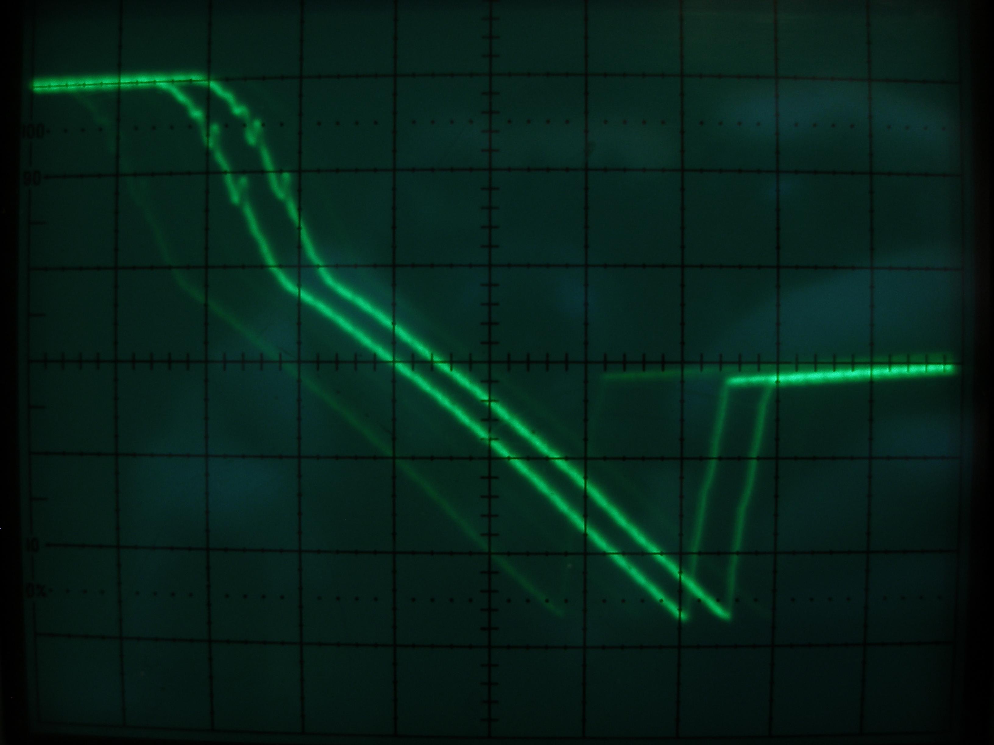

Dimming Leds is sometimes sign of oscillation. If you will AC couple the scope you can examine the rail at mV level uSec area sweeps. A mid-line ridden with semitone like fuzziness would be sure oscillation.
There is some oscillation at 5mhz and I'm still getting the weird spike shown in the earlier post. Just tried an additional 220uf across the output which made no difference other than lowering the output voltage slightly.
Is cap ESR critical on the output?
Its the oscillation that makes for the erratic behavior. Something at the rails of the load is at odds with the specific wide bandwidth regulator. Maybe some decoupling scheme fights it. The ESR can make a difference restoring stability. Try 1R in series with the output capacitor. Remove the R107 jumper and try with the R there.
