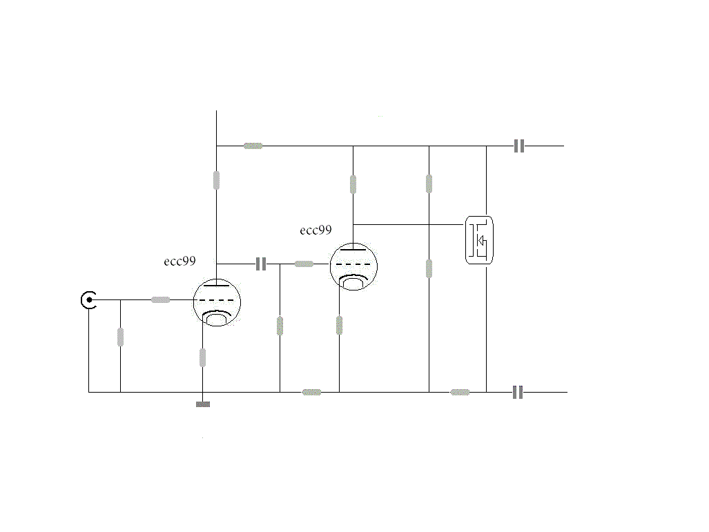

You have a PNP or P-CH pentode? Sweet!
Even if we speak the usual N concertina,
unless you strap as a triode, screen current
will imbalance the result.
Put a pentode or any N there and see what happens.
You need the top to follow the plate, not the bottom.
Else scrap the whole equal impedanace, non-elevated
heater, free ccs advantage, to live again in caves...

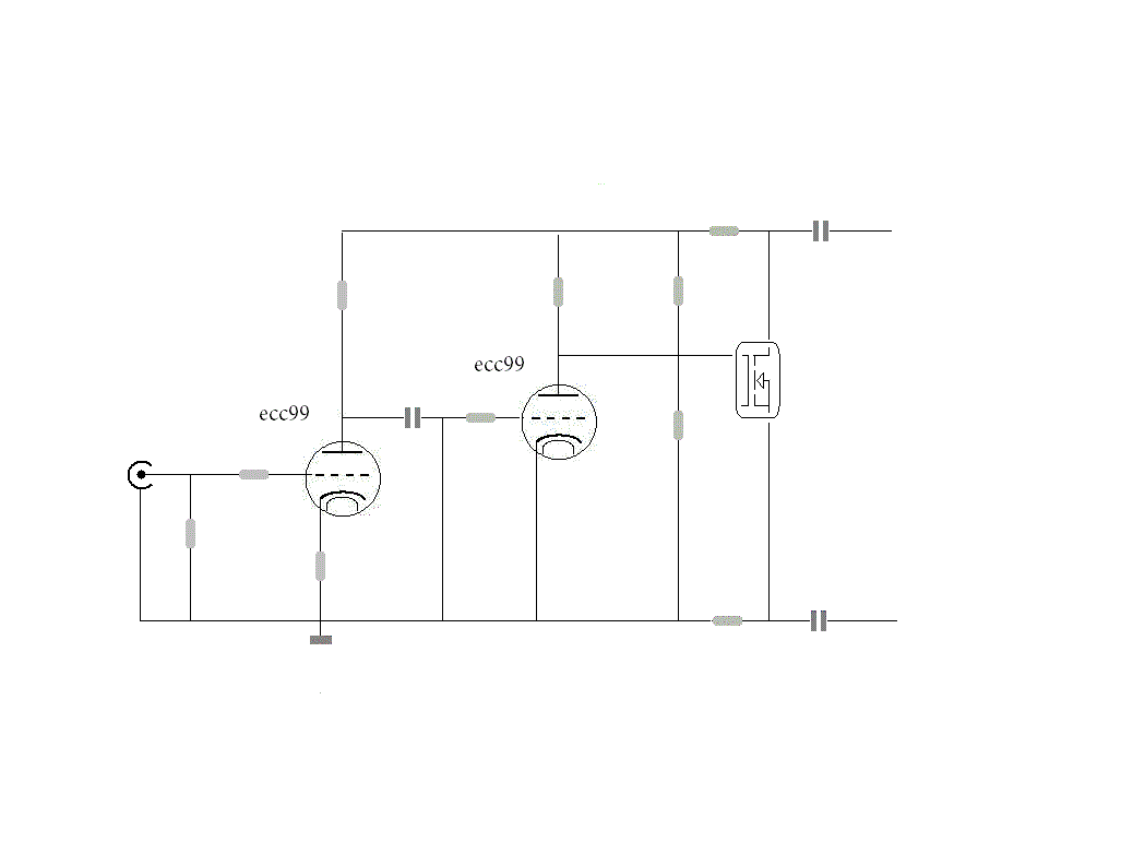

You would have to change R1, or (R2 and R3) to keep the cathode
feedback at 1/Mu.
And that probably isn't the right DC bias forECC99 cathode, so you
have to do something more than whats drawn to correct that too.
feedback at 1/Mu.

....more than whats drawn to correct that too.
not sure what drawing...?
What drawing? #13...
As for #68, Driving impedance is not equal without 1/Mu cathode feedback
from the drain, to mimic the effect Mu has upon the top side impedance...
But we also know in the context of driven loads that are equal, and a closed
loop: Locally "equal" driving impedance isn't critical to class AB1 operation.
Primitive concertinas that operate half blind certainly do work. Caves or not.
Even the blind side isn't totally blind, once the GNF loop is closed.
The plate load for the second stage should be across VGS, as that gives you
a constant current source essentially for free.
If you choose to do neither, then there is no advantage to the P-CH splitter.
You would have a better choice of easily obtainable MOSFETs in N-CH...

We really need a fully differential phase splitter that can drive DC into grids.
Impedances both so ridiculously low it won't matter if they equal or not...
Something like the concept shown in #41, but with more details worked out.
good one, thanks
As for #68.....
I was sleepy and on my way to bed
maybe Im clueless already, but what you guys consider optimal in the end, will probably be out of my reach anyway
I'm just sayin' if you not gonna leverage any advantage offered by P,
you would be better served with N, superior in every other respect.
Plain old concertina will work fine with either type...
No, wait... You are using a unique feature of P, I just didn't see it...
If plate is comfortably above B/2, then you can direct couple just
as you've drawn. With N would have to do something more to drop
the coupling voltage below B/2. Maybe this advantage makes P
worth its weight even in this most simplified circuit?
So, thats 3 advantages for P.
1) Direct coupling at 3/4 B+
2) Free CCS by strapping plate resistor across VBE or VGS
3) Equal impedance split, if we feed Drain/Mu back to Cathode
Advantages for N.
1) Works in traditional circuit without modifications
2) Better gm and less capacitance than P
3) Cheap and plentiful

ehh...what 😀 did I accidentally turn the ZVN0545 mosfet upside down ?

Yeah, that symbol is drawn a bit weird.
Channel arrow looks like N, but gate connection oriented like P.
Suppose I should still have read that as N, just tripped me up.
If thats really a symbol for N? You probably can't direct couple.
Unless you gonna run the plate at some crazy low voltage...
Would have to be below 1/2 B+, would not recommend.
Maybe i nitpick over nothing. Usual direct coupling is 1/3 B+.
With the other 2/3 devoted to the plate resistor, or plate and
cathode resistors. It works just fine, and always has..
I suggest the higher plate voltage offered by P, at 3/4 B+.
Resistor across VGS holding the plate at constant current.
Will find almost 1/2 B+ headroom either end can swing...
I don't know whats the headroom on the old way? Has to
be a lot less than 1/3, to leave something for the plate...
