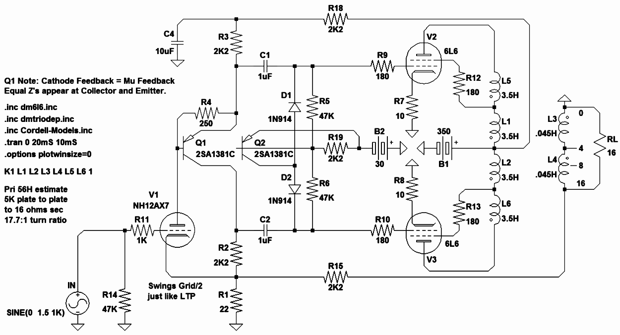

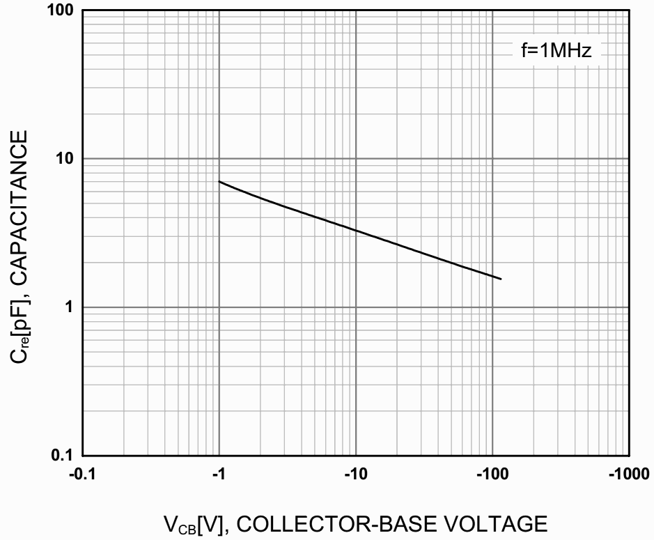

Since KSA1381 is suitable in every category including availability and price,
I'm not sure why I would need to lean on Darlington, Sziklai, or Cadcode?
Its worth my 49 cents not to screw with a complicated pairing.
Sure, pairs could work "better", but its a Concertina. It either works right,
or it doesn't. There's not much grey area to say one or other is better.

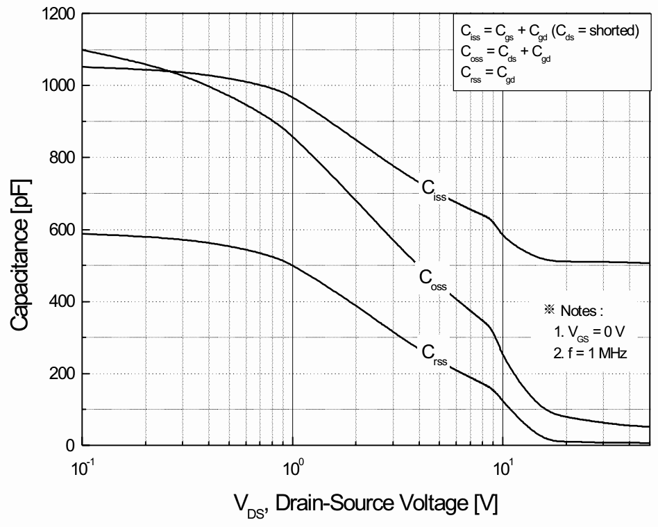

http://www.mouser.com/ds/2/149/FQP3P50-110765.pdf
-500V TO220 PMOSFET. 9.5pF seems OK, as long as VDS>20.
Looks like they want a dollarseventeen.
Cap gets out of hand quick, if you don't keep at least 20V on it.
I think thats true of most MOSFETs, but this spec sheet has the
balls to show a truth that others conveniently omit...
Burn that graph into your eyesockets if you use MOSFETs.
Miller jumps to 600picos over the last 20 volts! A little
planning, and this area of misbehavior is totally avoidable.

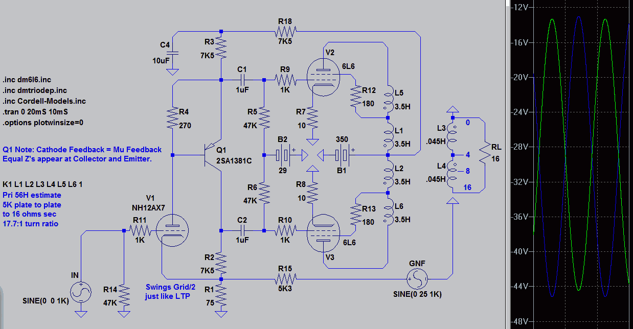

Turns out Cordell already made us a spice model for that PNP.
Cut one stage just to see if there was still enough open
loop gain to do something useful? It looks pretty alright.
I tweaked R15 for a closed loop voltage gain of 25x.
Strange consequence of the equal impedance split is that
it makes an inverted copy of any disturbance on the other
end. Thus, no problem that GNF is wired to only one end.
Not so useful, also makes an inverted copy of power supply
ripple appear at the bottom! I threw a filter cap at the prob.
It seems OK now, even with 5V of 120Hz ripple added to B+.

Coolest stupid pet trick in the universe:
With the main input disabled, I open the loop
and apply fake GNF. Just to prove the splitter
mysteriously copies everything to both ends.
Yes, it does!

Took me a while to figure how AB2 was going to work.
No followers! Let 30mA Concertina do all the driving.
Q1 will need a heatsink for sure...
The cheat is maintain bias by to pulling up only on the
cap in cutoff. Shhhh... Don't tell anyone.
