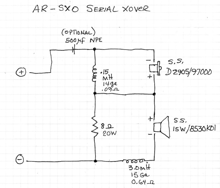

When all you theorists who are basically re-doing what Rob Elliot and John K have already done (their work is linked in earlier posts), you will eventually come to the same conclusion as other theorists (i.e. build a series xo and measure it's performance).
Has ANYBODY bothered to click on the link I provided in post #411? I built one (3 component) for a high end 2-way and measured it. I have more measurements (off axis & phase). That is, if anybody is interested and cares to look beyond the math. 🙄

No, nothing been's fried so far after months of playing. I call my speakers the 'Intimates' because they shouldn't be played loud. They are NOT designed for 100dB listening. They are designed for a small room, acoustice groups, female voice, classical quartets etc. I think you're kidding yourself if you going to design a 1st order series xo that's going to play very loud. You can search here for the holy grail of xo designs, but you won't find it. As you wrote, you need to go higher order for loud playing. BUT WHY INSIST ON THAT??? PLAY 'EM AT 75-95 dB range and ENJOY THE MUISIC!
Where's AllenB when you need nim??? My schematic gives the perfect sim scenario!!!!! Those drivers I identified are well known with published imp. and FR files available. I GAVE YOU the xo components I found gave the flattest fr. What more do you want???

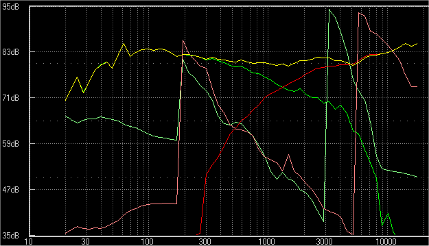

So, it's two drivers and 3 xo components...... What's taking so long for somebody to put together a speaker, response shape to their heart's content, test it and share their results?
And what are you going to say? "In spite of exceedingly flat response and my favorite series connected crossover the sound, unfortunately, sucked."??
I will say they sounded a bit bright to me in my listening room, so I changed the xo to a capless SFE design (also 3 components) with a slight BBC dip which I'm still tweaking. Series xo's aren't necessarily my favorite xo. I just thought I'd try the AR SXO design concept and it seemed to work well with the SS drivers I chose. They handled power well and each had relatively peakless response profiles. I certainly understand sxo's aren't suited for all drivers like // ones are. It's much easier to add supplimentary response shaping and impedance management networks one generally needs with less than stellar drivers with // xo's
Speakerdoctor, this plot uses the wrong (but similar) drivers and the data is suspect. Find me some better data and I'll do what I can.
