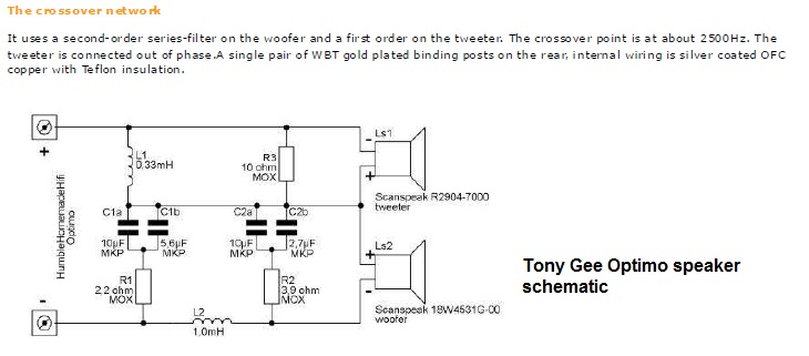

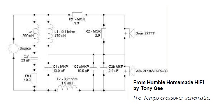

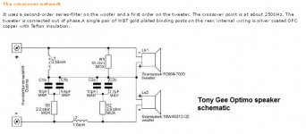

FWIW, single coil tweeter circuits can be much less simplistic and more efficient. Tony Gee at Humble Homemade Hifi uses them a lot.
As in this unchambered familiar SEAS 27TFF example with 2400Hz crossover below:

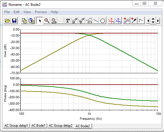

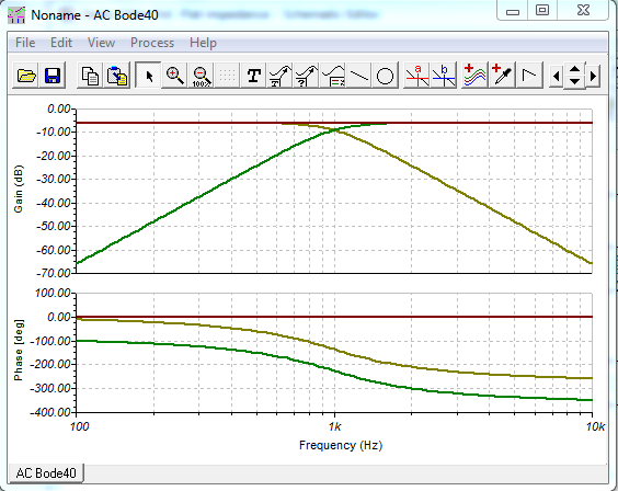

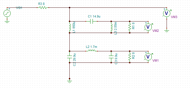

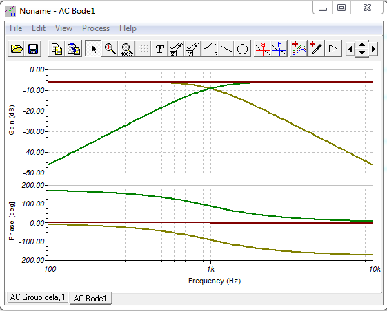

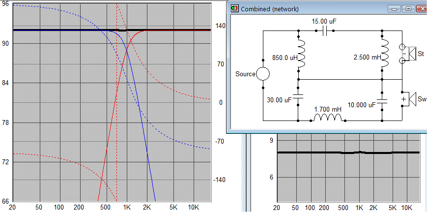

AllenB, are you getting the pattern on the third order networks yet? 😕
1st and 2nd order constant resistance and constant amplitude networks seem to be done and dusted. Just Butterworth and Linkwitz-Riley at heart. Though I'm not entirely sure what a Solen Split first order does...😱

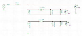

But I'm getting bogged down on 3rd order. Can't get the impedance (the brown line) flat at the moment, though I think this is very close to the constant amplitude filter. Using Tina here:

@John, I appreciate that a thread is no fun if you don't have a current interest in it. Still, it may change. (I wish I had had the chance to use a Cray 😉 )

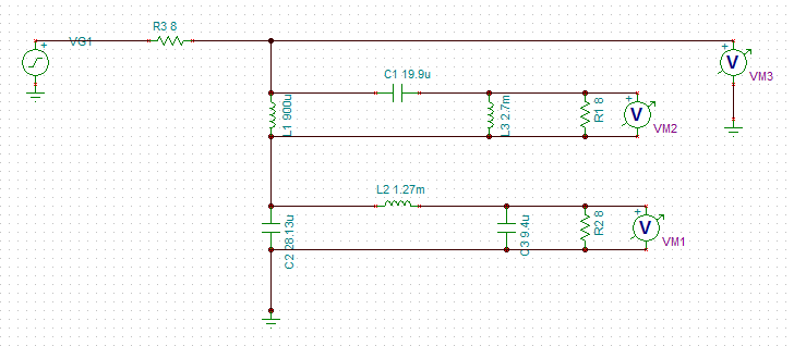

@jgv, So far I am crossing only a tweeter using two resistors and an inductor. If anything I'm getting the impression of a more smooth response due to reduced impedance interaction. The system impedance is more smooth as well, but as David has pointed out there may be low spots.
@System7, how about we settle on the topology? Will the final shunt pair remain independent or joined?
I'm not sure it makes much difference actually, except to wiring the driver polarity. But tweeter and bass shunted together seems to be most people's convention. As in Tony Gee's diagrams. 🙂@System7, how about we settle on the topology? Will the final shunt pair remain independent or joined?

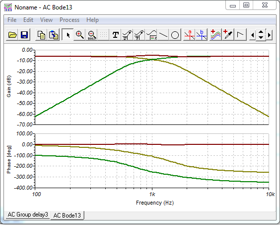

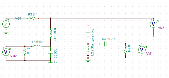

I'm hoping there is a flat impedance third order series lurking at some set of values at 1000Hz. Just not getting it...😕
@speakerdave. I am using an 8 ohm source resistor as a convenience to easily measure the overall impedance, which is usually flat for paired butterworth filters. This is nice because such a load won't be affected by the type of amp you have. You can see the impedance is flat 8 ohms here for 2nd order butterworth series filter. Usual 12dB per octave and -3dB crosover points.
So the 8 ohms in front is for modeling but wouldn't be used in a built up network. (also explains the 6dB drop)
Which is the impedance curve? The phase curves are of network voltage? 180 degrees apart means the tweeter polarity should be flipped? And are R1 and R2 real added resistors or are they the simulated drivers?
David
David
VM1, VM2 and VM3 voltage sensors give the three curves. VM3 is the brown one, and measures voltage relative to earth. It would have a 3dB peak in it for a Linkwitz-Riley filter which is not constant resistance. The subsequent curves ARE affected for the L-R filter, but not the butterworth. 2nd order butterworth has a 3dB amplitude peak. I quite like modelling the 8 ohm resistor, because I have a cunning scheme to replace it with a 8 ohm LR bafflestep correction. R! and R2 are simulated drivers. I'm not too worried about that, because you can simulate a bass as a coil and a resistor, so it will be just a question of replacing an inductor with the speakers inductance. The tweeter is easily corrected with a zobel or some padding. Polarity is not an issue at this stage. Get that right later.So the 8 ohms in front is for modeling but wouldn't be used in a built up network. (also explains the 6dB drop)

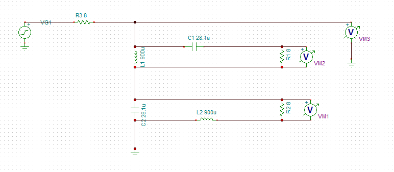

In fact the third-order parallel Butterworth is also flat impedance, and IIRC, flat amplitude. I'm just hoping AllenB can do better than me at some component values for the series 3rd order. My 0.5, 4/3 and 1.5 ratio really didn't hack it. 😡
System 7,the ratios that suit a third order constant resistance series circuit are 0.67R, 1.33R and 2R. The second order case in theory has a 3dB rise,but with real world speakers, where we measure the parameters and design the xover accordingly; the problem is non-existant.Labouring the point a little further,to achieve the 3dB gain would require the drivers to be co-incidently mounted and have identical amplitude velocity characteristics in the xover region .Peaks an dips occur by virtue of spacing and phase effects even with perfectly flat(freq response) drivers.Text book explanations are not helpful in the real world and the current fad concerning baffle step compensation is yet another example of "heading off madly in all directions."
That's helpful, VaNarn.System 7,the ratios that suit a third order constant resistance series circuit are 0.67R, 1.33R and 2R.

I overlooked a query from system 7(#473) in which he sought confirmation of the // third order Butterworth xover constants.My old sources say ,that they are 1.5R, 0.75R and 0.5R.
Flippin' excellent post, VaNarn. At last someone is talking sense! 😀System 7,the ratios that suit a third order constant resistance series circuit are 0.67R, 1.33R and 2R. The second order case in theory has a 3dB rise,but with real world speakers, where we measure the parameters and design the xover accordingly; the problem is non-existant.Labouring the point a little further,to achieve the 3dB gain would require the drivers to be co-incidently mounted and have identical amplitude velocity characteristics in the xover region .Peaks an dips occur by virtue of spacing and phase effects even with perfectly flat(freq response) drivers.Text book explanations are not helpful in the real world and the current fad concerning baffle step compensation is yet another example of "heading off madly in all directions."
I did actually finally find a good link for the 3rd. order series crossover values @ 3kHz which were published by Jeff Bagby years back:
Passive Crossover Design Calculator
The inductor ratios were as you said 3:2:1, the capacitor ratios were a bit more subtle, eh? 3:3/2:1, and the L/C ratios and Q altogether deeper which is why my measly brain got confused...😕
Very nice work, AllenB. 🙂
We are there now on the constant resistance networks, which have a certain elegance. Anybody got any idea what the 4th. order series values are?
