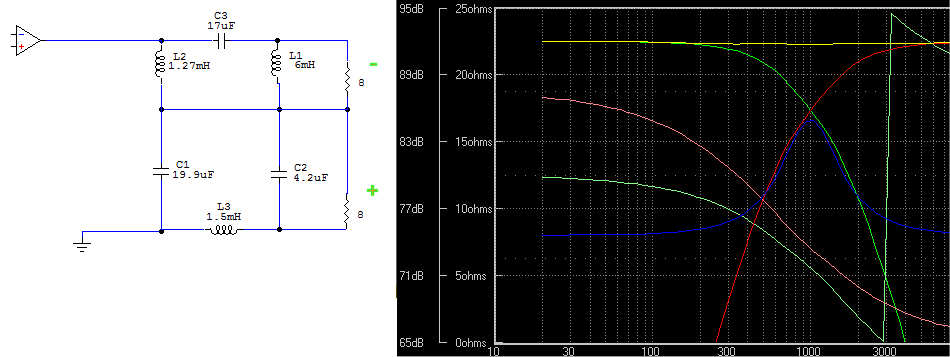

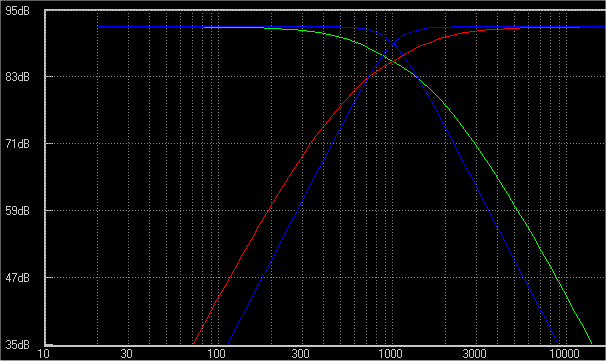

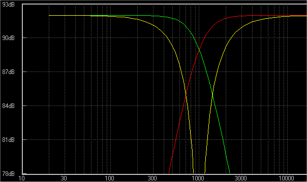

Here you go.AllenB, the first plot looks like a second order butterworth (Q=0.707) with nice flat impedance but the usual +3dB bump to me, but what happens if you wire it IN PHASE? This is crucial.
Here you go.
Damn! That is so NOT what I wanted you to get!
I was hoping for flat amplitude, of course. The adjusted values you tried in the second plot I quoted (Q=0.5) presumably give a -6db dip in amplitude? Or a complete deep notch? Can't quite remember what Linkwitz-Riley does when wired up wrong.
Still, there may be a way out of this with high source impedance like a zero-feedback amp...
Note, the conditions under which it worked.
1) Midrange (fullrange) with basically flat response 150Hz-3KHz capable of handling a fair bit of LF (excursion) and a mild rolloff above 3KHz, crossover at 3KHz
2) Woofer with basically flat response up to around 1KHz, no major resonances, crossover at 300Hz.
3) Resistive tweeter with a modest HF Rolloff towards high frequencies easily equalised flat.
4) Enclosure width, places the mid bass dip in the region of the LF crossover.
As said, it took 15+ Years and many pairs of speakers to find one combination where it works. In most situations series crossovers do not deliver.
