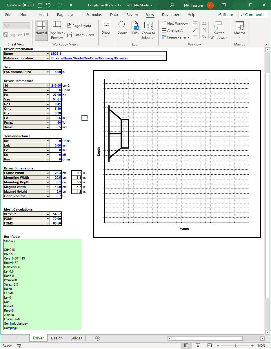

This is what the entries look like when I enter the same values in my copy of the BOXPLAN-MLTL workbook (v2.6)
Hi Brian,
If you change your regional settings and use a comma as the decimal separator, I think you will find that you have the same problem as MediOak.
Not sure if it is a contributing factor, but Hornresp driver files use a period as the decimal separator, regardless of the regional setting (and that is not going to change).
Kind regards,
David

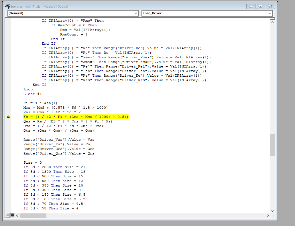

Now I'm getting a runtime error '11' Division by zero.
When I filled out the form manually then BL was different from the Hornresp calculation. It could have taken it from the last uploaded driver.

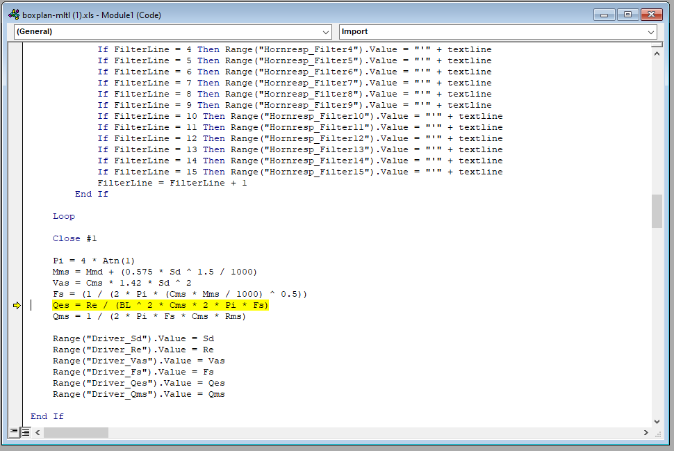

when importing it says run-time error '13' "Type Mismatch"

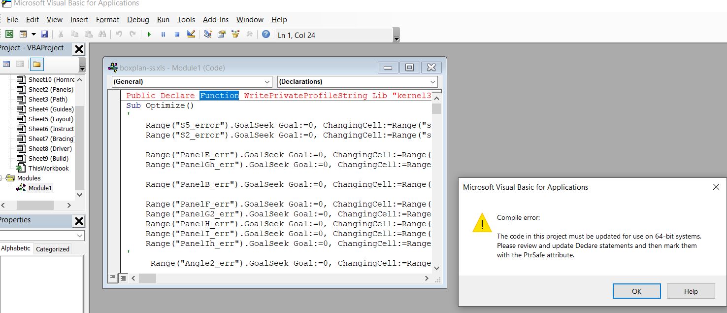

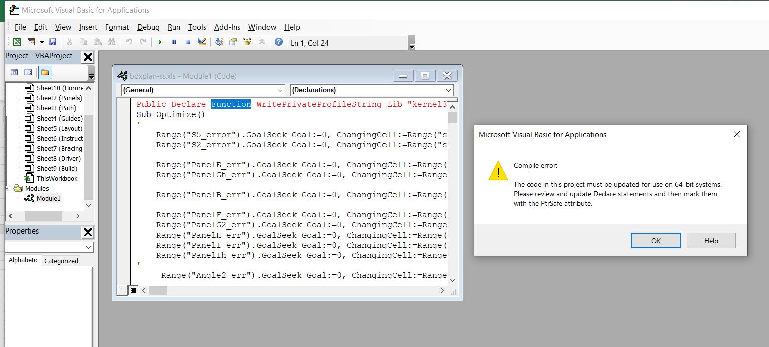

Error in workbook
I am using the SS workbook and receiving the following visual basic errors.
I downloaded from the website on 9/20/2021
Images of error as requested by Brian Steele (thanks)
Make sure that it's version 9.7 that you're opening.
The code that you pictured above would be changed to this:
#If VBA7 And Win64 Then
Public Declare PtrSafe Function WritePrivateProfileString Lib "kernel32" Alias "WritePrivateProfileStringA" (ByVal lpApplicationName As String, ByVal lpKeyName As Any, ByVal lpString As Any, ByVal lpFileName As String) As Long
#Else
Public Declare Function WritePrivateProfileString Lib "kernel32" Alias "WritePrivateProfileStringA" (ByVal lpApplicationName As String, ByVal lpKeyName As Any, ByVal lpString As Any, ByVal lpFileName As String) As Long
#End If
