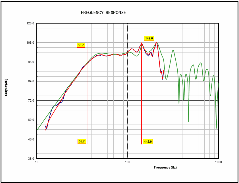

Note: my measurements have suggested otherwise, concerning the presence of the peaks. It's all down to how well you build the box, including the effectiveness of any bracing that you use, and if you use any damping material in the box.
For example, consider sim'd vs. measured response here. Those peaks are not attenuated that much from what the sim suggests they should be.

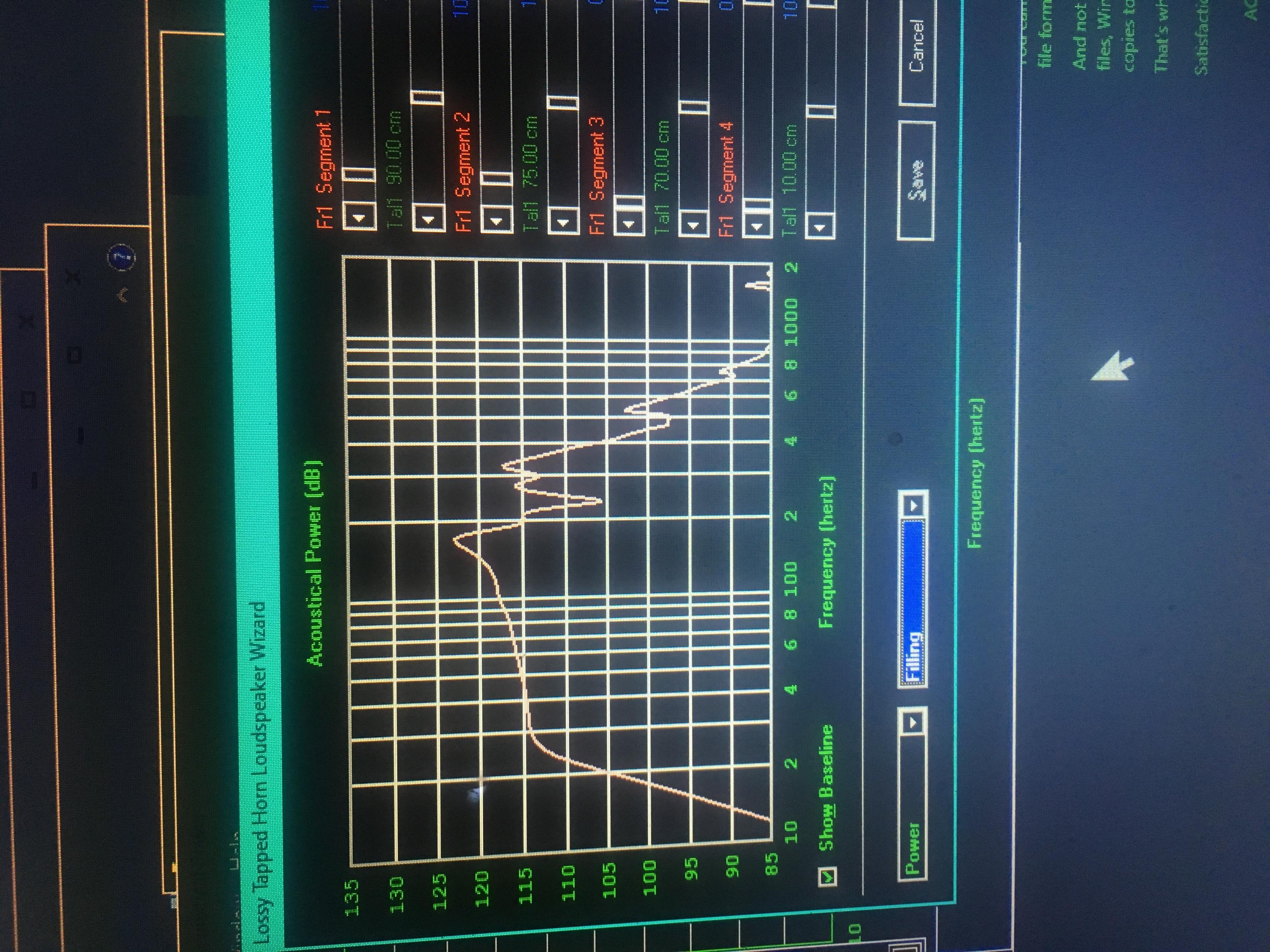

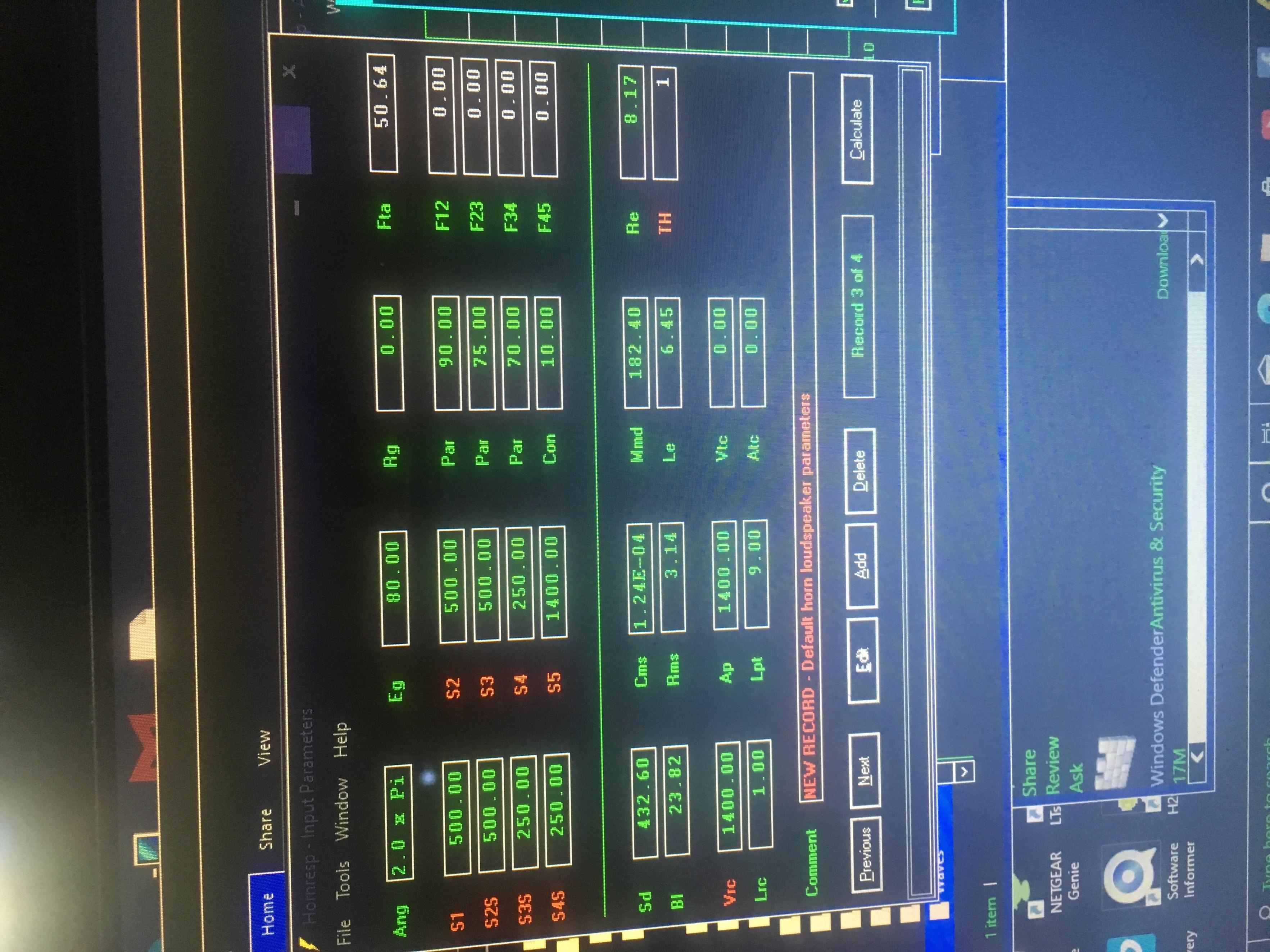

In the OTHORN sheet, I am using driver import and hornresp sim output. I noticed, that when i import a driver and import the sim back to HornResp, the parameters of the driver change. An example:
Original parameters of the driver:
The same driver imported to the spreadsheet and then reimported along with the sim from spreadsheet:
Aside from driver parameters, the boxplan record has Rg set to 3,64. Why that number?
I was referring to the peaks up higher in frequency. I agree with what you have shown. Also agree with your summation that the better you build the box, with fewer loses the better it will reflect the simulation.

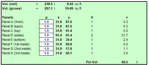

How do you then transfer the layout from spreadsheet to building tool like SketchUp?
I can't quite get "Guides" sheet over my head with coordinates and i can't seem to find the list of panels with corresponding sizes in this sheet.
I can export the fold as an image and then follow it along with lines in SketchUp, but this is a lot of manual work and can bring in some errors.
I am sure i am not seeing something obvious.

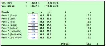

The list of panels and their sizes will be in a section that looks something like the following attached image. Usually that's on the "Design" sheet in the workbook, but in some of the workbooks there's a separate "Build" sheet that contains this information.

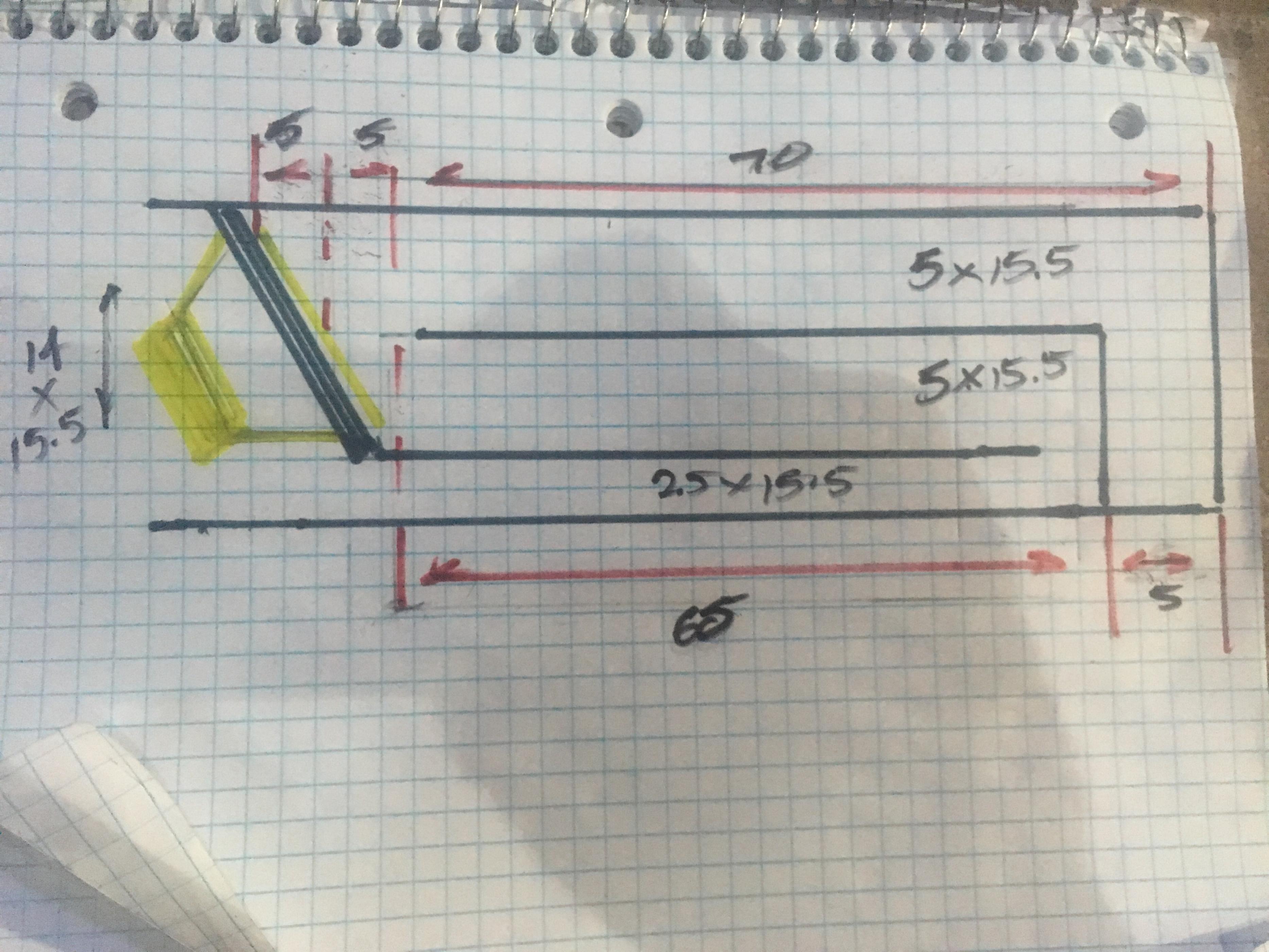

I know it's a bit of an off topic, but i'm gonna ask hoping to get some advice.
I bought a driver relatively cheap - Hertz ES 300.5
Here are the specs:
I tried modelling it in an Othorn alignment, as a MLTL2 and a simple bass reflex cabinet.
And bass reflex provides almost identical performance as Othorn and MLTL.
Here is how a Othorn vs Bass reflexx looks like in HornResp:
There is a dent in response at about 60hz of an Othorn and from what i understand, the rest of the response should be EQed to that dent, crushing its sensitivity to about 91dB. Almost the same can be obtained from bass reflex. The Othorn enclosure provides 5-6Hz more but not much more sensitivty (due to a dent).
So... should i simply stick to a vented box?
This is how they look size wise:
