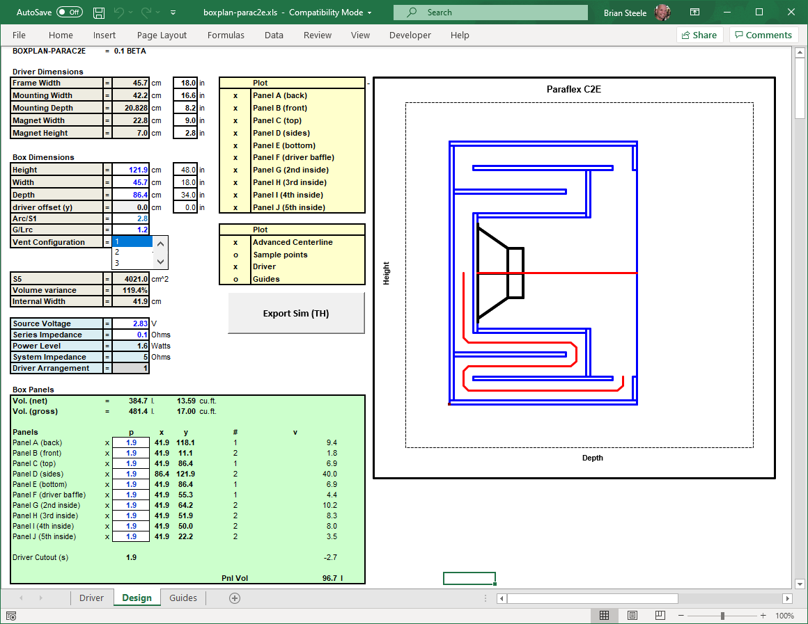

BOXPLAN-PARAC2E - this BOXPLAN workbook can be used to design Paraflex "C2E" enclosures.

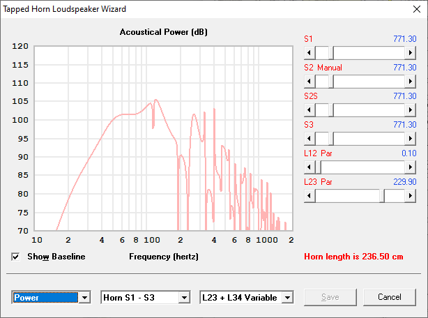

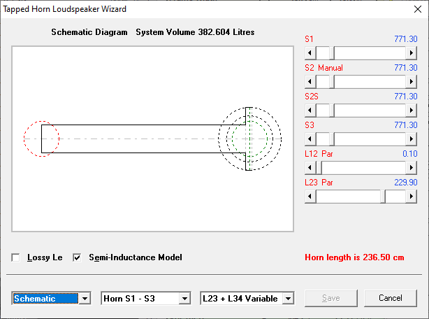

Brian,
Using your spreadsheet and i think i am now satisfied with what i see in Excel and in Hornresp sim. This is what i see in the guides section:
Is this how it supposed to look with zeroes in the left bottom corner?
And another question - what is the supposed thickness of the material? I am deducing it is about 15cm for internal walls and 2.5cm for external? Is it possible to change it in the spreadsheet?
I am currently using OTHORN sheet.
P.S. Thank you a lot for such a tool. In no way I could fold the horn if not with this tool.
Those "zeroes" just mean that (1) you're looking at the schematic on the "Guides" sheet and (2) you haven't selected the "Guides" option on the "Design" sheet in the workbook.
You can change the thickness of each panel (in cm) on the "Design" sheet in the workbook, in the "Horn Design" section. It's the zeroes on the "Design" sheet that you have to worry about. All the figures in red should be zero, or the design is not optimized.
I'll have to give that workbook another look when I have some time. I see a few things in it that can be improved.

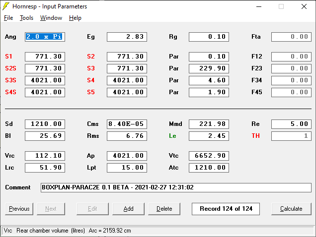

Brian,
In the OTHORN sheet, I am using driver import and hornresp sim output. I noticed, that when i import a driver and import the sim back to HornResp, the parameters of the driver change. An example:
Original parameters of the driver:
The same driver imported to the spreadsheet and then reimported along with the sim from spreadsheet:
Aside from driver parameters, the boxplan record has Rg set to 3,64. Why that number?
Now, that IS weird.
I just checked my copy of the BOXPLAN-OTHORN workbook, and I'm not seeing the same error in the import routine. Are you using the latest version of Hornresp? On the "Design" sheet in the workbook, do you have the Export format set to "BOXPLAN" ? If so, share screenshots of the "Driver" sheet and the "Design" sheet - I'll see if I can replicate the error.
BTW, you're using an older version of the BOXPLAN-OTHORN workbook. The latest version is v3.2. Actually 3.3 - I found another minor error which I just corrected (sigh).
