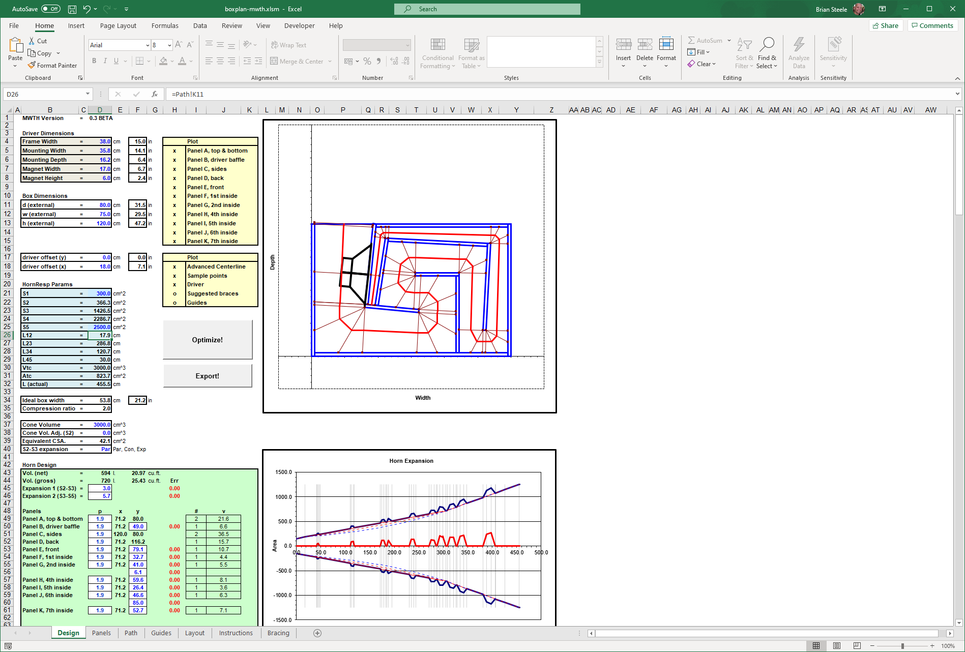

Change the dimensions in smaller steps 🙂
The regression analysis in those workbooks isn't perfect, and trying to change any dimension in a dramatic fashion could lead to what you experienced. To avoid that from happening, change the dimensions in smaller steps, e.g. 50->60->70->80 rather than 50->80.
Brian, I tried that. But some dimensions need as small as 1 or 0.5, as dimensional increments to avoid messing up in the optimization stage. Probably very sensitive designs, looks like.
The BOXPLAN-MWTH workbook is a bit more complicated than most of the others. It requires the user to adjust five variables for the box layout - the external dimensions and the start and ending CSAs of the horn. I suggest that if you're expanding the external dimensions, expand the values for S1 and S5 by a proportional amount as well. If necessary, turn on the "advanced centerline" and "sample points" graphic options, and manually adjust the lengths of the internal panels until the expansion looks fairly smooth, then use the "Optimize!" feature to complete the job.
Even then, you may find that it's simply not possible to fit an optimized MWTH fold inside the dimensions that you want to use. In your specific case, it might not be possible to fit an optimized one in the dimensions 120x100x75, but I was able to find a solution that fits in 120x80x75
Thank you, Brian. 120x80x75 cm is even better than what I intended to work with (20 cm of extra space!).
But this need for stepping etc. reminds of typical static FEA structural analysis. Most FEA software come with certain basic logic that allows them to adapt the incremental stepping of the load based on certain predefined criterion. Is this possible to implement for this and similarly complex worksheets? I have a very basic knowledge of python...
Remember that BOXPLAN can only find an optimized fold for a particular box. It might not be the best box design for the driver that you want to use. That's where the corresponding Hornresp sim comes in.
All of the BOXPLAN workbooks are at various stages of development. There are checks and balances in some that are not present in the others. Yet 🙂

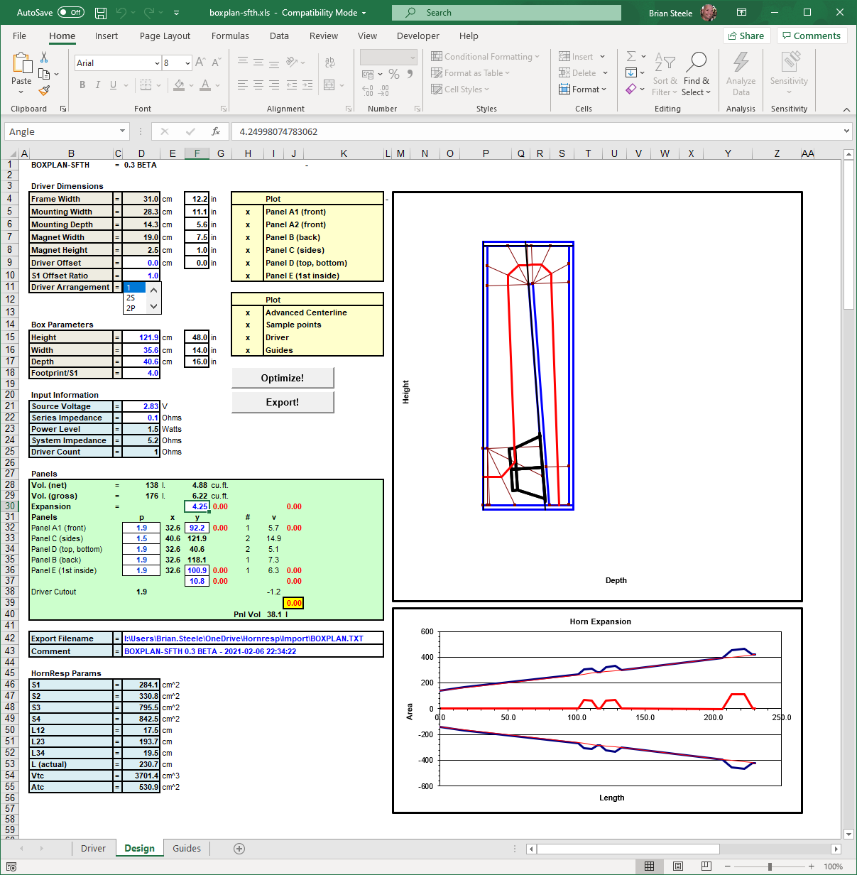

Quit a few of your more mature sheets feature "optimization" that generally gets quite in the ball park of good performance and some even suggest optimal dimensions. Do you plan any such optimization feature in paraflex spreadsheets too?
The "Optimization" routine included in many of the BOXPLAN workbooks only optimizes the physical layout of the described alignment in the external box dimensions provided by the user. It doesn't make any attempt to optimize the resulting response curve of the sim - to do that would require a lot more coding and access to an API for Hornresp, which is probably not going to happen in a hurry 🙂.
The "paraflex" BOXPLANs, at least the ones that I've done so far, don't need an Optimization routine, as their layout can be easily derived from external dimensions provided by the user. For other types of designs, that derivation isn't so straightforward, hence the Optimization routine, which uses Excel's regression analysis to find the best solution for the internal layout.

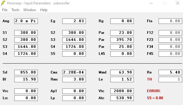

If you're not getting good results with a particular BOXPLAN paraflex, try changing the external dimensions of the box in the workbook, export the resulting Hornresp sim and reimport it into Hornresp (pressing F6 in Loudspeaker Wizard). Do this a few times and you'll quickly get an idea of how much you'll need to change the dimensions of the box to achieve the response that you're looking for.
