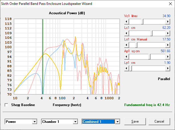

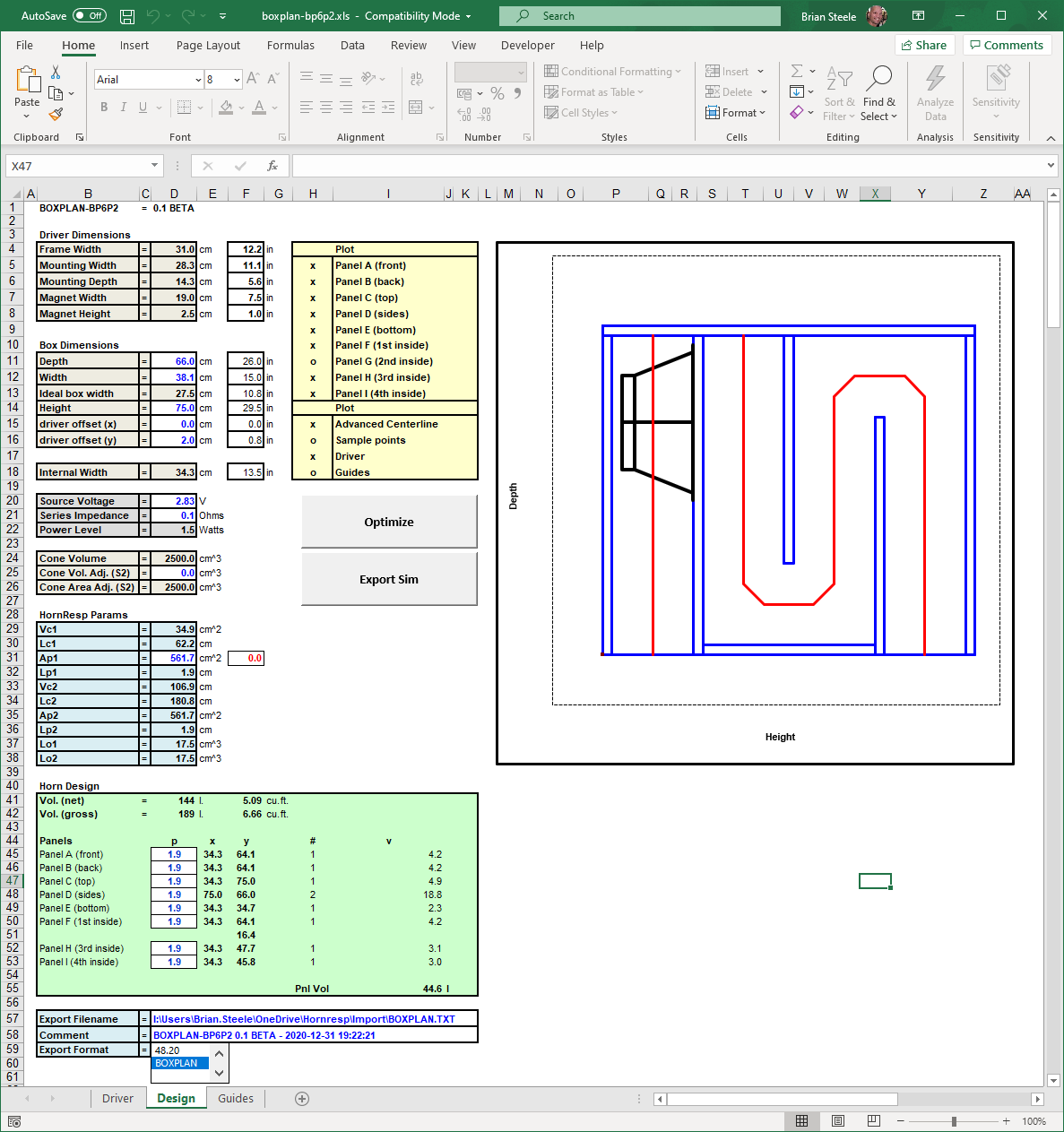

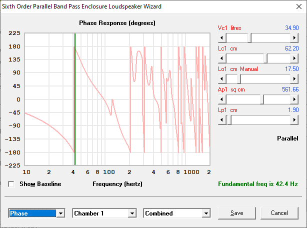

Well, that didn't take long. I've just uploaded another BOXPLAN that does a 6th order parallel bandpass sim based on a box design similar to one of the Paraflex designs. I opted to leave out the last bend in the rear path. The predicted results look very similar to what are being achieved with the Paraflex designs.
And along the way I found a possible way to improve the Paraflex design that looks similar to this layout. Something that would improve the phase response well up into the high midbass frequencies. All theoretical, of course....

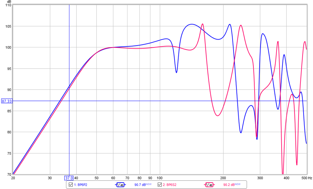

I like how that enclosure looks and the simplicity of the front and rear chambers are the 2 ports like a TH.
That 110hz notch, is that a summation artefact before the shorter path takes over? Nice work either way, doubt it will be noticable irl, I really like the simplicity, build coming up?

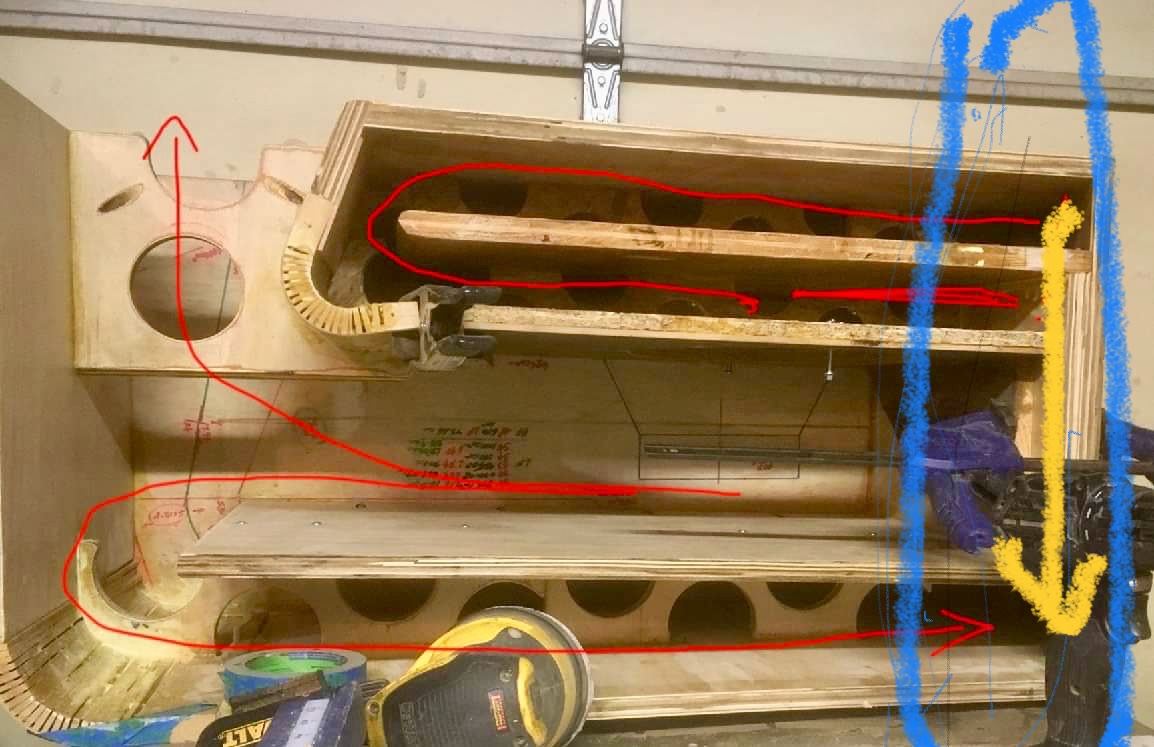

Failed to improve paraflex. That exact thing has been in my garage for almost a year. I really wish you would help people help, instead of blow torch your own path to guesses on your computer.
pOC used to be your teaching and learning machine. you need to build a paraflex from scratch before any more of this makes any less sense. Your onto the right idea, but you skip the reason along the way. People already know what are showing, plus MOAR. We just need you to show it. I dont think you realize this? Im sorry if i sound rude, but i cant help you pay attention. so do it on your own if you must. But you're gonna skip

...and here's how they compare - similar box sizes, but entirely different shapes, to get an Fb around 42 Hz. The BP6P box is slightly larger, by about 20 L.

Sorry, but that is wrong and i dont think you realize why? Fold it at harmonics. for once. Pretend the sim
Is missing the fold. Because it is. Now tell us the ‘fake’ results... and ask if its real. It is. Build it as a POC and you get most of what im
Saying. Please listen it will not disappoint. If you want sciense, here it is.
My ‘roar/paraflex’ is not the loudest, nor the ‘best’ but it is perfecty in phase for what it is and its aligned out to ten times the fb minus the interval of the ‘HF’ chamber over and over.

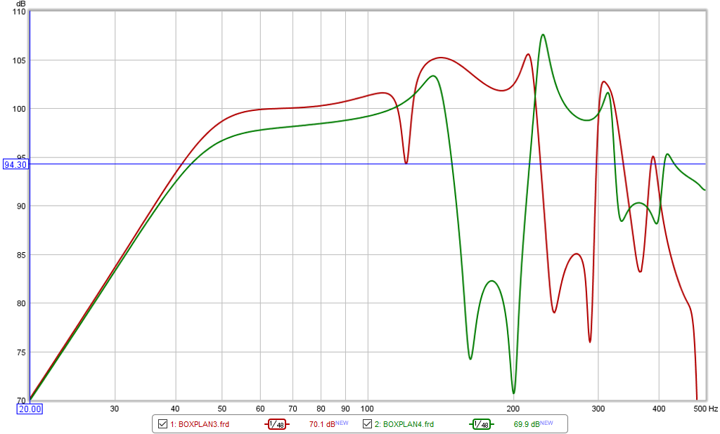

The situation is a bit more complicated than that, as both paths are contributing to the response above 100 Hz (see attached image, showing the output from each vent - the output from the rear path is highlighted in yellow and the output from the front path is highlighted in blue). It should be possible to tweak the design to get rid of the minor notch (some experimenting with adding a stub at the start of the rear path seems to produce this result).
Yes, box losses will make the notch a lot less noticeable. And bear in mind that the sim does not take into consideration Vtc, Atc, bracing, box losses or the impact of the driver's chassis sitting in the front path.
I'm not sure that I will eventually build this though - the requred shape of the box makes it a bit more difficult to transport, particularly in my vehicle, whose trunk favours long rectangular boxes rather than squat and square ones of the same volume.
...and here's what the response of the equivalent offset TL looks like (i.e. if you remove the front path). There is a general 2dB increase in sensitivity across the passband. The box is just over 40% bigger however. Fb does shift up a little, I'm not sure why.
