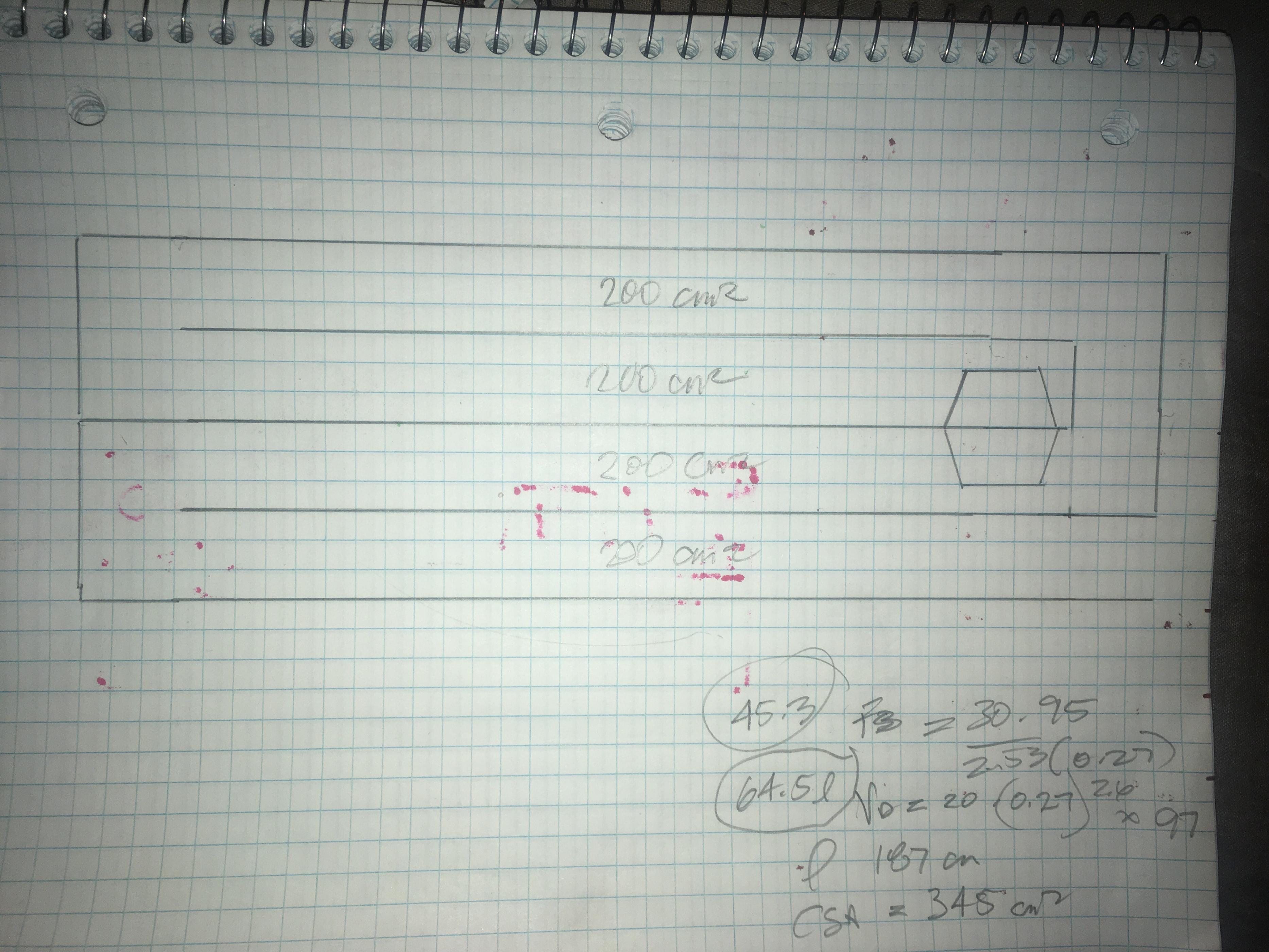

But dump the idea of flare and use segments as if they are predictable filters and split the 180 by the median between the two seperate CSA (an increase)segments. shoot it full Length for all folds as such. giving half to each and making this steps within reason to support the 1/3,2/3 rule of both harmonics and ‘flow’ in a manifold. . . an elipse is not a circle, and its the pattern of a spread in flow of particles as mass in a gas around a turn will show. theres a lot of things to ponder, but if the nulls are not in the turns, then flow through them is. if the idea is to create the best possible phase between the front and rear then the middle of that is going to suffer as well as the ends. Until We decide to create a double tapped split and fold, its offsets to buy back and cheat with.
The isobaric might seem funny, but it stirs up attention. even if its not preferred. its the rest that is important here. This split and fold is merely missing a csa to use in each segment and a driver to make happy. thatll never change, but what is phase at the exit of this two stage pipe if we want it to be something? Even hypothetically?
At some point we must ask ourselves if we are trying to make a nice box that's comvenient, or can we give into reality of sound a let that slip a bit to see? its really probably not as bad as we think. We just need to get over that hurdle to then shrink it back from there once we find what apparently we wont look at.

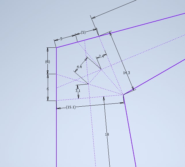

Basically at a fold, you draw a line that's orthogonal to the centerline from the focus of the fold to the other side. The the next sample point is located halfway between that pint and the farthest point of the bend.

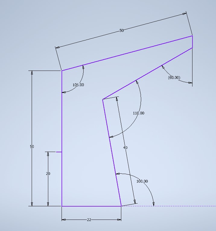

Brian,

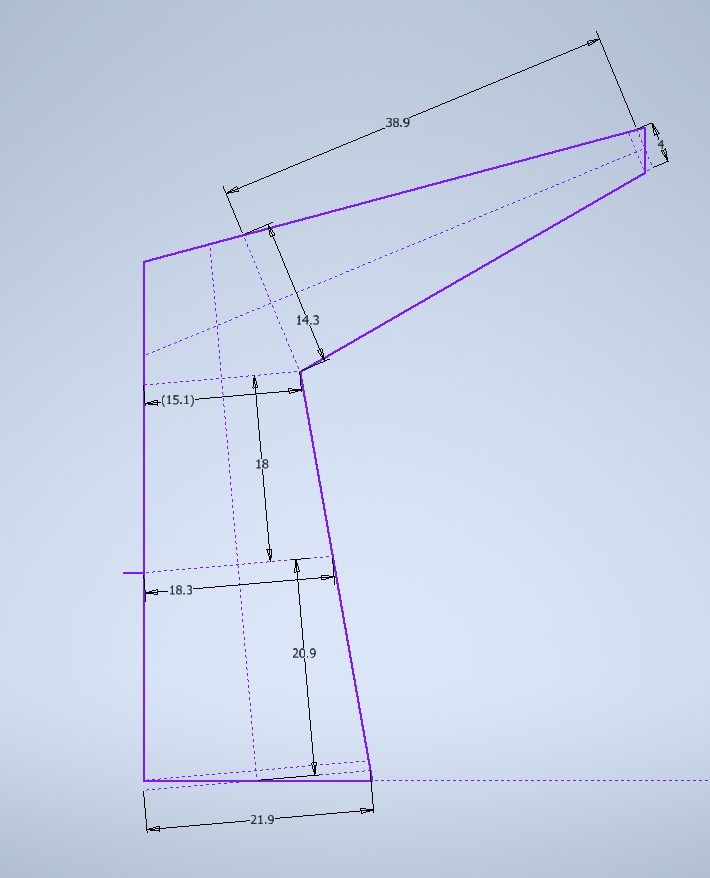

Thanks, but sadly I'm still not quite getting it. Maybe this example helps. The drawings attached show an arbitrary enclosure with a fold. The first drawing shows the internal box dimensions (in cm), with the closed end at the bottom, open end on the right, and the driver center at a point 20 cm above the bottom panel.
The second drawing shows my attempt (still incomplete) to derive the HR inputs by applying the advanced centerline method.
Assuming the enclosure is 10 cm wide, I get:
S1=219
S2=183
S3=151
S4=143
S5=40
L12=20.9
L23=18.0
L34=?
L45=38.9
Is this the correct application (so far) of the ACM?
If "No", what's wrong?
If "Yes", then how do I draw the additional construction lines to determine L34? Do they just go from the inner corner of the bend to the spot where the centerlines intersect the walls? Or do I trisect the angle between the two lines from which S3 and S4 are derived? Or some other method?
Thanks,
Eric

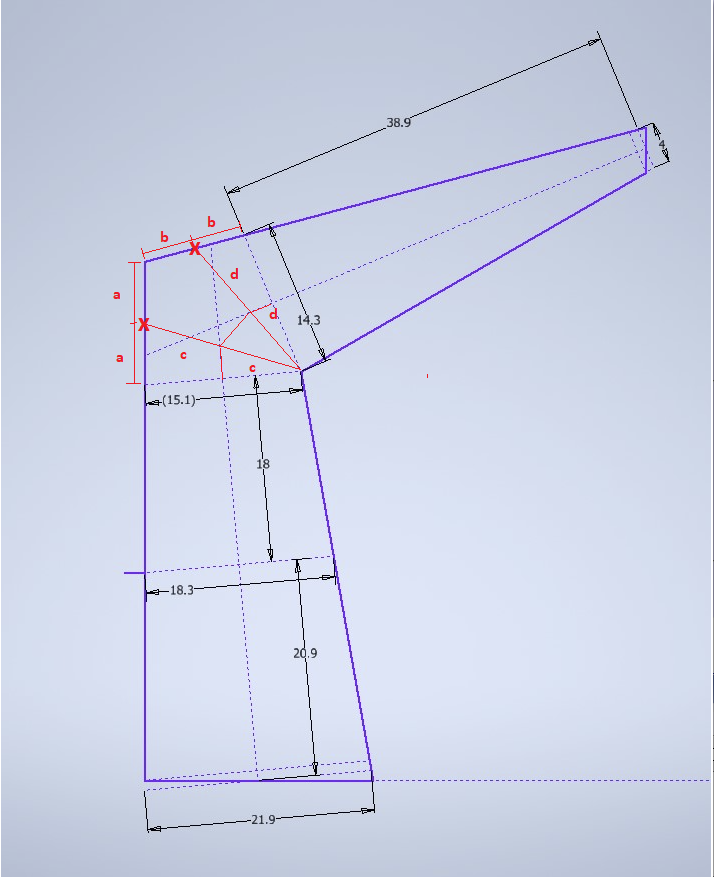

You're most of the way there already.
I've updated your second diagram to show how I define the path around the bend using the Advanced Centerline method. Note that this method should not be used to determine the VOLUME changes through the bend, only the best estimate of the path length through the bend. Volume estimates should only be based on sample lines that are orthogonal to the center line. The Advanced Centerline method assumes that the expansion uniformly increases or decreases through the bend.

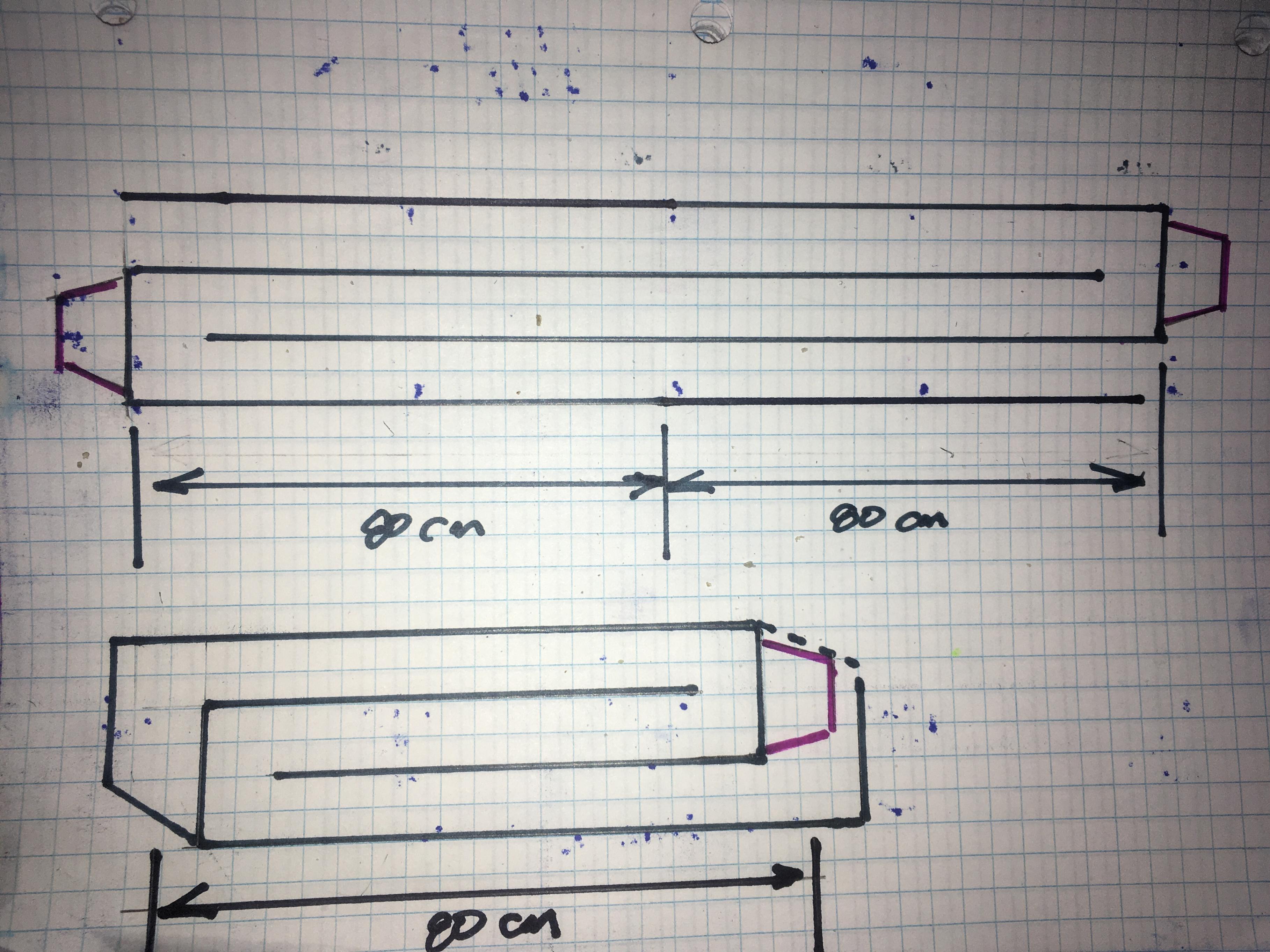

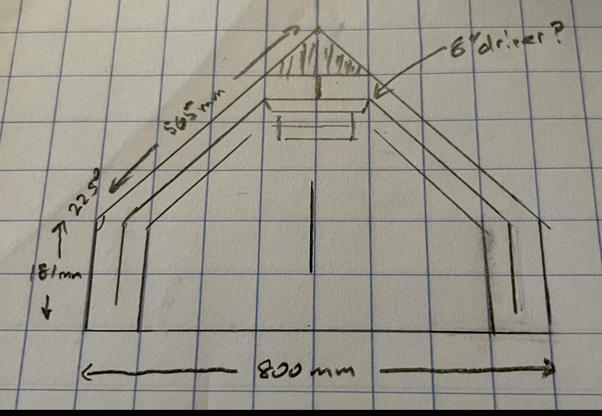

Two folds in 3 segments. But once crossing another path or parallel to one that is halved . The top sketch if ‘tapped’ might need to be folded in half again ‘after the tap? I cant see how this is wrong, and ive tried to mass load the end to see if a tapped horn with a huge mouth deviates. IT DOES! And it goes like a super MLTL, but with a horny gain?
